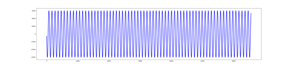

  • Can you also guide me on this.
    While capturing, I am using TSW14J56evm + ADS54J60evm (16 bit ADC).
    so, on HSDC it should be able to capture values from -2^16-1 to +2^16-1 (for 65536 samples).
    But I am just getting maximum value till 3000.
    Can you help me with it?
    Screenshot1.csv
  • Hi Raeleen,
    For a 16-bit ADC, codes will be in the range of -2^15+1 to 2^15-1.
    When I plot this data, I get the following. I do not see anything at a maximum until 3000. Could you perhaps rephrase this question for me?
