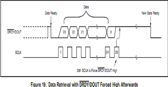

I'm working on my school project and I was wondering if I can get some help with my SPI code for the ADS1231? Im using the MSP430BT5190 microcontroller(the one included in EZ430 RF2560). The way the ADS1231 works is that it will pull its DRDY line low when it is ready to start shifting out data and it is at this time the serial clock is started. When 24 bits are shifted out, the DRDY goes back to high and, from my understanding, the Serial Clock stops. I have a diagram of how I plan on connecting the pins on my microcontroller to the ADS below as well. I plan on connecting both p3.0 and p3.2 to the DRDY/DATAOUT and the P3.3 to the SCLK. P3.0 will handle the DRDY signal and P3.2 will handle the SOMI. Anyway, I was wondering about a few details.
With the code that I have below, am I correctly stopping and starting the Serial clock? The Serial clocks should only be applied when DRDY is low so I  did this by stating if(!P3IN). It will turn on again when DRDY is high so if(P3IN). I stopped and started the SCLK by doing:  UCB0CTL1 &= ~UCSWRST;
Secondly, isn't there some conversion that I need to do so that the data that I'm getting is standardized? I remember dividing by the Vref...but I can' t seem to find this in the ADS1231 datasheet anywhere.

    I'm going to answer your second question first. One page 3 of the datasheet:
    Which shows that the input ranges +/- within the common-mode input range.  The codes read  back are binary twos complement and follow the table 3.
    So, now on to your code.  The basic structure is ok for the most part.  One thing though is that the SCLK works in bytes, so you really don't need the datacomplete stuff.  Just read three consecutive bytes, then wait for DRDY to go low again. Data1 should be shifted 16 instead of 8 and should be signed 32...or you need to account for the sign in some way.  If you use a signed 32 , you will need to make sure that you properly sign extend from 3 bytes to 4 bytes.  The end result can be changed from a code to a voltage using the LSB size  of one code multiplied by the result.
    Once you think you have things working, you really need to verify that what you think is happening truly is and you do this by hooking things up to an o-scope.  Measure the results from the scope and compare it to the readings you get from the micro.

  • Thanks Bob for the fast answer! But I have a few questions about the code. I see what you're saying about shifting it by 16(otherwise data1 will get erased by data2) and declaring it as a signed int(since it is in binary 2's). I went ahead and updated by code based on your advice (shifted data1 by 16, changed data1 to a long int, and added the part about sign extension). However, I'm not sure why I need to sign extend it to 4 bytes? Is it just to fill in the 24-32nd bits?
    Also, Im still unsure about the SCLK. I thought I was suppose to stop the SCLK based on Figure 19 in the ads1231 datasheet? What I got from the datasheet is that I was suppose to apply the 25th SCLK and then stop the SCLK from running. So what you're saying it that I can leave the SCLK running even when DRDY is high?

  • Wesley,
    On our EVM, ADS1231REF, I use an interrupt driven system and not a polling method, so I guess I wasn't quite thinking in the same terms.  I parallel the DOUT/DRDY signal to another  pin and I set the interrupt to trigger on the high to low transition.  Within the interrupt, I first disable the interrupt, then read 3 bytes and then re-enable the interrupt.  I always know when the read is taking place.  Using the polling method at a slow sampling rate works, but you never really know for sure when the read is taking place.  It is quite possible to get corrupted data if it is not read out fast enough.
    So yes, you really should force the DRDY high if you poll.  If you use the SPI peripheral it will clock in groups of 8 clocks representing one byte, to get the 25th clock you would basically need to read a dummy byte.  This will result in a total of 32 clocks.  The part has not been tested, to my knowledge, driving it with extended clocks.  I will have to test this when I can, and if I have a problem with this I will let you know.  Otherwise you will have to bit-bang the SPI and that is a hand coded process and you will not be able to use the built in USCI peripheral.
    As far as the sign-extension, I've never heard of a signed 24-bit number.  You can have three bytes of data, but to manipulate it as a number it needs to be a signed 32 bit value (signed long.)

  • Oh ok, my sample rate is low (SPR=10 sps) so i guess i was doing the polling method with my original code. I was trying to stop the SCLK's after the 25th one. That's what the dataComplete was for. Here is how my code works:
     while(1)
       if(P3IN && dataComplete){                    //the code should go into this for loop at the 25th SCLK and then stop the  SCLK
         UCB0CTL1 &= ~UCSWRST;             //stop the serial clock
         dataComplete = false;
       if(!P3IN){
    UCB0CTL1 &= ~UCSWRST;       //start the serial clock
    //Code to get the 24 bits of data from ADC and sign extend as well
       dataComplete = true;                //makes sure that it only stops the SCLK once by only going inside the if statement once
    I intend to only go into if(P3IN && dataComplete) statement only once, that is right after the the msp430 gets the 24 bits of data. Hopefully, by that time the 25th SCLK has been applied. Then when P3IN goes low again, I go into if(!P3IN) and start the SCLK up by saying UCB0CTL1 &= ~UCSWRST;   . The only thing I'm worried about is that by resetting the UCWRST I'm resetting more parameters than I need to and, thus, my SPI will somehow mess up.
  • Wesley,
    There is no need to start and stop the SCLK.  Start the SCLK as part of the peripheral.  When you poll the input and it goes low, just read 4 bytes.  The first three bytes read is your ADC value.  The fourth sets SCLK high.  It is really just that simple.  There is absolutely no need for datacomplete.
    Bob B
