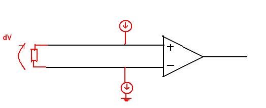

    I understand how the lead-off detection would work if you attach electrodes to both inputs of one of the inamps. Then it would look like this:

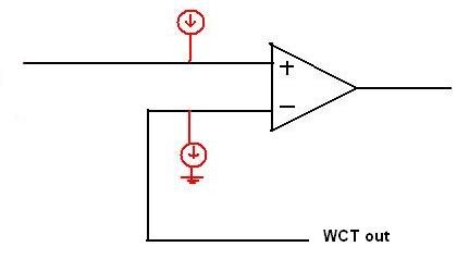

    What I don't understand, is how it would work, when you would use a WCT or RLD. Because then it would like this:
    Do you see my question? Where is the current going?!
    I know it has to be working, because the EVM is using WCT and it is also doing DC lead-off detection. I just don't see how?

  • Hi Pieter,
    The more questions that you ask, the better as I am in the process of writing a lead off detect app note explaining how it works. Take a look at this regarding the lead off with the RLD -
    http://e2e.ti.com/support/data_converters/precision_data_converters/f/73/p/124924/447760.aspx#447760
    I am not sure how you are doing WCT lead off detection. The WCT output is routed back around into the input of the ADC.Therefore, there is no reason to do lead off detection with the WCT.
    If in the pictures above you are trying to show the amplifier as the internal PGA of the ADC, then with DC lead off detection, the only current source that is turned on is for the (+) input. You do not turn on the lead off LOFF bit for the (-) terminal. The current from the (+) input is sunk through the body to create a voltage which is compared to a threshold using a comparator running parallel to the internal PGA.
    Tony

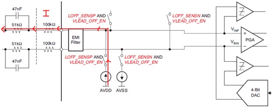

    I asked where the current was going in the picture. The amplifiers indeed represent the PGA's. I'll try to rephrase my question :). Let's say I have the following setup.(This is an extract from figure 59 on page 63.)
    Now I want to know whether electorde IN-P is connected or not. Using DC lead-off detection, the datasheet says a current will flow through the electrode, through the patients body, coming from AVDD. But here's my question then. Current can only flow in a closed loop. Where does the current go, once it has reached the patients body?! [QUESTION 1]
    You said: "The current from the (+) input is sunk through the body." But where to?
    Here's another question. In my understanding the detection works by measuring the voltage drop on IN*P, caused by the current going trough the resistor. I don't see how this can be done without interfering with the measurement of the actual input signal. If you put a current of 6nA through those 150kOhms, you get an extra 9mV on the positive input of the PGA. And if you only do lead-off detection on the positive electrode, and not on the negative electrode, these 9mv are not neutralised, and the AD convertor measures an extra Voltage [9mV multiplied with the gain]. At least, that's the way I see it. [QUESTION 2]
    Maybe it happens between two measurements or something? So the AD never actually sees the extra voltage? [QUESTION 3]

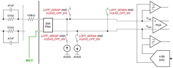

    About the WCT, I wasn't interested in lead-off measurement of the wct signal. I wanted to measure lead-off for the positive electrode, while routing the WCT signal to the negative input of the PGA. Because this is what my setup is going to look like. Like this:
    I first thought, the current would come out of AVDD, go through the positive electrode, onto the patient, and then come back through the negative electrode and into AVSS. That's why I didn't understand, how it would work while using WCT, because then there wouldn't be a negative electrode, to allow the current to come back. So how does it work then? [QUESTION 4]
    I think without understanding this, it's not possible to choose how you're going to set up your inputs and how your going to route WCT and/or RLD. And without this setup, you can't move on with your design.

  • Hi Pieter,
    Thank you for the description and diagram, this has been very helpful to me. I now understand the confusion and what aspects of lead off detect need to be better explained -
    You are right that there needs to be a path to the ground of the chip in order to complete the loop for lead off detect. For that reason, you need to have the RLD connected in order to both set the DC operating point for the body and provide a route to ground for the current to flow. The RLD line has a driving amplifier which is capable of sinking the current to ground.
    You should notice that if you try to use DC lead off and disconnect the RLD electrode, the lead off results may begin to read back incorrectly. In this case, depending on the configuration of the electrodes and chip, the currents may try and find their way back to 'complete the loop' through leakage paths at the individual PGA inputs and capacitive leakage paths throughout.
    The detection method works as you have explained where you are sending a small current across a resistance to create a voltage. With the 6nA current through a 150k impedance you will get an extra 9mV offset error. This offset error is very minor when you consider the fact that the offset error of a typical electrode could be somewhere around 300mV.
