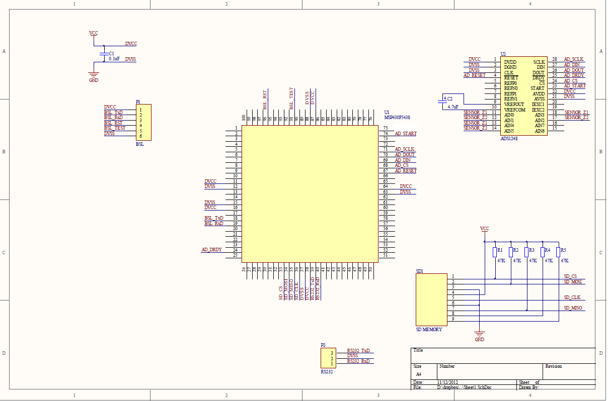

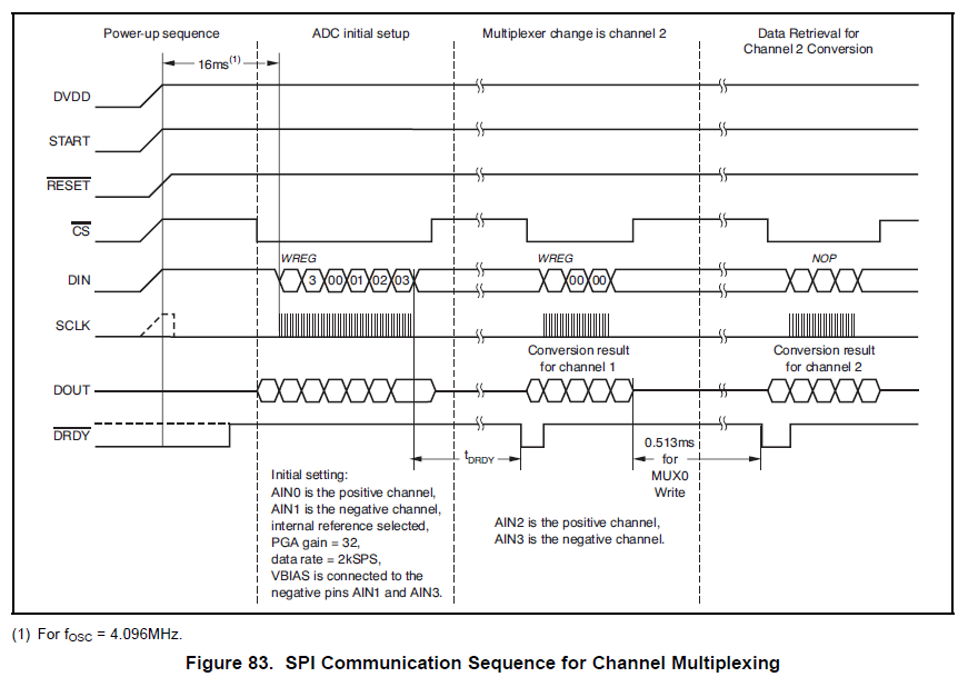

Hello, I'm trying to run an ADS1248 following the example on page 55 of the device datasheet. The only difference is that I'm doing it with 3 channels. I'm trying to do this with a MSP430F5438. I attach a picture with the schematic. I know that it isn't a hardware problem, because I run it with different configurations, but this is the configuration I need for my application.
First of all, I make the initialization of the MSP, initializing the  LFXT1 at 8MHz and the series port. Then I start my code following the Figure 83 of the ADS1248 datasheet (Figure 83. SPI Communication Sequence for Channel Multiplexing).
I'm going to explain my code, because I think that I'm making a mistake in the process.
First off all, I make an initialization of the SPI that communicates with the AD. I put a frequency of 1MHz. I also configure the port P1,7 as a  Lo/Hi interrupt. I put the Sart, Cs and Reset pins at high value (CS and reset are active at low state, so I put a 0 on them). Then I make a delay of 2^16 cycles and then I put the CS on low state.
After this, I start the configuration of the registers of the AD.
First of all, I send the WREG command, 0100 0000 indicating that the address of the first register to read is 0. Then I read and discard the answer of the AD. Then I send an 0B, indicating that I'm going to write in 12 registers. I continue sending the values of the registers and reading the answer of the AD. When this finishes I put the CS to high state.
Then in the main program I wait until DRDY goes from Lo/Hi, when this happens I put the CS to low state and I start reading and discarding the first value. Then I send WREG in order to indicate that I want to change the channel I'm using . I use the first to sends to send the WREG values. Meanwhile I save the first two values of the conversion (MSB and the middle value). Then I send the value of the following channel (If I had read CH0, now I say that I want CH1, if I'm in CH1, I say CH2, and if I'm in CH2 I return to CH0). After saing the value of the register MUX0 I read the LSB of the conversion. Then I put the CS to high state and I returnto wait the DRDY signal.
Sorry if there is any spelling mistake. Can somebody help me with this? If it is necessary I can put my code here.
Also a Code of the implementation on this diagram with some MSP can be very helpful for my project.
Best regards.
  • Hi Santiago,
    It would be helpful to look at your code. Below is pseudo code describing how I would accomplish what you're trying to do. Below I'm assuming you're writting full duplex; writing registers while reading results. I'm also going to use the RDATAC command, which automatically loads a completed result to the output shift register on the falling edge of each DRDYn. I wasn't able to immediately discern what problem you're seeing, but one thing that I did not notice was the inclusion of the RDATA or RDATAC command. These commands are used to configure the output shift register to load the result. Without issuing one or the other of these commands, you wont be able to read conversion data from the ADS1248.
    Power Up:
    START: 1
    RESETn: 1
    CSn: 1
    DIN: 1
    SCLK: 0
    Wait 2^16clk (16ms for internal oscillator)
    Issue RDATAC command to allow results to load into output register:
    START: 1
    RESETn: 1
    CSn: 0
    SCLK: X
    DIN: 14h //Can be idled high or low if using dedicated DRDY pin
    DOUT: Ignore
    Configure channel CH0 AIN0:AIN1: // Can immediately follow the RDATAC command without needing to frame CSn
    START: 1
    RESETn: 1
    CSn: 0
    SCLK: X
    DIN: 40h 0Bh 01h XXh XXh XXh XXh XXh XXh XXh XXh XXh XXh XXh
    DOUT: Ignore
    Raise CSn at end if needed
    Wait for falling edge of DRDYn
    Configure channel CH1 AIN2:AIN3 and read CH0 data:
    START: 1
    RESETn: 1
    CSn: 0
    SCLK: X
    DIN: 40h 0Bh 13h XXh XXh XXh XXh XXh XXh XXh XXh XXh XXh XXh
    DOUT: XXh(MSB) XXh XXh(LSB) //Results from CH0 reading. Can be read at the same time 40h 0Bh 13h are written (full duplex).
    Configure channel CH2 AIN4:AIN5 and read CH1 data:
    START: 1
    RESETn: 1
    CSn: 0
    SCLK: X
    DIN: 40h 0Bh 25h XXh XXh XXh XXh XXh XXh XXh XXh XXh XXh XXh
    DOUT: XXh(MSB) XXh XXh(LSB) //Results from CH1 reading. Can be read at the same time 40h 0Bh 25h are written (full duplex).
    Configure channel CH0 AIN0:AIN1 and read CH2 data:
    START: 1
    RESETn: 1
    CSn: 0
    SCLK: X
    DOUT: XXh(MSB) XXh XXh(LSB) //Results from CH2 reading. Can be read at the same time 40h 0Bh 01h are written (full duplex).
    Repeat Configure channel CH1 AIN2:AIN3 and read CH0 data step

  • Santi,
    I noticed on line 238 of your c-code you write the following:
    UCB2TXBUF = 0x40; //WREG 2 (0x00 -> el 0 corresponde a que se escribirá 1 byte -1)
    You wrote 0x00 in your comments, which is correct. The 0x40 will keep the ADC from writing to the MUX0 register. It's actually setting the internal state machine back to the WREG command so the next command UCB2TXBUF = channel[i] is actually telling the ADS1248 how many registers to write to.
    I didn't notice any other errors in your communication with the ADS1248. Are you getting any DRDYn pulses out of the device? A quick way to check would be to grab an oscilloscope and trigger on the DRDYn pin to see if you're issuing the commands. If the pulses are spaced 63ms apart then you've initialized  the device correctly.
    Mike

  • Santiago,
    As there is only one ADC, you will have to split the data rate by the number of channels being measured.  There may be additional time required based on the actual time it takes to switch the mux and reset of the digital filter.  For three channels at 160sps, your effective sampling per channel is about 50Hz.
    The nominal frequency is 4.096MHz, and the maximum clock that can be applied to the ADS1248 is 4.5MHz (so you can't use 20MHz.)  Increasing the fclk will shorten the time between DRDY pulses, or another way to look at it is the data rate increases.  Table 16 of the datasheet shows the number of clock cycles per data rate.  For 160sps nominal the actual time for a 4.096MHz clock is actually 160.602sps.  It changes to 176.443sps for 4.5MHz.
    Bob B
