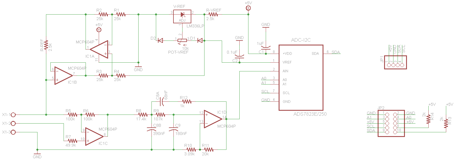

I am getting a weird behavior from reading the ADS 7823. Instead of returning the value on a a read it gives back its own address in the first byte and 11111111 for the remaining 7 bytes.
The circuit is on a fab'd PCB that I designed. The supply is +5V for the whole circuit. I connect to the board with a PIC and trying to read in 4 samples as the ADS 7823 supplies over I2C. I have 2k ohm pull-up resistors on each SDA and SLC lines. It takes a 3 wire RTD, converts it to voltage, amplifies it to a 0-2.5V scale and hands that to the ADS 7823 analog input. The reference voltage is supplied by a tuned lm336-2.5. I have two boards constructed so far and tested. I incorporated test points and all my analog signals are fine: steady and accurate.
On the first board I have never seen a good value come through. All I get is address back as mentioned before. I tried changing the address from both to ground to both to supply and it didn't report anything back. I haven't tried that board since. I had solder bridging the ADC's pins 5-8 when I first reflowed it, so I used an iron and wicked it away. I tried a second PIC and had the same issue.  I thought I may have overheated it and tried the second board I built.
The second board had one bridge between v-ref and v-in that I quickly wicked away. This board actually reported back values on all 4 sample per read at first for at least 40 reads. I tried it again later and it didn't work. It started doing the same thing as the other: giving back its address and 7 maxed bytes.
I don't have a scope which makes this a pain. I checked continuity before and after soldering. All the voltages are right. The program is simple, writes the address, writes the command, reads in 8 bytes, serial out to my PC and loops. I am at a loss for what is wrong.

    - What voltages are you applying at X1-1 and X1-2?
    - What SCL frequency are you using? Are you using I2C in HS mode? (as described in fig. 4)
    - Can you please send me your source code showing how you initiate an ADC conversion and read back the results?
    Also, can you try decreasing the ADC's supply voltage to 3.5V and let me know if your results change?

  • X1-1 provides 100 ohms at 0C and about 140 ohms at 100C. When I ran it the value was around 108 ohms. There is 1mV coming across Rref. X1-2 is used to measure resistance against to correct for distance errors (lines are the same length). The output at pin 8 of IC1C is 1mV per 1ohm from the sensor: 108 mV when I tested it.
    I ran this at both slow and fast: 100kHz and 400kHz respectively. I have tried so many combinations since it failed that I don't recall what speed it was set to when it worked, but I believe it was at 400kHz.

    Sorry I couldn't respond earlier. I've been trying to eliminate possible design issues with your analog input circuitry that could cause the issue you are observing.
    My first suspicion is that your VREF input is not stable during ADC conversion. The load current drawn by the ADC from the reference input fluctuates greatly (datasheet specifies 9uA average over 8uS conversion period) and quickly as the ADC performs a conversion. Really the only way to meet these large load current demands quickly is to place a large capacitor on the VREF input close to the chip. Your circuit has C2 = 0.1uF to serve this purpose, which should technically keep VREF stable enough (limit the variation to <750uV or about 1.3LSB). However, could you please probe the VREF input of the ADC with a multimeter while the ADC is converting and let me know how much variation you are seeing? You can also try increasing C2 to 0.47uF.
    Also, attached is a DC simulation of the input circuit. I have used a 108ohm RTD resistance and an ideal 2.5V source in place of your reference source. Can you please verify that you are measuring all the same values on your board?

  • My multimeter only goes down to 1mV resolution at 2.5V, but I have noticed a possible swing. Occasionally, I do see a 1mV drop around conversion. I have a 0.47uF cap on order to try it out.
    As for the values in your drawing, mine are right in line. At time of testing my RT resistance was a bit higher, but all values scaled were within 0.013 std dev.

  • Update:
    I have 0.47uF caps on order, but they haven't arrived, yet. I realized I had a spare 0.39uF on hand and tried that in place of the 0.1uF at C2. It seemed to do the trick and I am getting output from the ADC now using the PIC. Very smooth, no erratic readings at all. I will switch out the remaining C2 caps on the rest of my boards when the new caps arrive.
