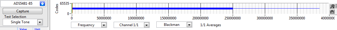

    • Also, it seems like the TSW1400 is transferring data to the computer extremely slowly. I've captured ~17.476 seconds of data at 30MSps (=500Mebi samples).
      If the GUI continues at the current speed, it will take ~1 hour to transfer the data to the computer. Is this normal?
      That speed works out to only ~340kBps.
      -David
      Edit: Now it seems like there is some weirdness with the data now that (most of it) is in the computer. Seems to be "flat lining" after 250 million samples:
      Also, my screencap "so happened" to capture this in the bottom status bar:
      Edit 2: Fixed images.

      I set up the ADS548x EVM again and set it for max capture depth.  1) it does take nearly an hour on my laptop to download the entire 1GByte of data.  On the FTDI4232 we are using all four ports of the device for one thing or another.  One port is just for writing register-mapped commands to the FPGA to set up for a capture.  Another is used for pushing the bit file into the FPGA.  Two of the ports on the FT device have hardware assist for SPI accesses and we *are* using these two ports in tandem to move the captured data from the FPGA up to the PC.  Yet a full capture buffer takes about an hour to upload.  It was about half that time in early development of the GUI, but I am told we cut the speed of the SPI accesses between the FT4232 and FPGA to 15MHz based on a max speed recommendation from FTDI.   (Most of our work with the capture card has been doing FFT analysis on 64Ksample captures, which takes only a second or so.)
      Finally, on a capture of 536870912 samples (1/2 GByte) i also saw only the first 268435456 samples (1/4 GByte) be valid.  When I look into the ini file for that device I see a line entry that tells the GUI that every other sample in memory is valid and every other sample is discarded.  So when the firmware was written, the author of the firmware was wasteful of memory for this data format and only used half of the available DDR memory.  So a practical limit on capture depth for this EVM is 1/4GSample without a firmware re-write.

      Thanks for your detailed response. I'm guessing the memory utilization is an artifact of creating the "ADC_BYTE_WISE_1CH" firmware by doing some quick modifications to the "ADC_BYTE_WISE_2CH." As a result, using a single channel ADC only lets you utilize half of the on-board RAM. I see what you're saying about the the ini file: "Channel Pattern=1,0" equates to throwing away every other sample.
      Also, I think there might be a mistake in your numbers. Below is my proposed correction:
      (Note: I'm using/abusing the IEC standard for binary prefixes... Gi (gibi-) means 2^30.)
      I think you are saying that you tried a capture of 536870912 samples (1GiB, 0.5GiSample) and only saw the first 268435456 samples (0.5GiB, 0.25GiSample) to be valid.
      As you (correctly) stated, it seems the max capture depth is 0.25GiSample.
      Thanks for all your help...
      I can live with the 0.25GiSample/~30 minute transfer for my testing; thanks for clearing up the limitations there.
