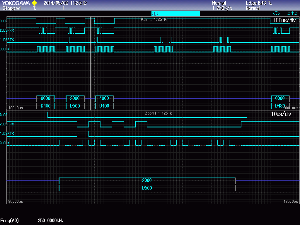

    The interface timing does look clean.
    In the screenshots, you have zoomed into the A000 write access, rather than the data read access. Is it reasonable to assume that the number of clocks and other timing parameters are similar in these transactions as well?

  • Here's a screen shot with a zoom into a read access. The voltage is nominally 2.5V. Notice there is some activity on the SPI where the ADC CS is not low. This is because the SPI is shared with a couple DAC chips.

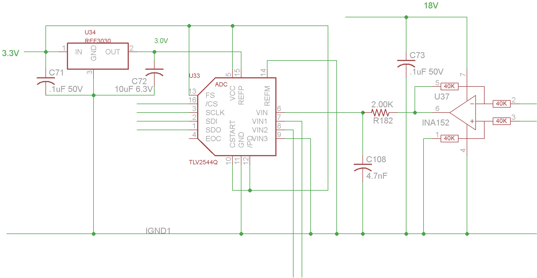

    Here's the relevant portion of the schematic. The circuitry driving A0, A1 and A2 are the same. Only one is shown.

    You mentioned multiple devices on the SPI bus. Do we have an estimate of the capacitive load driven by the ADC on SDO? This can impact on the delay to SDO valid (tSCLK-DOV in the datasheet). But this is less likely to be the source of the problem, since you have tested at much lower speeds.
    Is there are buffer between the ADC and the DSP? If yes, on which side of the buffer are the SCLK and SDO probed?
    Looking at the table of transactions in your earlier mail, the absolute numbers for the low voltage case are actually worse than the high voltage case.
    - 0.1V should give a code of 0.1/3*4096=0x088 and the 0x2AB code you are getting would correspond to a ~0.5V input.
    - 2.5V should generate code 0xD55, which is close to what you have got.
    This does show up like a gain error in your system. What is the nature of the signal at the input of the amplifier? What kind of sensor/stimulus is it connected to?
    Could we try feeding a few DC voltages (say 0.5V, 1V, 2V, 2.5V) and noting down the ADC codes to figure out the transfer function we are seeing? It would help to observe the voltages at REFP and VIN pins of the ADC on a oscilloscope when doing the measurements to look for spikes.
    Sandeep

  • Sandeep,
    My coworker traced the problem to poor voltage regulation on the REFP pin. He fixed that and the ADC is now providing full 12 bit resolution.
    Karl
  • Karl,
    I am glad to hear that you were able to address the problem you were facing.
    I did suspect reference, which is why I requested that you monitor the REFP during conversions, but your schematic looks correct. You probably have an issue with the layout - placement or the routing between the reference IC and the ADC. Just to satisfy my curiosity, could you please let me know if you have the root cause for the poor regulation? Thanks.
    Good luck with your design.
    Sandeep
  • The voltage reference supplying REFP requires 10uF on its output but it had 0.1uF. Changing it to 10uF corrected the problem.
