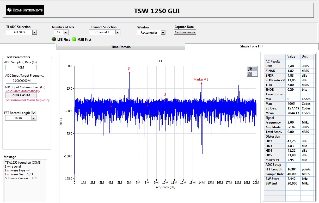

  • Hello, where can I buy the power supply? I did not find it the module package... Can I buy it from TI's online store? Thank you!!
  • I'm with the same problem (my capture are getting just noise). After so many time did anyone solve this?
    Thank you

    could you post a noise plot? are they random noise around DC or others?
    Thanks!
  • To get this signal above I used a 2MHz sine wave, 100mVpp.
