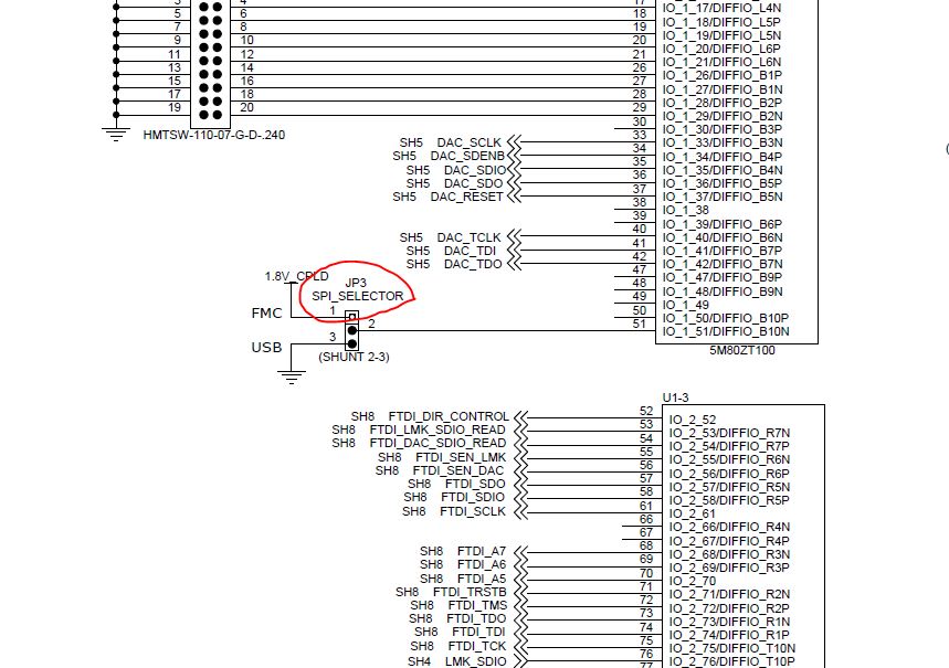

    However, I am just wondering the purpose of SPI_SELECTOR on the DAC schematic
    I thought I can use SPI directly for register setting because schematic mentions about SPI_selector.

    I got confused between DAC and ADC. I just checked out the existence of SPI on schematic. However, it wasn't on the schematic.

  • Hi, Inhwan;
    The SPI selector is used to select whether the SPI host comes from FPGA through FMSC or from GUI through USB.
    Thanks a lot!
