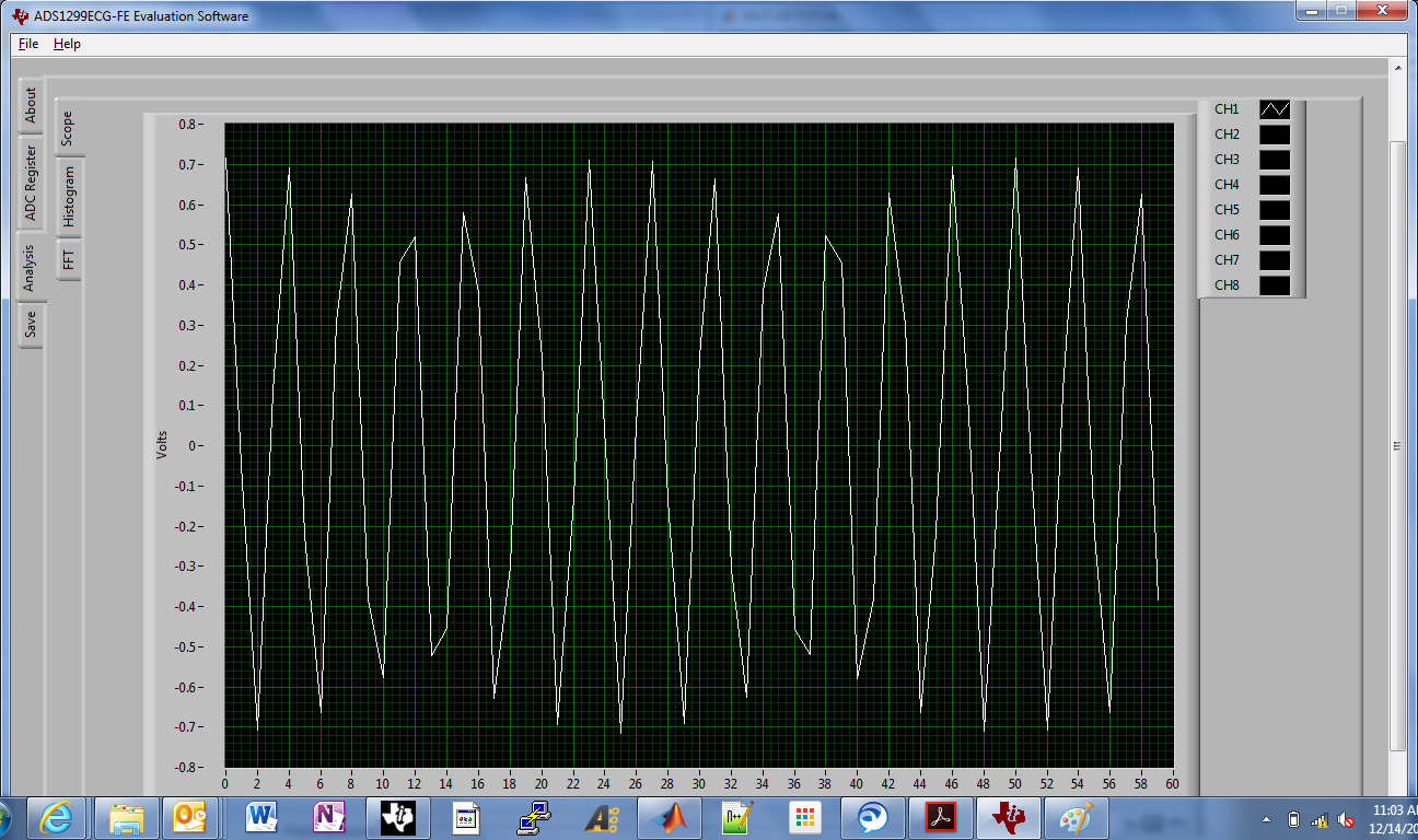

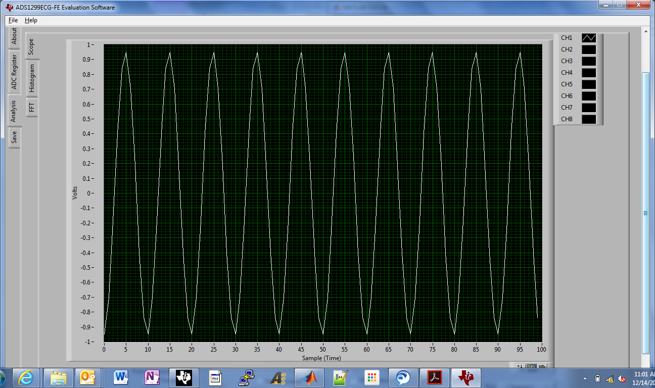

    I got the data. The manual collection file looks very similar to the automated one from before. I was looking more for just some data that you collected manually changing the input frequency on your signal generator and then just writing down the output magnitude. In any case, I collected data with the ADS1299 EVM, the schematic for which you can find on the web, but trust in knowing it is very similar to yours. I collected "single-ended" data where I enabled the BIAS amplifier as a simple buffer set to mid-supply, and connected IN1N and the signal generator ground to that net. I then applied the signal generator positive output to IN1P an collected data with the EVM GUI.
    The first signal I applied was a 1 Vp 50 Hz sine wave using the 500 SPS data rate. The image is below. As you can see, attenuation is minimal as expected. Certainly nowhere near the 0.707 V which corresponds to a -3 dB attenuation.
    Next, I applied at 1 Vp 130 Hz sine wave while still collecting at 500 SPS. This time the signal is modulated a little bit in the utility frequency (60 Hz, likely from fluorescent lighting), but you can see that the signal attenuates to near the -3 dB point. That image is below.

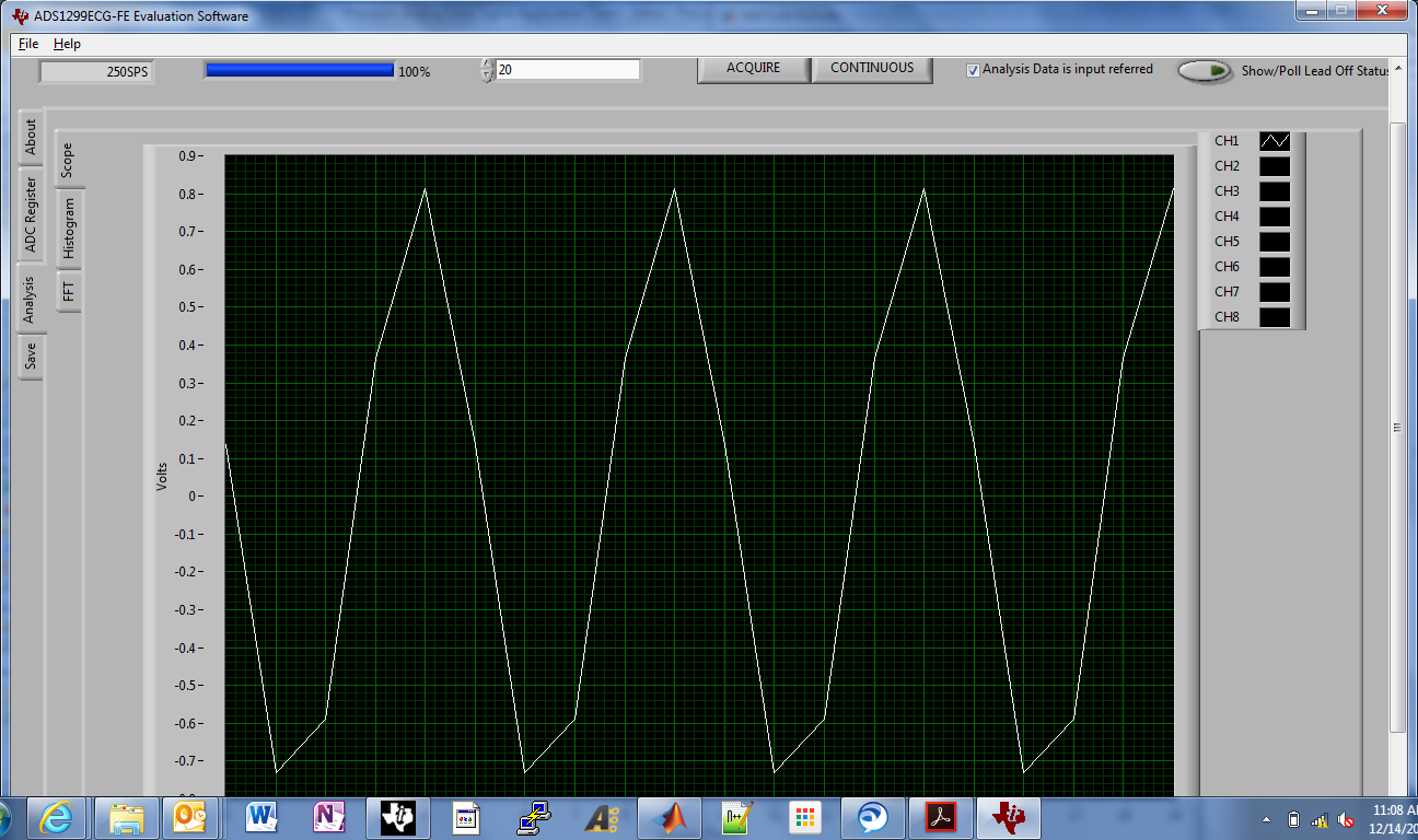

    Out of curiosity, I switched the data rate to 250 SPS and again applied a 1 Vp 50 Hz signal. I saw a significant amount of attenuation; very close to the -3 dB point for the input sine wave. The image is below. Are you certain that you have changed the data rate in the CONFIG1 register? What happens when you read it back? Have you seen the time between DRDY signals by looking at them with an oscilloscope?
