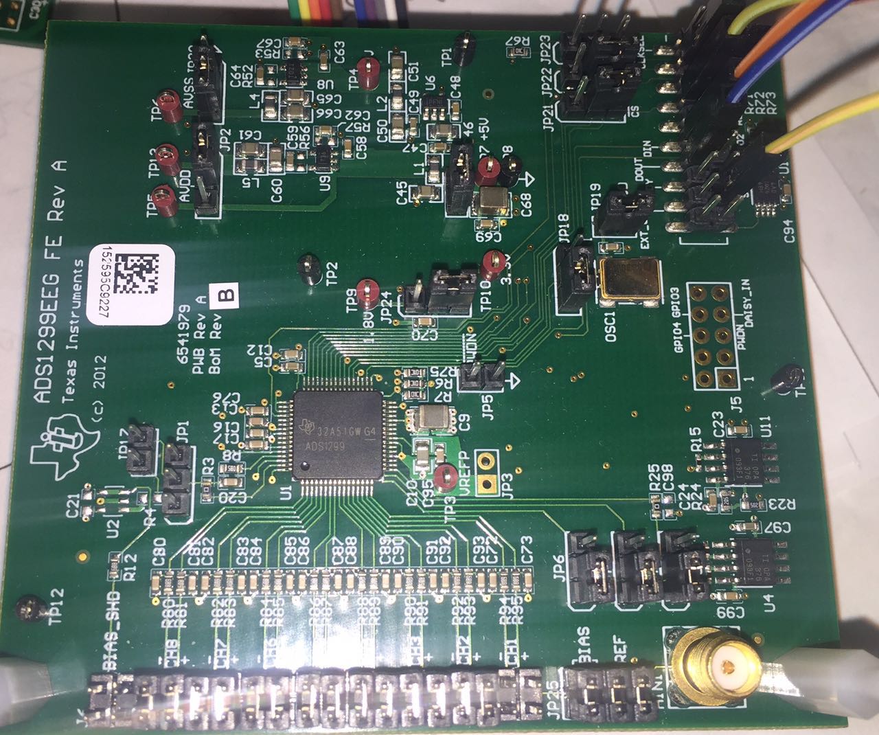

I am new to the forum and embedded systems, please bare with my newbie question. I am using the ADS1299EEG-FE demonstration kit daughter board (i.e. only the upper board), and wire out its SPI pins (SCLK, /CL, DIN, DOUT, RESET) to connect to a CC2540 development board (CS: P1.2, SCLK:P1.3, MISO P1.4, MOSI P1.5, RESET to VCC, CLKSEL to VCC).

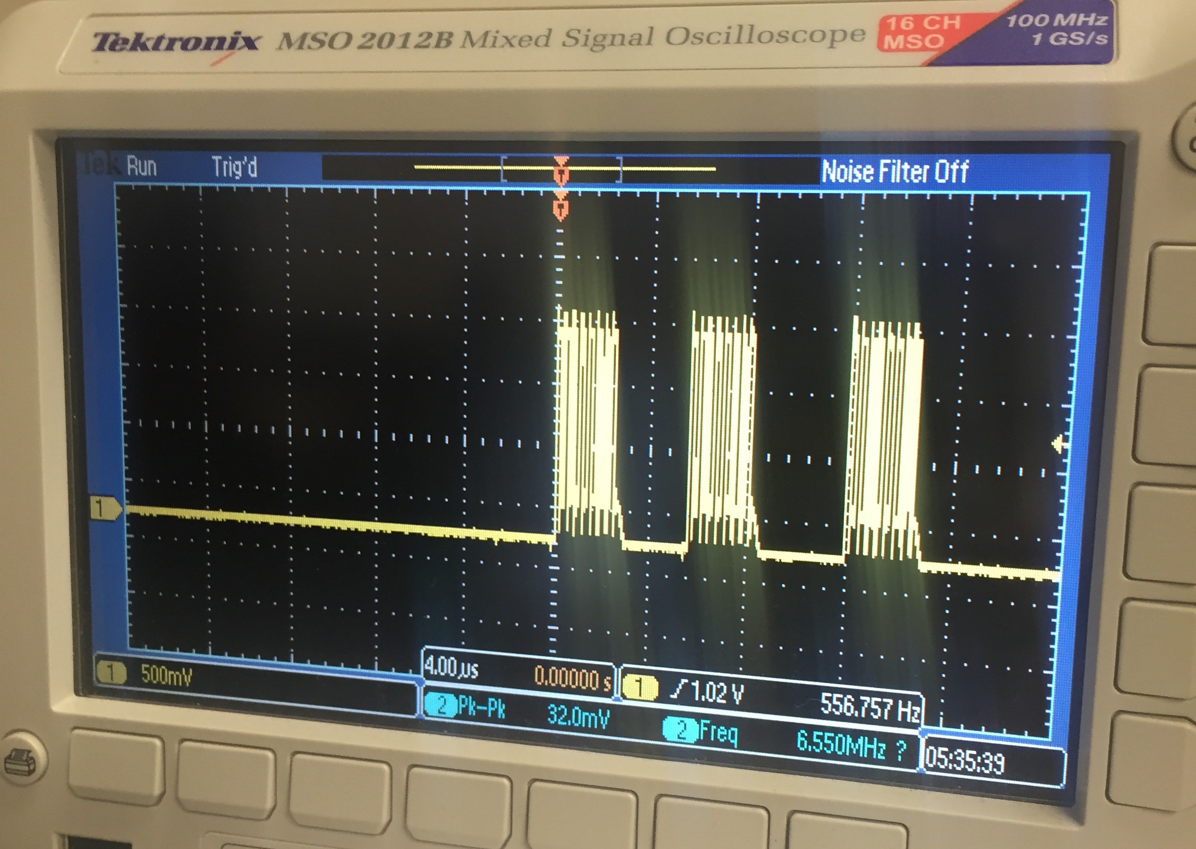

However, I couldn't get any value from "test", and of course I didn't get correct DOUT signal. SCLK signal's amplitude also is half compare to DIN. What might be the problem? I spent whole day but couldn't figure out.
I got my SPI signal readings as follow:
DIN signal:
/CS signal:
SCLK signal (the amplitude is half of above two signal, is this right? ):
Couldn't get anything from DOUT:
My ADS1299 board jumper setting is like this:
I've read some previous posts, but still couldn't figure out the problem with my device setup. Is there anything I should pay attention to when using the ADS1299EEG-FE daughter board with CC2541, which I might missed?
