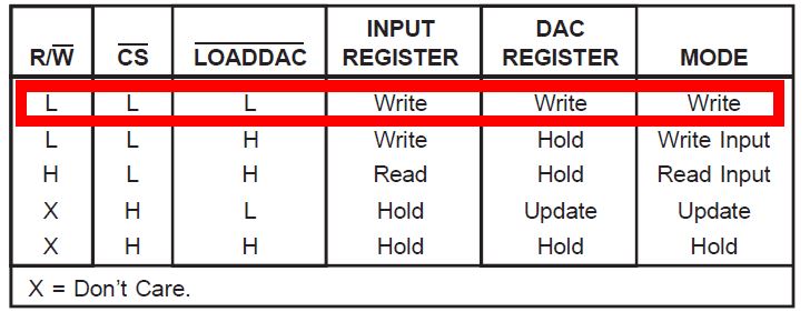

I would like to know the following status time chart of DAC7612E.
-R/W:Low
-CS:Low
-LOADDAC:Low
I attached Logic Truth table, I would like to get the time chart at red frame.

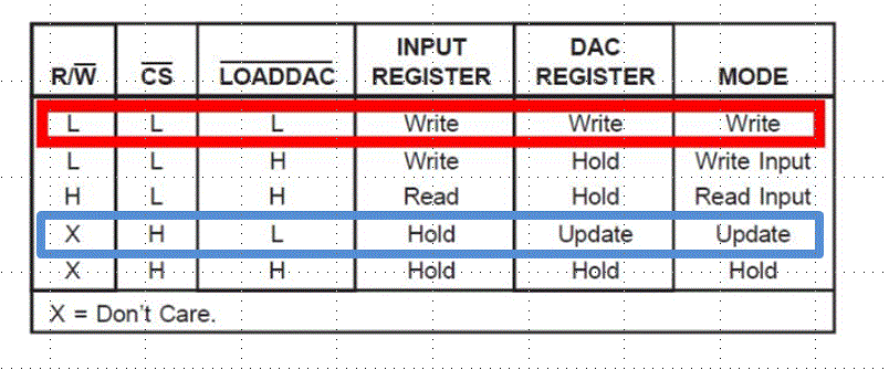

However, please check the red frame of logic truth table below.
I can understand that if we pull /CS, R/W and /LOADDAC to Low from High,
we can write to INPUT Register and DAC Register and the mode change to "Write mode"
Please tell me the timing regulation of /DOADDAC in"Write Mode"?

I understood the /LOADDAC signal timing, but is the mode that teach me "update Mode"?(Blue Frame)
I think that I can write to DAC register and Input register directly in "Write Mode"
So please tell me the write timing and regulation of /READDAC in "Write mode".
I can understood /CS and R/W Low timing from datasheet,
but I can't know the Low timing of ?LOAD DAC.(Red Frame)
I'm sorry I have asked you many times.
Sho
Sho-san,
The DAC7621 device includes a double-buffered register structure. This means that new data can be entered into the DAC without disturbing the old data and the analog output of the converter. At some point after the data has been entered into the serial shift register, this data can be transferred into the DAC register through a HIGH to LOW transition of the /LOADDAC pin. However, the /LOADDAC pin makes the DAC register transparent. If new data becomes available on the bus register while /LOADDAC is LOW, the DAC output voltage will change as the data changes. To prevent this, /CS must be returned HIGH prior to changing data on the bus.
Using this information with the truth table presented above we can understand that a write and update can either be accomplished by performing the action displayed in the red frame, or alternatively, you can break the sequence into two frames (one that updates the first buffer register, and the second latching the data into the second data register that results in updating the DAC). The sequence for this second option, is frame 2 and frame 4 (blue).
Please let me know if this answers your question.
Matt

Sho-san,
/CS and /LOADDAC cannot be connected together. As illustrated in the Digital Input Timing diagram in the previous posts or on page 4 of the DS, /LOADDAC must be asserted LOW after /CS is brought high. The /CS and /LOADDAC waveforms can have different active low durations, with a minimum duration of 50ns -- anything above 50ns is acceptable.
Therefore, for instance /CS can have an active low duration of 80ns, and /LDAC can have an active low of 60ns. Since both are above the 50ns minimum active LOW requirement, both are acceptable for normal operation.
