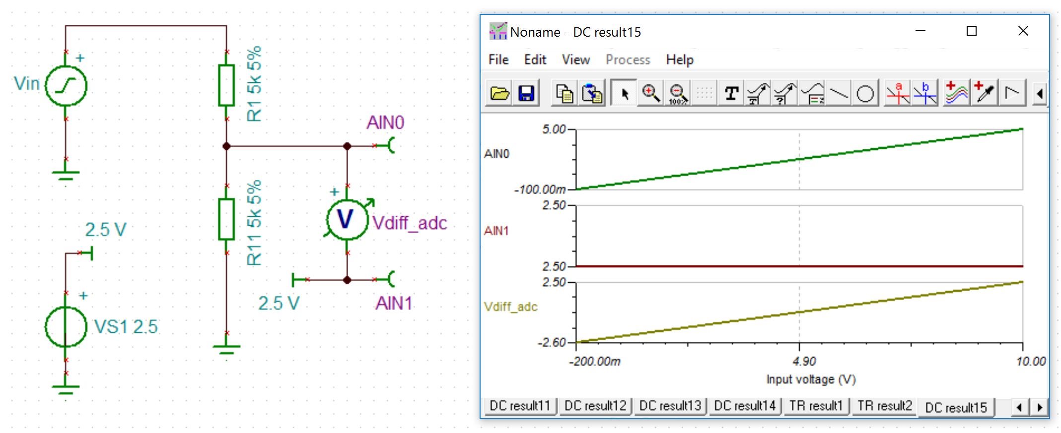

    First one is the simple single-ended measurement with AIN1 = GND. The signal gets reduced by 4/10 voltage divider and can get measured with the FSR of 4.096 V. The LSB of the ADC is 4.096V /215 = 0.125 mV and the input signal (-0.2V – 10V) will be measured with a resolution of 0.125mV*10/4=0.3125mV.

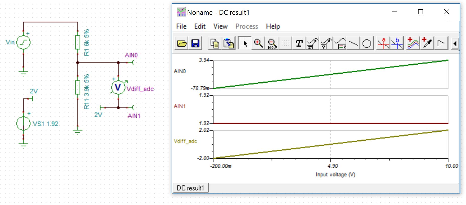

    The next circuit is a pseudo-differential measurement with AIN1 = VCM. The voltage divider reduces the signal by 3.9/9.9. AIN1 has to get connect to 1.92 V, which is the VCM (VCM=V1 - V2/2 = 3.94 V-(-0.079 V))/2=2 V minus the 80 mV shift.
    The differential signal Vdiff_adc is in the range of ±2 V and get perfect covered by full-scale range of ±2.048 V. The LSB is 2.048V /215 = 0.0625 mV, which gives a resolution of 0.0625 mV*9.9/3.9 =0.16 mV for the input signal (-0.2V – 10V).
    The second benefit is that the common mode voltage close to mid-supply, which offers higher accuracy.

  • Florian, the effort you put in to bring these ideas is extraordinary.  Thank you kindly.
    I thought it would be necessary to drive the ADC with a balanced driver.  Clearly this is not true.
    I see that a better understanding of this ADC would help me a lot.  As it is, your second solution offers the best performance.  I may want to add a non-inverting buffer before the ADC, but otherwise it looks great.
    Given the resolution of 160uV per bit, maybe the use of the PGA is unnecessary?  In such case, I might switch to an ADC that offers the same differential input and performance without the PGA.  Can you suggest something suitable?  I might also consider using an SPI bus, rather than I2C, but for now the I2C is OK.

    I just noticed,that the screenshot I posted for the second solution is not the right one. Here the correct schematic and plot:
    We have the ADS1013 device, which has the same performance like the ADS1014, but without the PGA. The good thing is, that the fixed FSR of 2.048 V fits great in you application.
