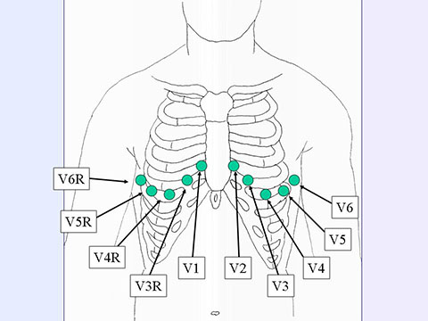

After that we has choose to test on a Real Patient with medical electrodes (FIAB, Euro ECG Electrodes: F9089) positioned in V6 and V6R as shown in the image below:
We kept the same board configurations as the Patient Simulator test. To try to be in the most similar conditions possible to the previous test we used a metronome to simulate a breath rate at 15 bpm and this is the result:
We has test many times and the results is all like the one reported above, that are really far away from the ones from Patient Simulator.
The only one thing that change on the two kind of test is the source of data, where on first there is the Patient Simulator on second test there is connected electrodes positioned on the Patient (I mean that we use the same cables, same connectors and same electronics excepts for electrodes).
Someone has some suggestion or some explanation for what is happening? There is something that I don't understand or I don't see that will cause this difference in results?

  • Hello Manuel,
    Thanks for your interest in ADS1298R!
    My first guess would be that the DC level of the signal is drifting due to changes in electrode-skin contact impedance. I see that these electrodes use a type of gel, but even still, the contact impedance can vary from one electrode to the next and also change over time.
    In additional, any subtle movements by the patient could introduce a change in the impedance between the electrode pair as well.

  • Hi Manuel,
    I understand your question. Our EVM was never intended to be connected to a real patient, nor has it ever been tested by TI in this manner. I have to emphasize that we cannot guarantee the safety of the patient or the quality of the results under these conditions.
    My only advice would be to use gel electrodes to lower the contact impedance as much as possible, which I believe you are doing already. Body hair and different skin types can have a big impact on this as well, so the results will still vary. Of course, the patient should also remain as still as possible throughout the measurement to minimize motion artifacts.
    I'm sorry that I cannot provide any further assistance on this.
