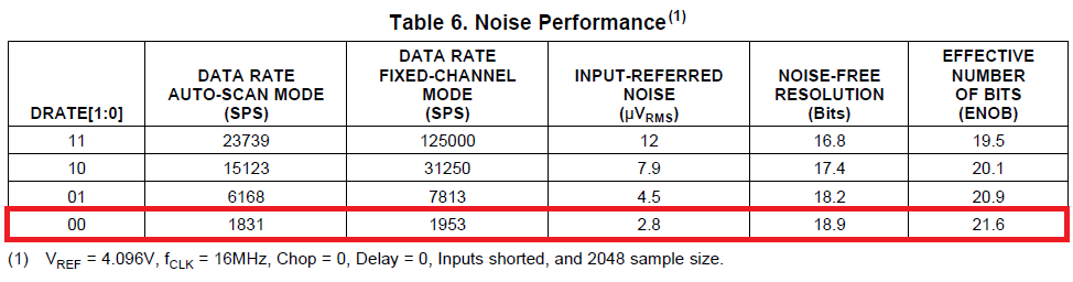

    The best case noise performance of the ADS1258 is shown in Table 6 of the datasheet:
    Assuming you're using the DRATE[1:0] = 00h setting, you should be seeing about 2.8 uVrms. ...From the three samples you collected the standard deviation is about 75.8 codes or 24 uVrms (assuming a 2.5-V reference). This noise is higher than expected and would lead me to believe that most of this noise is coming from the input signal you're applying.

    1. I believe your asking about the resolution, is that correct? Refer to table 6. This will show you the noise performance (i.e. Resolution) limits of the ADS1258, without the effects of input signal noise or reference voltage noise. Therefore, in practice you may observe addition noise due to external noise sources.
