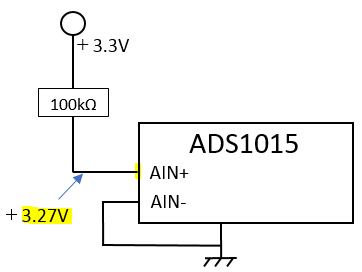

Could you tell me about ADS1015 AIN+ pin?
Customer is considering ADS1015 with the following figure configuration.
The results measured by the tester, the AIN+ pin was 3.27V.
Could you give me your opinion on the reason to drop the 30mV ?
Customers want to grasp error factors in order to accurately measure voltages.
Yusuke/Japan Disty

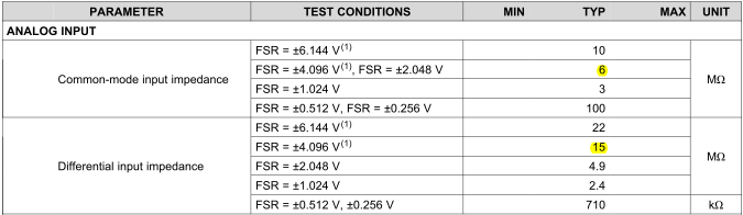

    The drop in voltage (~0.03V) is due to the input impedance. The ADC samples the input voltage with sampling capacitors at a modulator frequency of 250kHz. This is described in the datasheet on pages 9 and 10. Table 2 shows the differential input impedance, which varies with the full scale input range in the datasheet on page 10.
    On top of the differential input impedance, there is a common-mode impedance that also varies with the full scale input range. Specifications are listed in the Electrical Characteristics on page 3 of the datasheet. The equvalent input impedances are shown in Figure 12.
    If they are using a range of ±4.096V, the differential input impedance is 15MΩ and the common mode impedance is 6MΩ. In parallel, these become 4.3MΩ. If the supply is 3.3V, and the series input resistance is 100kΩ then you can expect the input to be voltage divided to:
    3.3V * 4.3MΩ / (100kΩ + 4.3MΩ) = 3.23V
    If the range is ±6.144V, the input would be near 3.25V.

  • Tsukui-san,
    There are a few things that may affect the measurement of this value. First, the multimeter probably has an input impedance that is similar to the input impedance of the device. The measured value may be different than the actual value just because of the input impedance of the multimeter.
    Second, there may also be leakage currents from the input pins because of the ESD structures. These reverse bias diodes may cause some input current which will change over temperature. This is likely to be less than 1nA at room temperature, but the input current may increase at higher temperatures.
    Based on the differential and common-mode input impedance mechanism, I'm not sure what the variation of the input impedance will be. It is dependent on the input capacitance variation, and the sampling time variation. It is likely that the variation is rather high.
    Regardless, the best way to minimize the voltage drop is to reduce the series input impedance. I recommend that the series input impedance is less than 10kΩ.

  • Tsukui-san,
    I don't have a good way to minimize the voltage variations. The input current will vary depending on several factors as I've mentioned. There are only a few things I can think of to lower this voltage:
    1. Reduce the series resistance at the input of the device.
    2. Use a higher input range so that the equivalent differential and common-mode impedance are higher. To keep the same resolution, the customer could use the ADS1115 instead.
    3. Use a different device with a lower input current. The ADS1120 may be an option. It likely has more features than necessary for the application, but does have a lower input current. Note that it uses an SPI interface.
