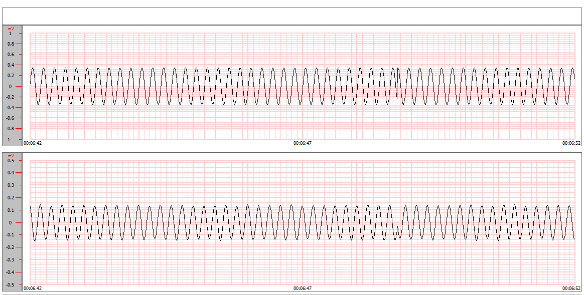

In my application, my microcontroller writes the measured ECG/ICG to a flash memory which I can later download and view. For this, I have an interrupt which fires on the falling edge of DRDY. If I setup a patient simulator to output a 1mV pk-pk 5 Hz sine wave, the ECG looks fine. However if I put my patient simulator in series with a "box that simulates ICG", glitches occur at various points in my ECG and ICG waveforms, see example below (ECG top, ICG bottom vs time).
For this SCLK = 263.2 kHz (measured on oscilloscope). Over a 30 minute period, 3-4 glitches occur. Any suggestions?

    I do not see anything that concerns me in the register settings. Also, using an SCLK = 263.2 kHz should be more than fast enough to read all the data between /DRDY intervals. Have you been able to capture the SPI activity during one of the glitches? Understandably, that's only one in every ~100k - 150k samples.
    I'm not very familiar with ICG simulators, but my first guess is that the scope of this issue is limited to the signal source. I would also try monitoring the voltage at the input of the ADS1292 to validate whether the glitches are present there as well.
