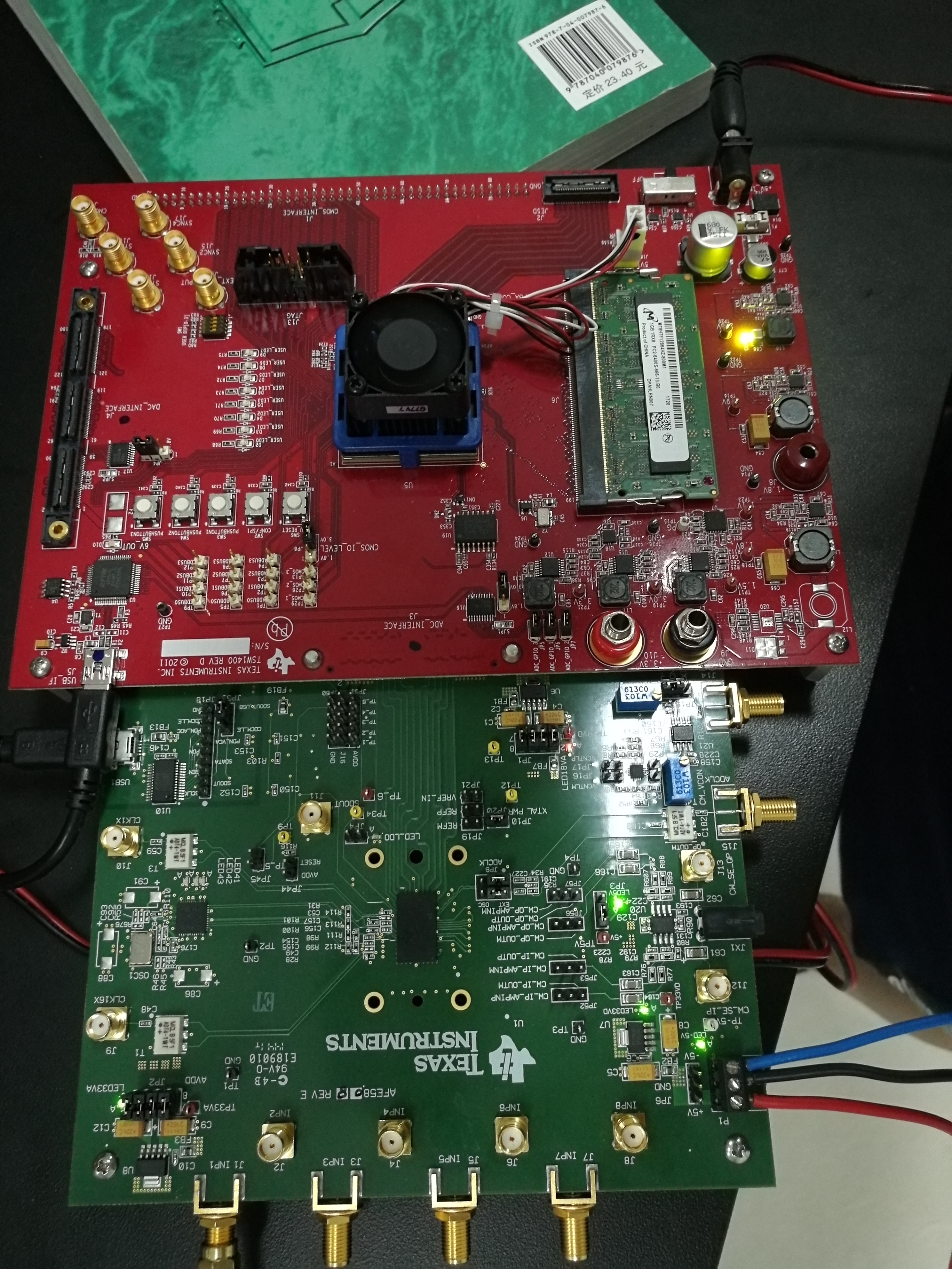

I'm currently using a TSW1400EVM to connect to AFE5808AEVM. After power up, the 5V input should draw around 0.37A. The only LED  C87 is on. The power supply for AFE5808AEVM is providing +-5 volts and slightly over 0.7A.
The board itself is recognised by the software and appears in the window for selecting the serial number of your board. After clicking on 'OK' it runs for about 2 seconds before a message appears saying 'No Firmware. Please select a device to load firmware into the board'. If the desired ADC is then selected it tries to download the firmware and then repeats the previous message. The ADC specific GUI has also be downloaded.

    4. When the message that"No Firmware. Please select a device to load firmware into the board' is valid" appear, I choose the "AFE5808_09_14b.rbf".
    5. I have the AFE5808A GUI already running first before launching the TSW1400 GUI. After the GUI has launched, LED41 and LED42 go off and the rest of the LEDS remain on.
    6. My Procedure :
    6.1. AFE5808A GUI and HSDC Pro V4.9 run.
    6.2. Select the serial nubmber of device ...> K1227029-TSW1400...>OK
    6.2. "No firmware. Pease select a device to load firmware into the board." --> OK
    6.3. Select"AFE5808_09_14b.rbf" in HSDC Pro GUI. waiting.....
    6.4. "Initialize ADC ADC _PINMAPPING_INDEXES_INVALID ADC channel ordering indexes are not valid?" --> Yes
    6.5. "No firmware. Pease select a device to load firmware into the board" is shown again.

    After I Select"AFE5808_09_14X" in HSDC Pro GUI. waiting..... "No firmware. Pease select a device to load firmware into the board" is shown again. I have no idea.

    Can you ensure the TSW1400 EVM is not current clamped on the supply voltage?
    What is the current limit set for the 5V supply to the TSW1400 EVM?
    Can you also provide a screenshot of the HSDC Pro GUI?
