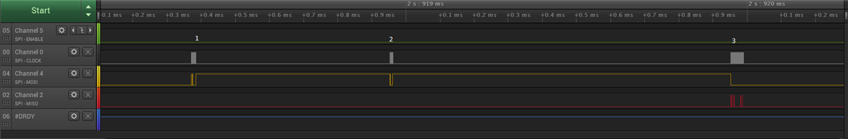

    The following plots shows a working configuration with 720kHz MCLK and 1.6875MHz SCLK.
    The first plot shows the overall sequence from startup:
    The next three plots show a detailed view of the marking "1" inside the first plot:
    Write to the option register:
    Read all registers:
    And here is a detailed view of point "2", marked in the overview plot, as you can see, everything seems correct:

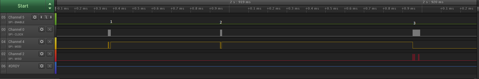

    Now I change the SCLK to 3.375MHz.
    The initialization duration is the same, here is the overview (the data gathering is not starting, because my firmware could not verify the ID of the ADC):
    The write-to-reg plot looks exactly like the upper one, except that the baudrate is faster. Now here the register read, all zeros:
    Now I change SCLK back to 1.6875MHz AND remove the delay from my software sequence:

  • Hi Reggie,
    With the Thread::Sleep(2); - how much 'delay' does that actually give you? You might be violating the td(DECODE) (see table in section 6.6), which would explain why slowing the SCLK down originally helped your situation.
  • Hi Tom,
    thank you very much for that tip. I think that should do the trick. I hadn't realize that this timing requirement is in t_clk's units. I assumed it was in ns.
    So I think that problem should be resolved :)

  • Hello again,
    just sending now three SPI packets, to follow the datasheet SPI rules. So the previously, randomly missing first byte is now always available.
    Overview (MCLK 720kHz, SCLK 1.6875MHz):
    The packets:
    But I've been too early pleased, when switching SCLK back to 3.375MHz I always getting zeros like before. Maybe I missed again something from the datasheet?

  • Hi Reggie,
    Rather than insert the delay between packets, can you try inserting a small delay between the command byte and the rest of the register read/write detail?
  • Hi Tom,
    which command byte do you mean? The datasheet says there are two command bytes (chapter 8.5.1.8.5) for register read / write operations.
    Greetings,
    Reggie
    EDIT: Tried to put in a delay after each command byte, same behaviour. Now sending:
    WriteReg command(0x41) - delay - {0x00 0x01} - delay - ReadReg command(0x20) - delay - 0x07 - delay - {0x00, ... 0x00}
  • How much delay do you have? With your master clock of 720kHz, you need about 5.5uS.
