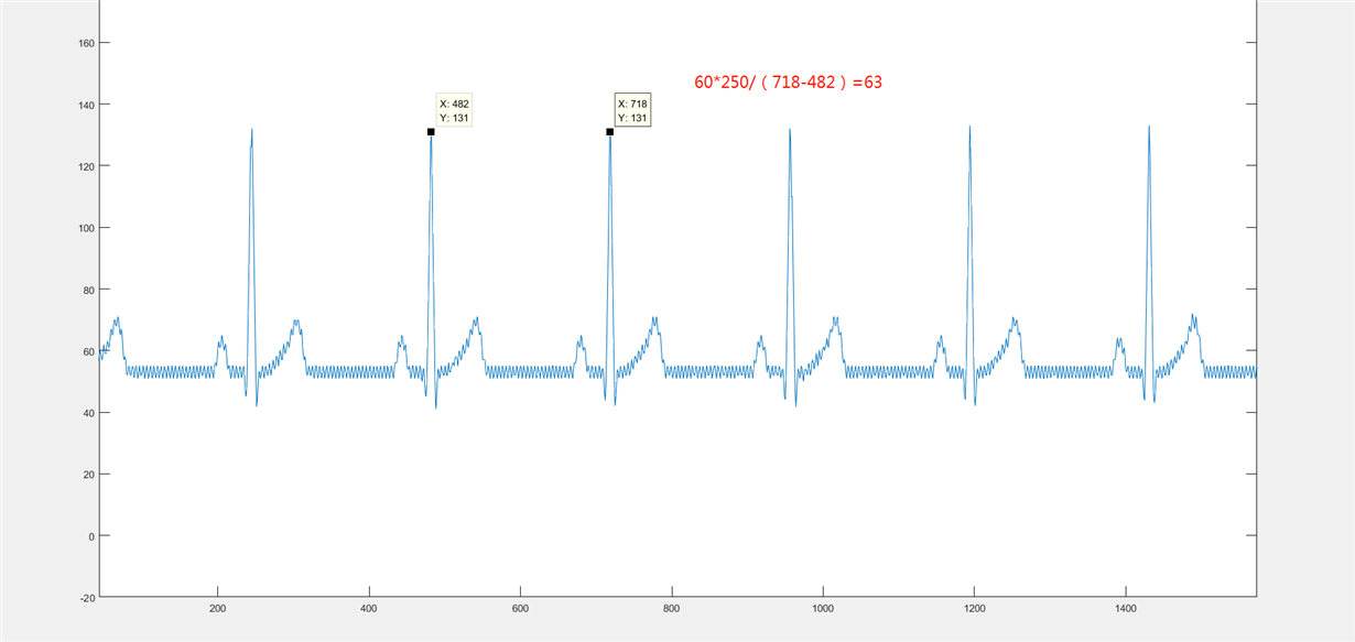

    I have a project that is using the ADS1294R as ECG signal acquisition chip. The ADS1294R runs in LP MODE and the sampling rate is set at 250 SPS. We use the standard ECG signal generator to send ECG signals. After analyzing the sampling data, we found that the sampling rate was only about 236 SPS, which leads to the deviation of heart rate calculated from the data collected by the chip. The waveform of one section of the data analysis is as follows:
The heart rate generated by the signal generator was 60 bpm, but the heart rate measured by the ADS1294R was 63 bpm. After analysis, if the difference between the two R waves is 250 points, the heart rate is 60 bpm, but the difference between the two R waves measured is 718-482=236 points. So the heart rate measured is 63 bpm. I wonder why there was a deviation in the sampling rate of ADS1294R. Are there any registers' setting I have misconfigured, or are the timing of reading the data incorrect?

    To check the data rate period, use an oscilloscope to probe the /DRDY output. The time between the falling edges is the data rate period for all 4 channels in the ADS1294R. It should be 4 ms for 250-SPS data rate. The only way the data rate could be slightly different is if the master clock frequency was scaled a littel slower than the default 2.048 MHz.
    The data looks correct in your plot, so you do not appear to be missing samples. Are you using RDATAC mode and reading every sample? Or are you using RDATA mode and reading by SPI command? Please share your CONFIG1 register setting.
