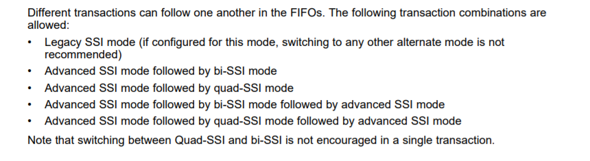

The recommended method for setting the ADS8910B to quad-SSI mode with the MSP432E401Y is to first configure the MCU SSI port for 4-wire SPI and write to the ADC's configuration register, then configure the MCU SSI port for quad-SSI mode. The MSP432E401Y recommends against switching from legacy SSI to quad SSI mode:
Is a one time switch from 4-wire SSI to quad-SSI acceptable despite this warning? Would it be better to use separate SSI ports on the MCU for the initial 4-wire SSI ADC configuration, and the quad-SSI data retrieval?
For the hardware implementation of this method, the MSP432E401Y's SSI_Tx is shared with the quad-SSI XDATA0, so the SDI and SDO-0 pins on the ADC8910B would need to be tied together. Will this cause any issues on the ADC end? Is the SDI pin ignored by the ADC when it is outputting data on the SDO-0 pin?
  • Hi Michael,
    You will need to use separate MSP432 pins for the SDI and SDO-0 pins. The ADS8910B captures data on the SDI pin at the same time as outputting conversion data or register data on the SDO-x pins.
    I am not familiar with the MSP432 and the QSSI, but you will probably need to use separate SSI ports, one to handle the standard SPI and the other to handle the quad-lane data. I need to check with the MSP432 support team and will reply back when I have some answers.

  • Please keep me updated on the MSP432 team's feedback, but it seems that if I need to separate the SDI and SDO-0 pins on the ADS8910B, then I don't have any other option than to use separate SSI ports on the MSP432. In this case, I believe I can tie the CLK and CS of the two separate SSI ports together and connect the SSI_Tx of one port to the ADC SDI, and the quad data lanes of the other SSI port and ADC together.
  • Hi Michael,
    I think you are correct; you will need to configure two of the SSI ports if you want to use 4 lanes for SDO.
