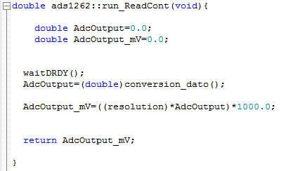

    The function with which I read the data:
    ****The start command is sending in the initialization.
    And the conversion_dato() function:

  • I would try commenting out the following lines of code and just return dummy data...
    AdcOutput=(double)conversion_dato();
    AdcOutput_mV=((resolution)*AdcOutput)*1000.0;
    Currently, the code is polling /DRDY and then goes off to read the data. While the MCU is reading the data it will not be checking the state of /DRDY and so it could be missing these signals and causing the data rate measurement to be incorrect.

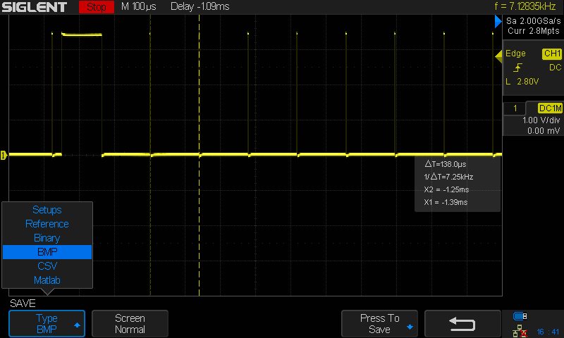

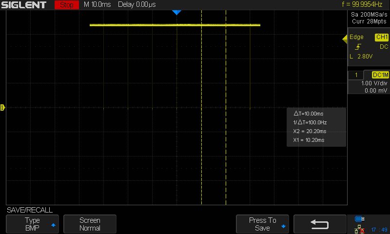

    I have measured the /DRDY pin with the oscilloscope and its response is correct and correspond with the programming data rate. But I have seen three cases:
    1.- For low frequencies the /DRDY pin show perfect and the data is retrieval (as it is said in the pag. 67 of datasheet). All work good.
    2.- When the frequency is increased for example to 7200 SPS, the data is not retrieval. I would like to know why happens this and how I can put a solution.
    3.- When I use a frequency of 100 SPS for example and I measure the time with a timer, I obten an incorrect value of time that correspond with a samplig rate to 400 SPS. But at the same time, the signal of /DRDY pin measured with the oscilloscope is correct and correspond with the 100 SPS. Why happen this if in the code I´m using the "while" to wait until the data is ready?

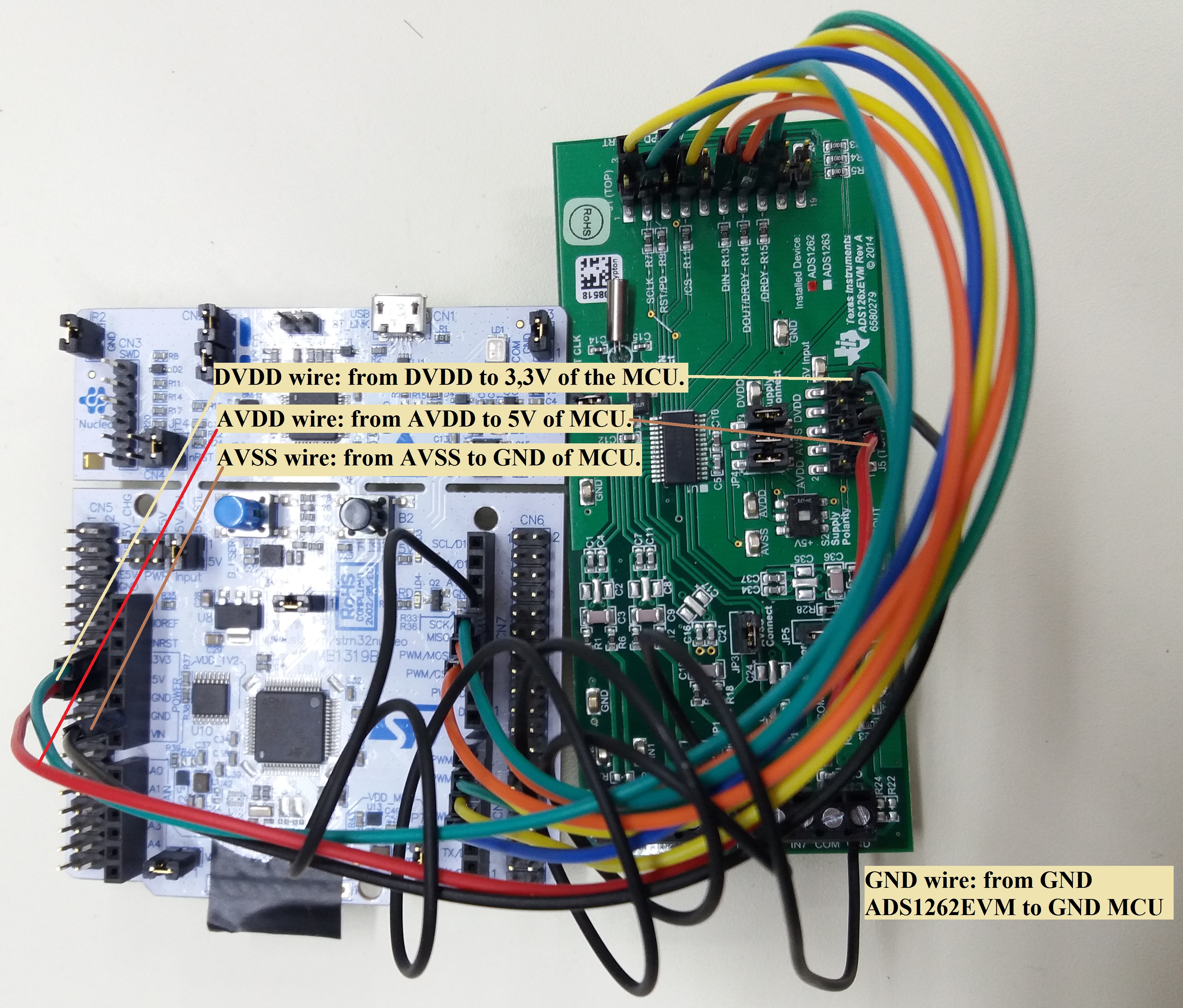

  • What MCU are you using and are you jumper wiring this MCU to the ADS1262EVM?
    If so, would to be able to share picture of your hardware setup?

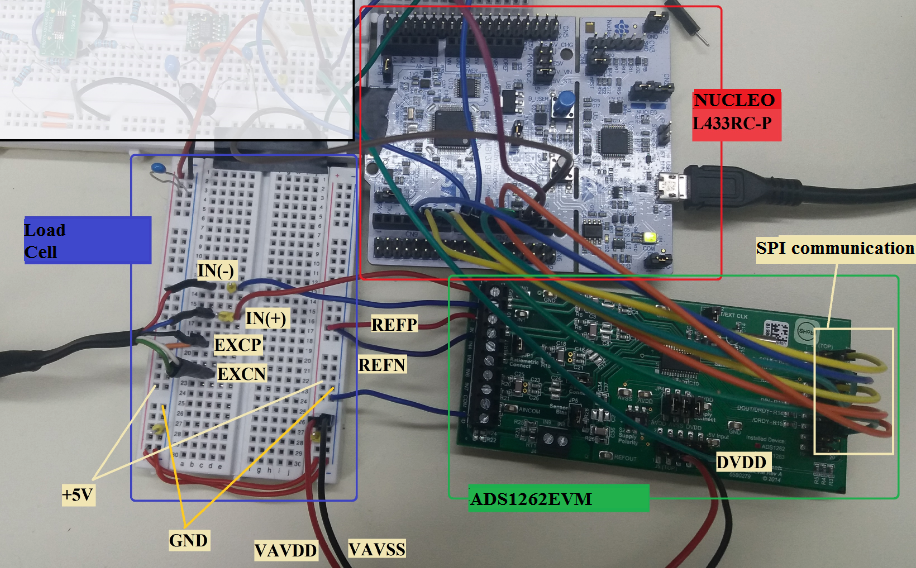

  • Hello
    I´m using the MCU L433RC-P of STMicroelectronics. And it works at a frequency of 33 MHz.
    Here you have the connection with the ADS1262EVM:

    Doing this the problem at high frequencies persists, and when I measure the /DRDY pin with the oscilloscope it shows that the data is not retrieval.

  • Hi José,
    At the moment it would seem like the MCU is not reading the data fast enough above 100 SPS and causing your timer to return a bad result.
    Is the interrupt code that you showed above working at the lower data rates? Technically you're just polling for the interrupt now, but this should be faster than polling the GPIO pin, so I still prefer this implementation as long as it works.
    With the four different boards your jumper wiring between you can run into a lot of issue with poor signal integrity and ground bounce. For debugging, can you remove the two bread boards and just connect the NUCLEO board to the ADS1262EVM? Make sure to have a ground wire connected between these two boards, and if you can, wrap this ground wire around all of the other wires going between these two boards so as to minimize the loop area/distance between these wires.
    I recommend starting from a simple test setup. Select the analog supplies of the ADS1262 as the reference source and short the ADC inputs to AINCOM (internally) with VBIAS enabled. If you can get this setup to work and verify that the noise performance looks good, then I'd recommend adding in the load cell and testing the noise with the load cell connected. Also, you should be able to connect the load cell directly to the ADS1262EVM and remove the intermediate bread board. Doing should should help remove one possible error source.

  • Hi José,
    That's the right idea but minimize the loop area as much as possible, especially with regards to the area between the GND and SCLK wires.
    Here is an example of what I typically do:
    Notice the ground pin adjacent to SCLK. Connecting the ground wire to this pin will help to avoid digital signal integrity issues:
    It's possible that your issue is purely code related, in which case you ought to be able to debug it with this setup. I would highly recommend trying to solve this problem with a simplified setup before putting everything back together. When trying to debug a system as a whole it often becomes very difficult to track down the source of the issue, whereas building upon a working sub-system and testing new additions will better allow you to figure out where any issues might lie.
