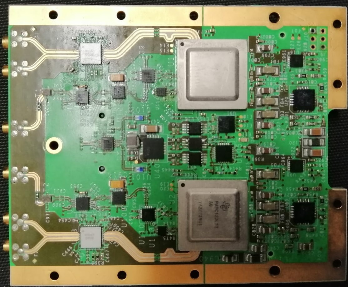

I'm design a board with four ADC12DL3200 and now I'm trying to sync the ADCs.
I've enabled the SYSREF receiving setting
- SYSREF_RECV_EN = 1
- SYSREF_PROC_EN = 1
- SYSREF_LVPECL_EN = 1.
I've send SYSREF signals to the ADCs and I've verified that the bits
ALIGNED =1
REALIGNED = 1.
Then I've measured the data phase match and change the phase of a specific SYSREF signal.
I've resetted the ALIGNED and REALINGNED bits and send several SYSREF signals.
After this I've verified that the ALIGNED = 1 but REALIGNED = 0!
Why the SYSREF signals are received but not processed?
Is there a specific comand to able the processing?
i'm looking forward to hearing from you
Regards.
Daniele Sassaroli

    You say that you are seeing a constant phase delta between the different ADCs on the board, but that the delta phase is not good for your system.
    Are the CLK signals delivered to the 4 ADCs routed with matched delays so they are all phase aligned?
    How much phase delta are you seeing (comparing the same DxCLK or DxSTR signals on each of the 4 ADCs)? Even if the input CLK signals are phase aligned there will be some differences due to part to part variation in Tod (output delay) between the 4 ADCs.
    Jim B
  • Hi Jim,
    The clocks are distributed using several buffers and switchs and this network has a delay that is not easy to manage. This is one of the reasons to manage the delay of the SYSREF signals.
    The CLK and input signals are routed with matched traces and simulated using CST Microwave SW.
    Moreover the ADCs uses different inputs: 2 ADC use INA inputs and and 2 ADC use INB inputs. In particular, if the board distributes the same input signal, clock and SYSREF at two different ADCs (LDEMUX = 1 and LFRAME = 8) and one ADC uses INA input and the other ADC uses INB input, Is there a specific difference between the phase of input signals acquired?
    Today I will do others measurement to study the results and maybe I understand the problems.
    Daniele
  • Hi Jim,
    The clock distribution network is composed of buffers and switchs and it is not easy to calculate the complete delay or mismatch between each clock route. However the clock traces routed are matched and simulated with CST Microwave Studio.
    The delta phase observed is about 1/2/3 samples and I don't think it is only related to part variation in Tod between the four ADC.
    I've also the following questions:
    1. I've instantied two couples of ADCs. In each couple of ADC, one ADC1 uses INA such as RF input signal (the INB is terminated) and the other ADC2 uses INB such as input signal (the INA is terminated). Both ADCs works in DES-MODE (LDEMUX = 1 and LFRAME = 8). If the clock and SYSREF traces are perfectly traced, the difference in the ADC input (INA for ADC1 and INB for ADC2) maybe produces a mismatch in the sample of the ADCs. What do you think?
    2. In the board, I can move the SYSREF signal respect the clock signal phase for 1/2 ADC clock cycles. When I move the SYSREF for a little quantity, I observe ALIGNED = 1 and REALIGNED = 0. The ADC doesn't recognize the timing change of the STROBE signal. Is there a minimum quantity of time to move the SYSREF signal that the ADC recognizes and then changes the STROBE timing? What the minimum change of STROBE timing?
    Daniele

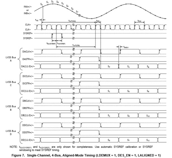

  • Hi Jim, I've discovered another misunderstanding. Reading the datasheet, I've saw that in my ADC configuration
    the data sample are aligned following A,C,B,D buses and not A,B,C,D: see the figure 7. Is it correct?
    Daniele

  • Hi Daniele
    You can attach your files by first clicking the "Insert Code, Attach Files and more..." link below the reply window, and then using the file attach (paper clip) icon above the more advanced reply window.
    I am confirming the proper data base sample order and hope to have that information tomorrow.
    Jim B

  • Hi Daniele
    I will review the files you have attached.
    Regarding Figure 7 in the datasheet, there is an error.
    The samples are actually ordered as A, B, C, D, not A, C, B, D as shown in the figure.
    The datasheet will be updated to correct Figure 7.
    Jim B

  • Hi Jim,
    in the last two weeks I had problems to do the test.
    I think that the next week I will have the time to close the test of RF section and in particular the
    experiment suggested by Paul.
    I have attached a picture of the RF section of the board under test. You can see only two ADCs and the T&H.
    Thank for your support.
    Daniele
