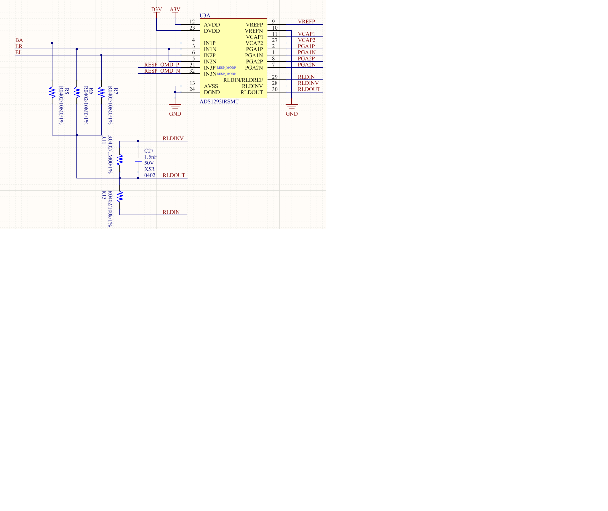

Dear TI
My circuit is with only 3 leads BA,ER,EL. Therefore i don't have the lead to connected to RLDOUT.
How should I improve the rejection of 50/60Hz noise.
Will my design bellowed will work?
And the input impedance reduces to 20M, is there any good solution?
  • Hi Harvey,
    Thank you for your post and welcome to our forum!
    The circuit you are showing will work ok for measurements without an RLD electrode, but you will not see the same improvement in CMR in this setup. As you can see in this application note, the lower the resistance between the RLD output and the body, the better the common-mode cancellation effect is.
    The other concern with this approach is the reduced input impedance. For IEC/AAMI standards, you will probably need greater than 10 M in order to limit the DC current. Larger resistance values may lead to significant offset in the presence of leakage current. You can try increasing the resistors to 100 M and reduce the gain of the PGA to see if you can meausre the inputs without saturating the amplifier.

  • I may be able to tell something about it. But I have a few questions:
    -What is the purpose R11 and C27?
    -What is the purpose of R13?
    -Is the ADS1292 set-up such that RLD out is at mid-supply?
    -Do you intend to design a battery operated device?
  • Setting RLD_SENS to 0x2F means that common mode signal of the 3 input leads in your schematic are inputs for the inverting RLD amplifier and that this signal is fed back to the leads again via the 10M resistors, I don't think that will work.
  • Hi Harvey,
    I'm not sure if RLD_SENS = 0x2F will work either, it may simply cancel out your signal of interest. Typically, the RLD is used for common-mode cancellation when there is some separation between the placement of the RLD electrode and the ECG measurement electrodes (RA, LA, LL, etc.).
    Chief - R11 and C27 set the closed-loop bandwidth of the RLD amplifier. Limiting the bandwidth helps maintain stability as the RLD amplifier is driving several high-frequency poles from cable parasitics, etc, which are part of the larger feedback loop that encompases the patient.
    R13 is the protection resistor used if RLD is routed back into the chip and drives the patient through one of the measurement electrodes. See "Rerouting the Right Leg Drive Signal" section on page 50. If this feature is not used, R13 can be left uninstalled.
  • Hi Ryan, If the RLD amplifier is used in a configuration to drive an RLD electrode I understand the purpose of R11 and C27 but the idea in this thread is not to use an RLD electrode. So in this case I would expect the RLD amplifier to be configured as unity gain buffer, so RLDOUT and RLDINV shorted and no R11 and C27. The RLDREF_INT bit is set to 1 meaning that RLDOUT is at mid suply and used to bias the leads via the 10M resistors. Since the inputs are already pulled to the mid supply I see no use for R13 in this application.

  • Hi Harvey,
    I would recommend leaving the RLD circuit as it is for now with the closed-loop feedback components installed. Even if you are just driving a DC voltage to set the common-mode, the closed-loop bandwidth will limit some of the RLD amplifier noise. It will not hurt performance to keep them.
    I have some preliminary simulation results that indicate the RLD amplifier can still be used to mitigate some of the CMR loss due to antialiasing filter mismatch (fyi - the antialiasing filters are not shown in your schematic). However, because we are not driving the body directly, any common-mode-to-differential signal conversion that occurs before the RLD pull-up will not be reduced by this method.
    I'm not totally sure yet whether AC-coupling is more helpful or hurtful in this configuration. I'm continuing to look into that as well.

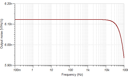

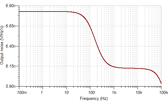

  • "he closed-loop bandwidth will limit some of the RLD amplifier noise"    ->  I tend to disagree, although not significant, noise will increase by the 1M feedback resistor that is shorted by the 1.5n capacitor for high frequencies.
    noise simulation with open switch:
    with closed switch:
    Simulation confirms this. So you add components and make things worse. I do not see the benefit.
    Kind regards
