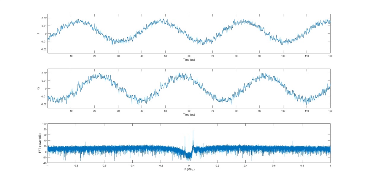

For a few different input levels we measure clean sinusoids of ~30 kHz with an oscilliscope at the AFE inputs, but what we observe in sampled data is shown in the below plots (where I = AFE ch 16, Q = AFE ch 15 shown for part of the sequence sampled, while the FFT is done on the complete sequence).
Input ~10 mVpp:

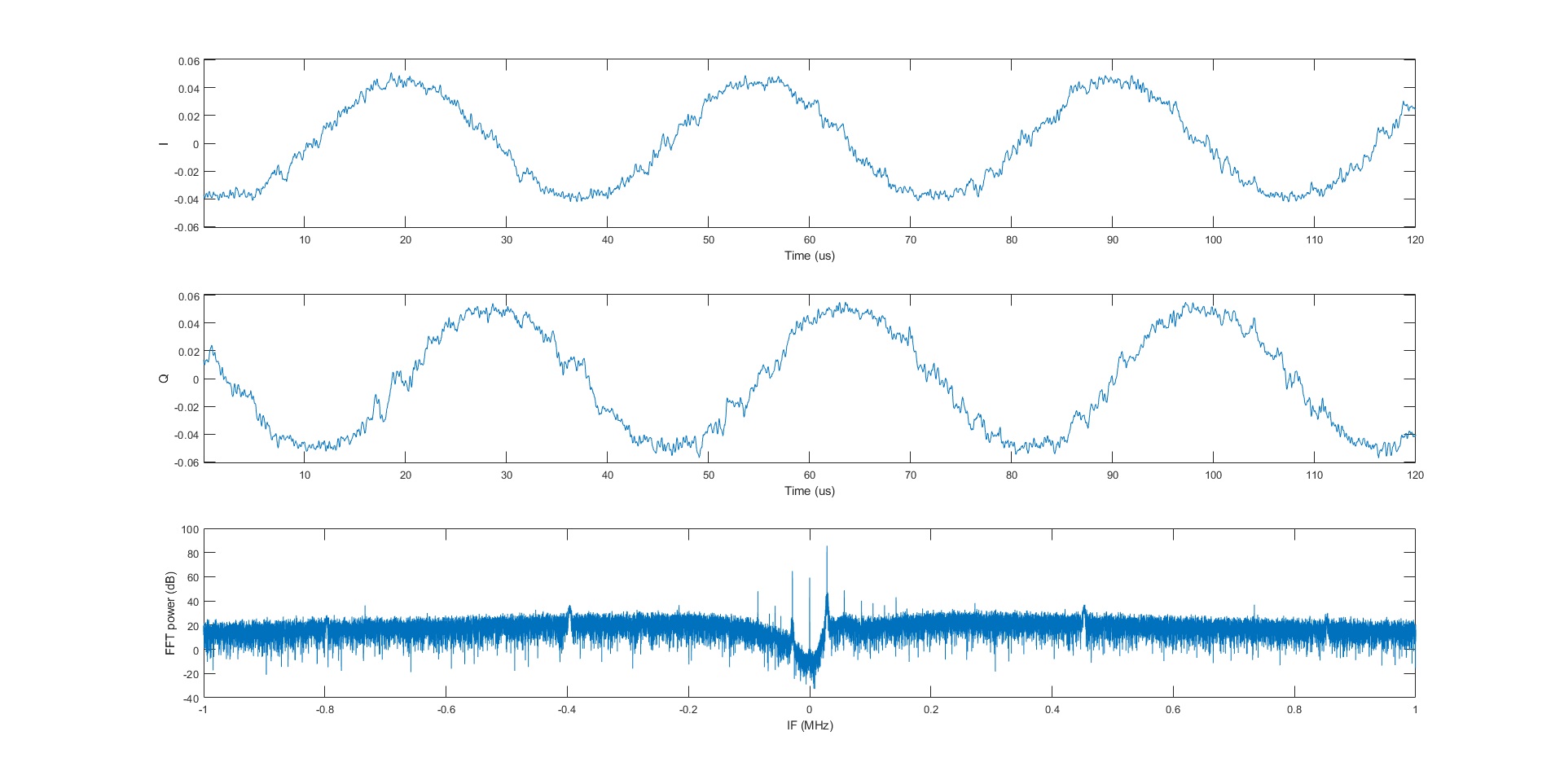

Input ~35 mVpp (some harmonic components are starting to show more clearly):

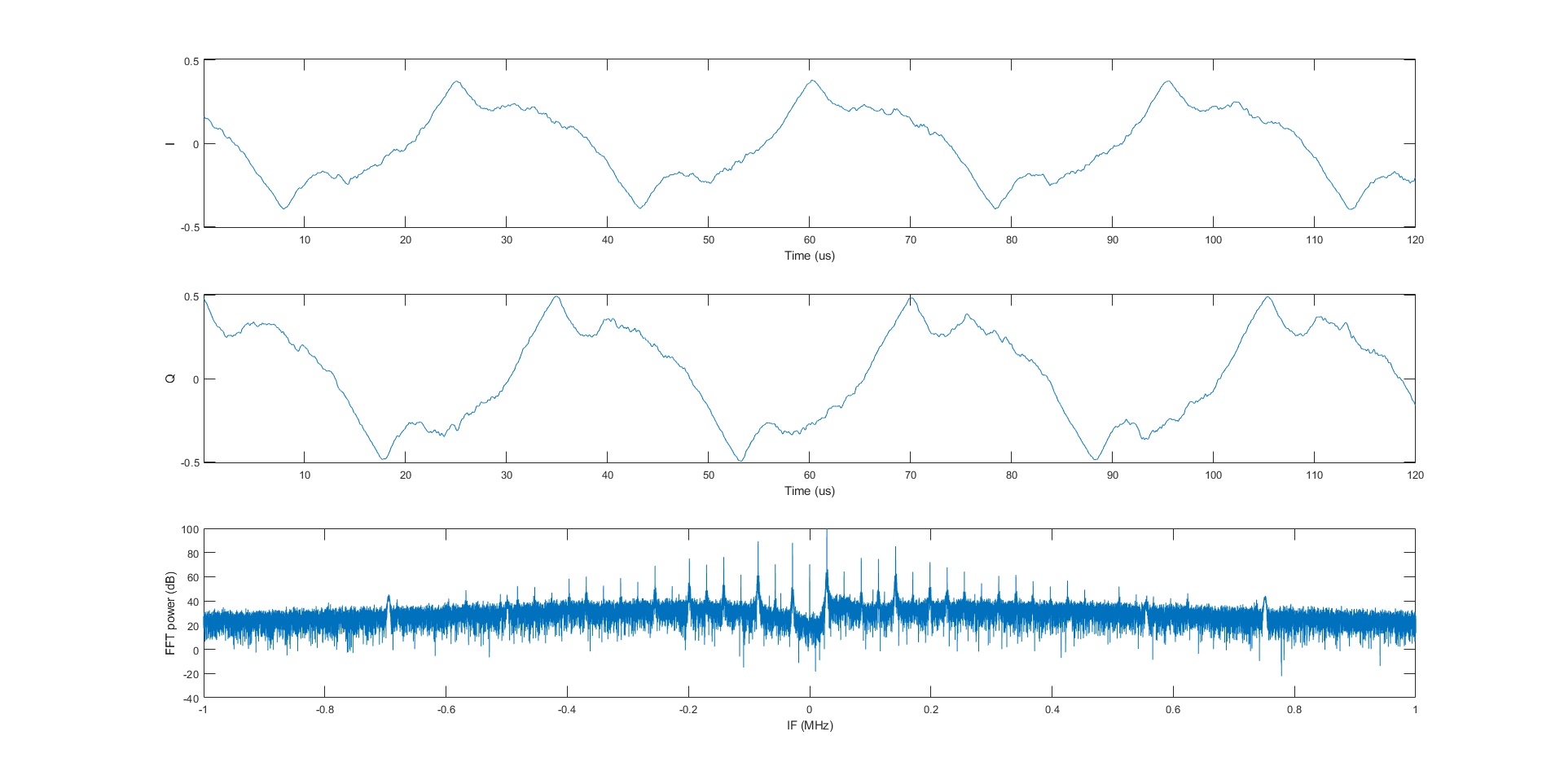

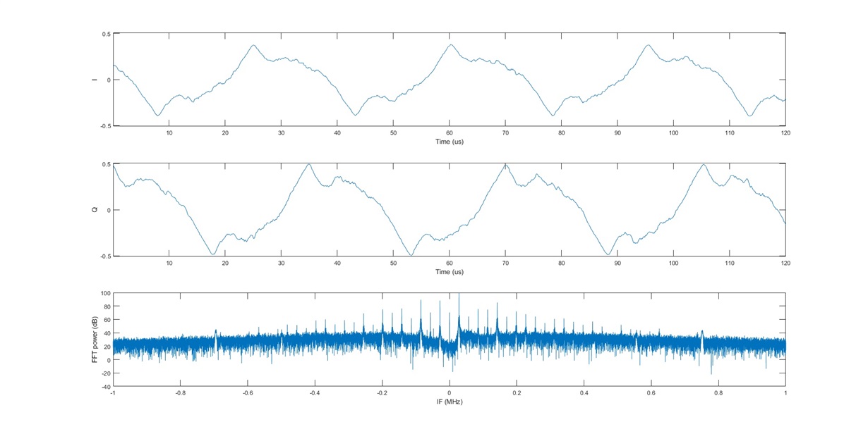

Input ~100 mVpp (here there is a clear jump in signal level and harmonic content):
Is there something we are doing wrong in the register programming or are there some limitations in the HPF/DC-compensation circuits that we have failed to understand?

  • My posted images look broken to me. I'll try to repost them again here:
    Input ~10 mVpp:
    Input ~100 mVpp (here there is a clear nonlinear jump in signal level and harmonic content):
  • Just to make it clear again. This is in TGC mode and I and Q refers to channel 16 and 15 on the AFE. These are IF signals from an external mixer (not the AFE CW mixer). The FFT spectrum is the complex FFT(I + j*Q).
    Christer
  • And the distortions are only seen in sampled data, not in the IF signals at the inputs of the AFE.
    Is there are problem with our register programming or is there a problem with the AFE DC offset compensation circuit?

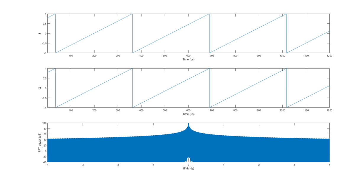

    Here is the RAMP output:
    Let me know how you are progressing.
    Christer
  • Thank Christer,
    Thank you for showing me know ramp pattern test output.
    Looks like the captured output data work perfectly!
    Thanks!
    Also looks like you are using 14bit mode
    so the output Ramp data are from 0 to 16383. right?
    Thank you!
    Chen

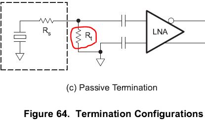

  • Hi Christer,
    How are you?
    Here we have verified your request again
    including all the resistor settings and register settings as follows.
    And also you can see our measurement shown in the following photo.
    (All the correct settings are shown inside two red color boxes.)
    1) For very low input signal freq:
    The following settings must be required:
    make sure Connect INP with 0.1uF cap
    make sure Connect INM with 1uF cap
    Set LNA_HPF_DIS=0 (this can help reduce the offset difference from channel to channel)
    Set PGA_HPF_DIS=1 (this HPF is used for input high freq signal only)
    Here are two boxes shown:
    You can see if PGA_HPF_DIS=0, then the signal can generate higher harmonics
    so please turn off PGA_HPF to avoid this issue.
    After you disable PGA_HPF, you can see the output data working correctly.
    2) We used passive termination Rt=50 ohm (shown as the following plot).
    Please try it if you can.
    Hopefully this time you can see your measurement as good as we measured here.
    Thank you very much!
    Chen
