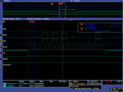

I wanted to try programming registers on this part. I'm using a PRU core on an AM5728 to generate the SPI signals. However, I am not sure that I am doing this correctly.
I wanted to set register 5 (OUTPUT_DATA_WORD_CFG) to a value of 0x02 (enable fixed pattern in the output data word) and then read it back from the device.
Here is how I reset the device (267ns low gong RESET pulse, CS and CONVST high incidentally):
Then, I wait 1.1us before issuing and SPI communication:
Then, I write to register 5 (send 0x1502 let me know if this looks ok). Notice how SD0 mirrors what I put into SDI.
Then, I send command to read from register 5 (send 0x2500 let me know if this looks ok):
The datasheet says that the read results are returned in the next frame, so I send in (0x0000), expecting to see something returned on SD0 but 0 is seen on SD0.
Am I doing this wrong?

    The commands you're sending to the ADS9224R look correct for reading and writing registers. There seems to be a slight delay between the SCLK falling edges and the transitions on SDI, but the rising edges still align with the correct data value.
    However, I did not expect to see SDO mirror SDI like that. This may sound silly, but can you check if there's a short between them? Also, does SDO always mirror SDI like that, meaning you cannot even read default register contents or conversion data?

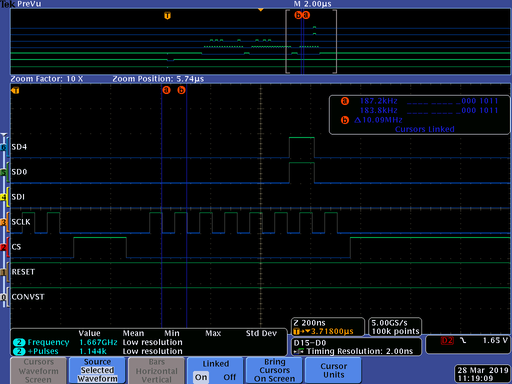

  • Hi Brian,
    Please see the following scope captures below:
    WREG 05h: 0x02
    RREG 05h:
    Register 05h value:
  • I saw that your SCLK frequency was much lower. So, I tried lowering mine.
    10MHz did the trick. So, why does it need to be so slow?
    Datasheet says 60MHz for single data rate.
  • Hi Brian,
    I'm glad things are working now. At the moment, I can't tell for sure why the slower SCLK would have made a difference. There might have been some timing violation that was mitigated by slowing things down, but so far I don't see what that might be. The setup/hold times between SCLK rising edge and valid data on SDI are only 1.5 ns, which you seem to be meeting in all cases.
    You might want to double-check the time between /CS falling edge and first SCLK capture edge (tSU_CSCK). This needs to be a minimum of 12 ns. You certainly have enough time in the last image, but it might be a little close in the earlier ones.
