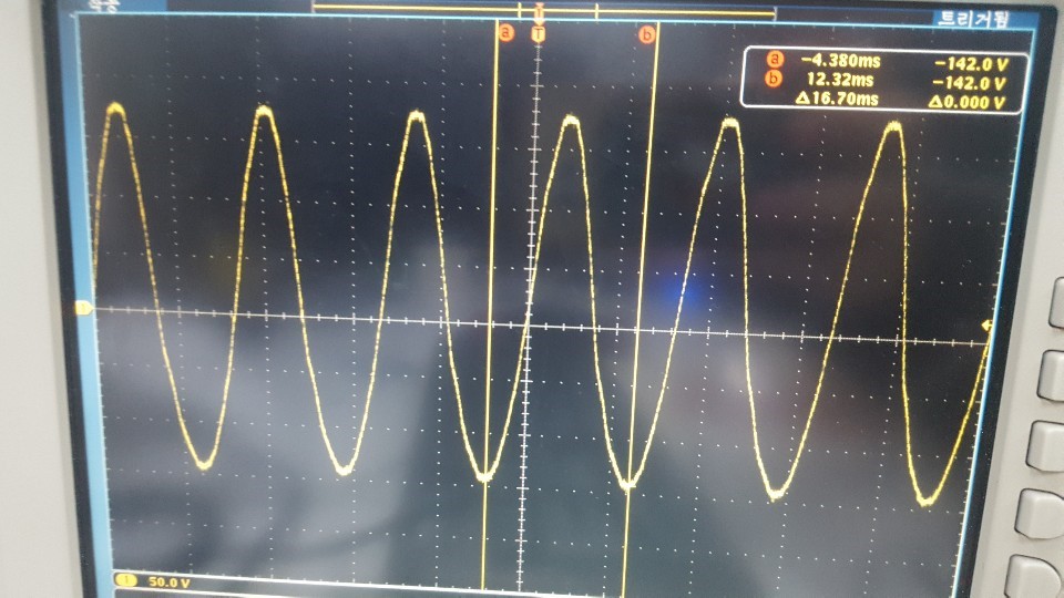

    I was able to get this waveform at DAC_OUT.

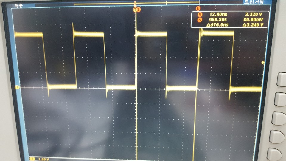

    And this is the 1Mhz clk that I supply to AFE4300.
    But Vref still low and RDY pin is always high.
  • I didn't read register since it reads register well. And i can get 60Hz sine wave at DAC_OUT. But Vref pin is still low and VLDO pin is still low too.
    Looking at the images, it is clear that AFE is not getting the CLK.
    Can you share the schematic of your board and check the connection of CLK pin to the board.
    The sine wave at the DAC_OUT is ~60Hz, so it could be AC mains frequency.
    Also MISC_REISTER3 should be written 0x0030 not 0x00C0.
