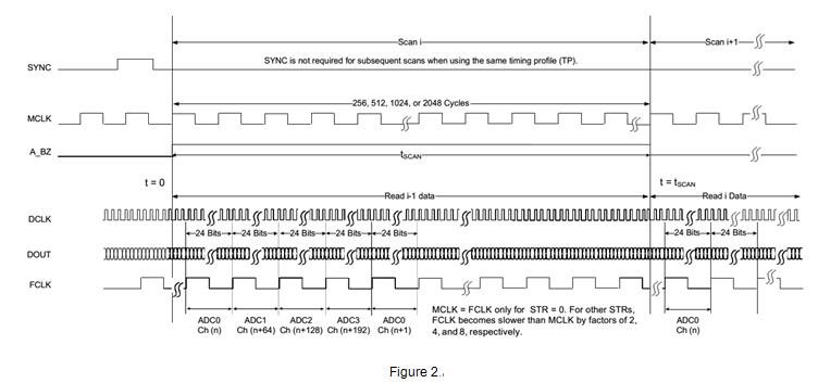

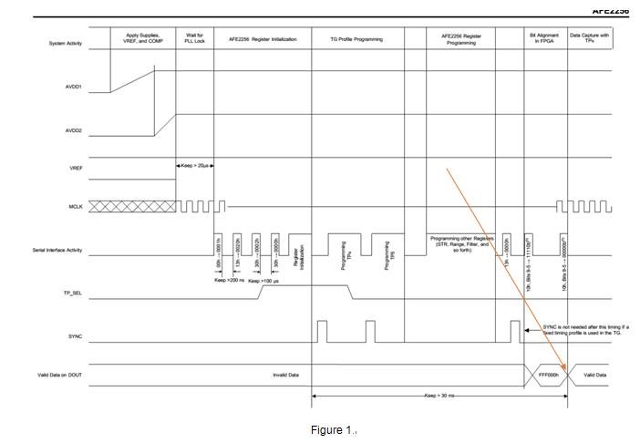

Questions about AFE2256
1) when the valid data be ready?
2)according to datasheet, when sync pull high then AFE2256 will do integral base on the cycle of 256x MCLK then output its result. Whatif another present within the un-complete scan-cycle, is the running data will be terminate as well?
