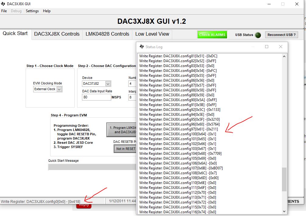

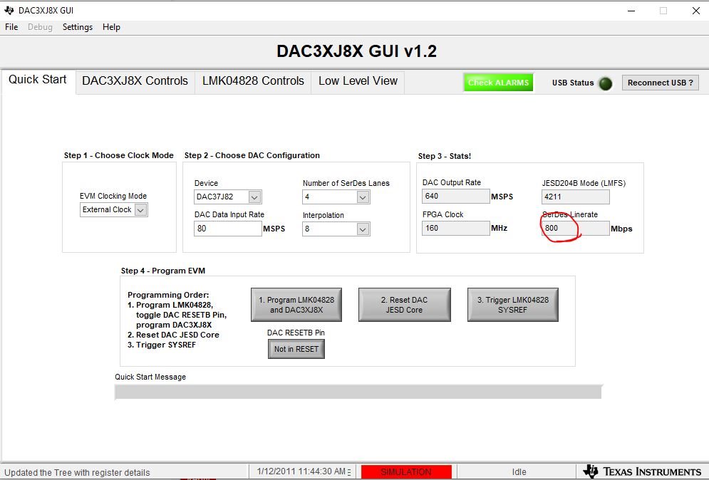

    I recommend that you use the DAC38J84 EVM GUI to generate the configuration files needed for your application.
    http://www.ti.com/lit/zip/slac644
    see below for my interpretation of your application.
    you mentioned linear speed is 1600M? I am not sure what you mean by linear speed. I am assuming line rate. Since you are only use 4211 mode with 2 DACs, you rate may be half at 800Mbps.
    you may generate the configuration file, double click on the register details, and right click to save into a text file.
