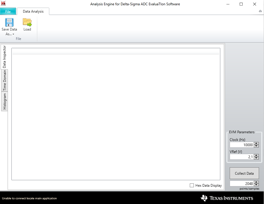

Hi Team,
I received the following request, could you help?
I have followed all the instructions in ADS1235EVM web page and documents. But below empty screens is not changed. I couldn’t use this product. Do you have any suggestion? I have 64 bit Win10 OS.

    My Windows accound is not in admin rights. When I start Delta-Sigma ADC Ev. Software in as administrator, it works properly.

  • The problem was related to admin privileges on Windows
  • Hi Chris,
    The first problem was "Hardware Not Connected" even if I installed ADS1235EVM-dvcpkg.exe and DELTASIGMAEVAL-GUI-installer.exe. Then I read manuals and installed BulkUsb_driver_install_x64-v1.0.0.1.msi in C:\Program Files (x86)\Texas Instruments\DSEvalSW\Drivers\Installers folder. After that, device is connected but registers couldnt be read. And I sent e-mail to Mr Soriano and then he opend this topic (thanks to him :) ).
    When I start Delta-Sigma ADC Ev. Software in non-admin rights, it can connect to device but cannot read registers.
    If I start Delta-Sigma ADC Ev. Software with admin rights, then it can read registers.
