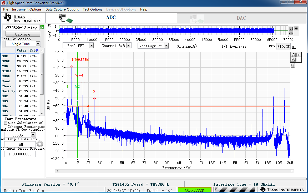

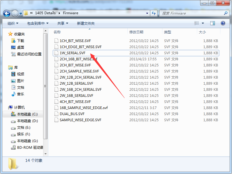

when I evaluated afe5809evm using tsw1405evm, I found that only ‘1W_SERIAL.SVF’ is available in the firmware. Now I want to develop a new firmware for myself to use. Who can provide relevant source code? Thank you!
could youplease see the firmware zip file here here?
Thanks!
http://e2e.ti.com/support/data-converters/f/73/p/711163/2623239#2623239?jktype=e2e

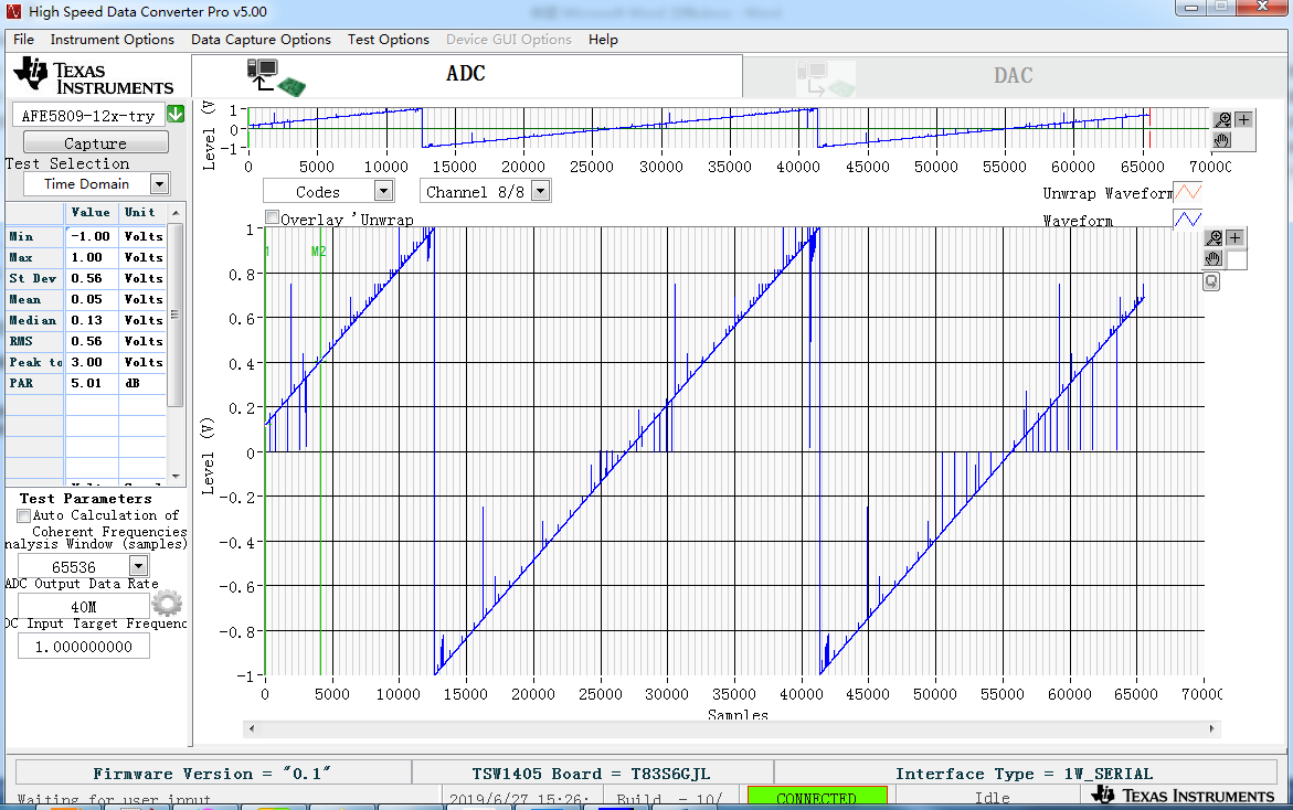

for 12x mode, you can use the ADS528x firmeware in the TSW1405. it should work as long as you play with LSB first, or MSB first. 2's comp and DC offset.
