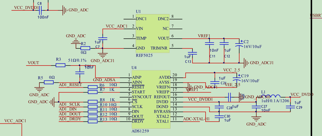

  • hi, Mr,
    last night ,i had read many question on ti e2e, cause i new to use ads1259.
    and i circuit was designed like below, /cs tied low level, and start tied to low level too, i use freertos and stm32f103 , use hardwre spi to drive the ads1259, use spi mode 1.CPOL =0, CPHA=1.
  • Hi Mr Chris Hall
    the /cs is designed to tied to low level ,is the design correct?
    i had read the datasheet ,the cs can be designed to tied to GND,

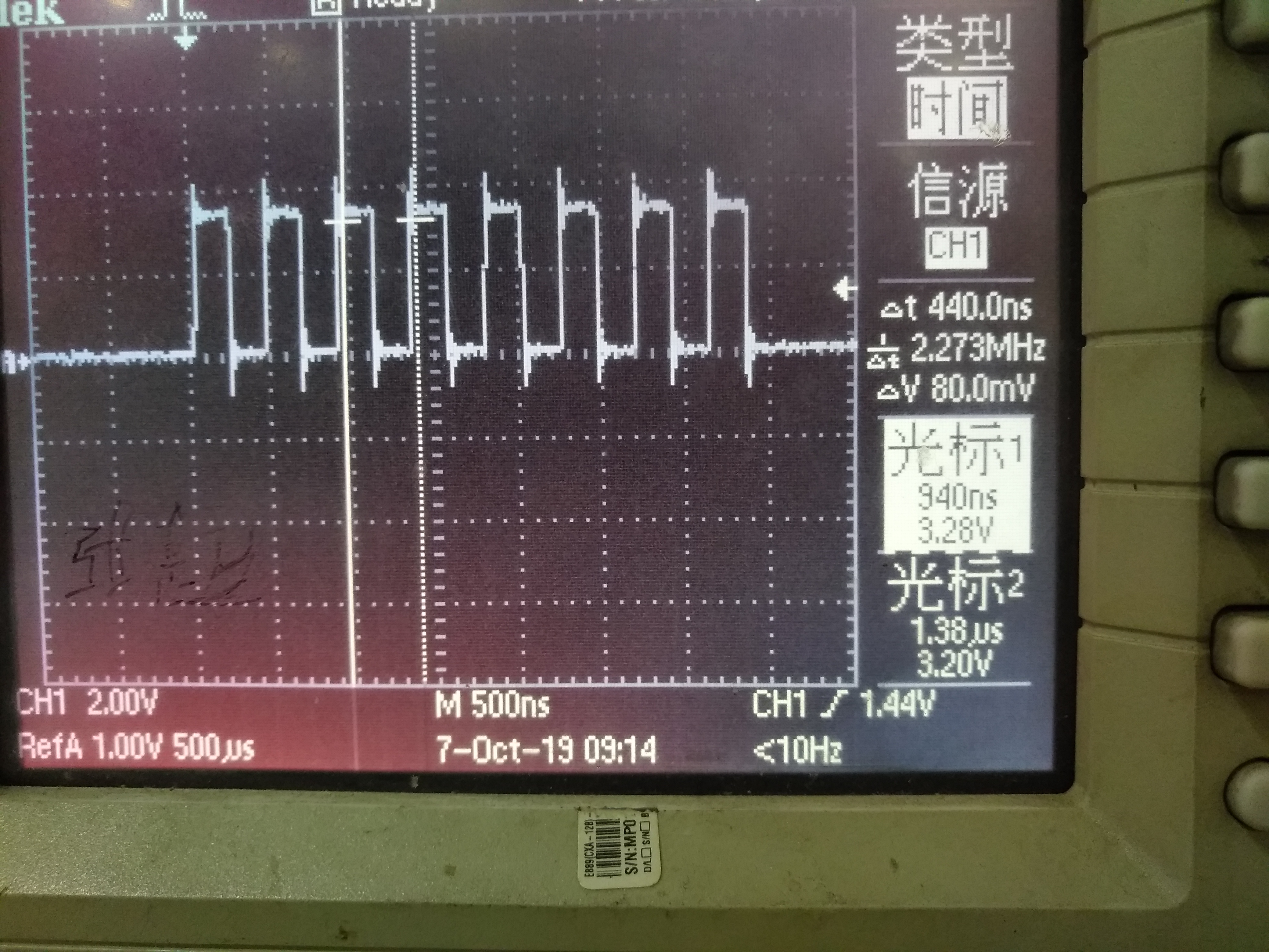

  • Hi mr Hall
    I have set the spi speed at 2.273MHz, and delete my delays between bytes (within a command), with out any write opcode,
    the result is all the same,

    i get the sclk clk pic: i think the mcu's spi peripheral is ok.

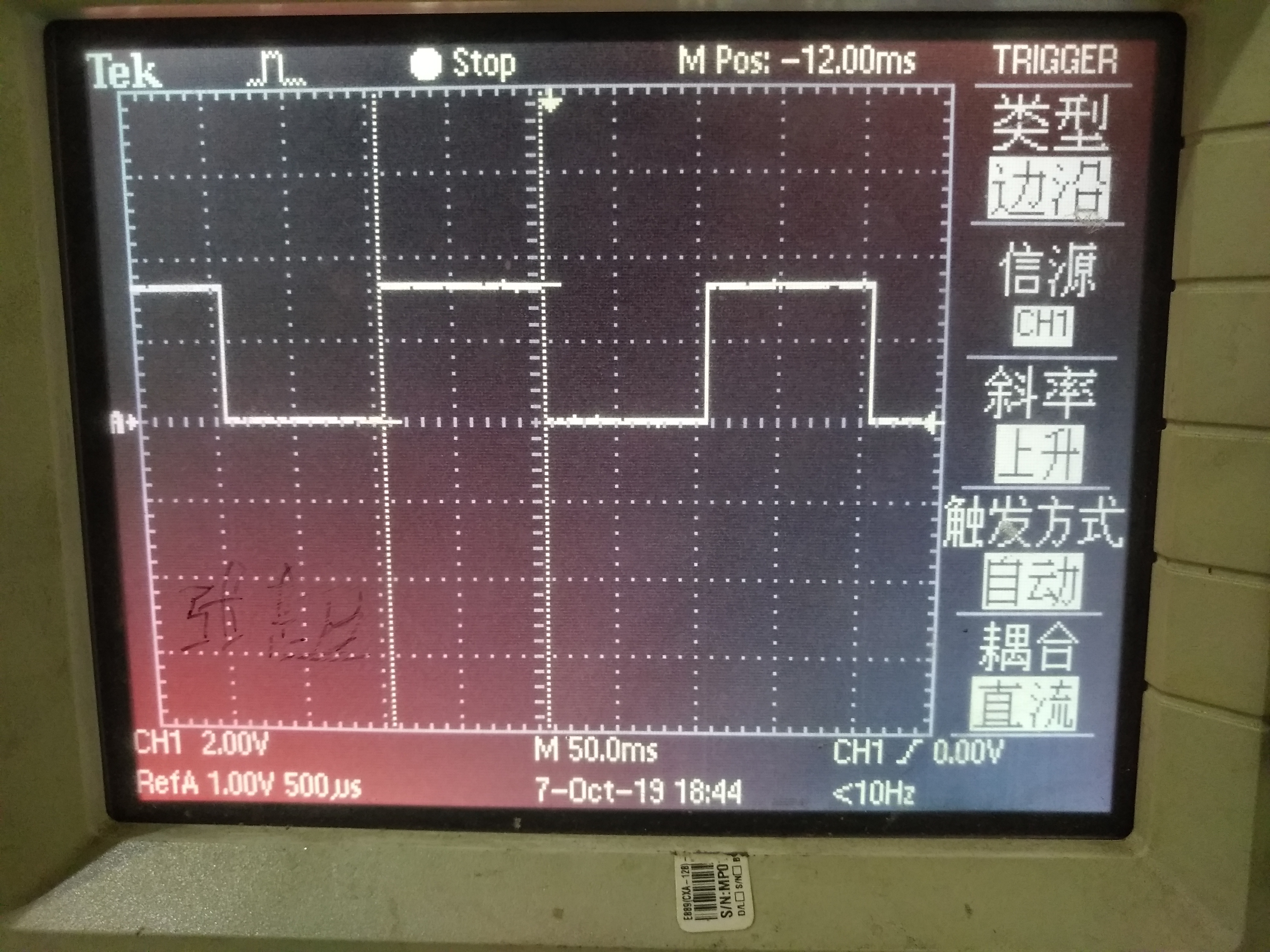

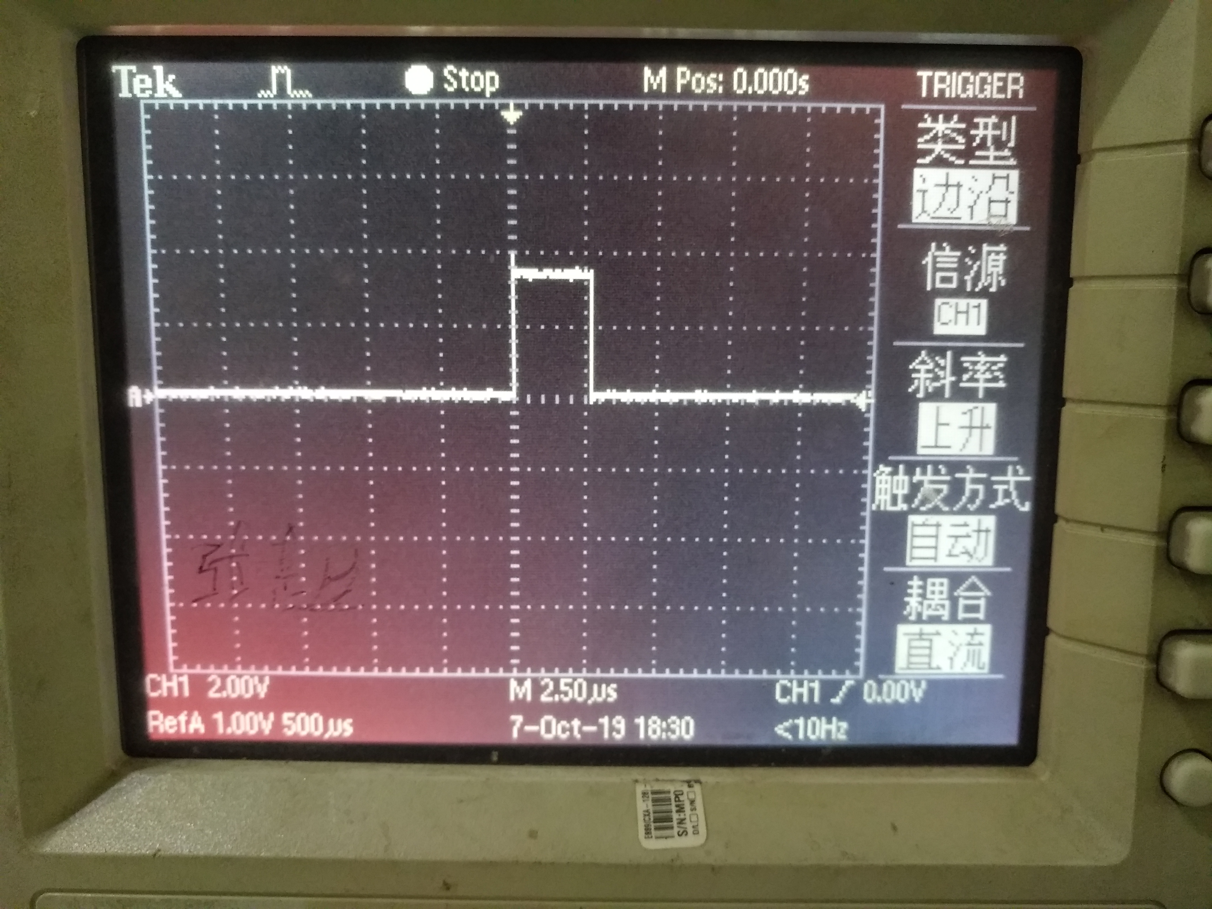

    and i get the the DRDY signal: the DRDY signal is 2.5us high level,
    and i use falling exti to sample the period of DRDY, i use toggle gpio to verify, i get the gpio wave:
    void HAL_GPIO_EXTI_Callback(uint16_t GPIO_Pin)
    BaseType_t pxHigherPriorityTaskWoken;
    if (GPIO_Pin == GPIO_PIN_4)
    //xSemaphoreGiveFromISR( BinarySem_Handle, &pxHigherPriorityTaskWoken );
    HAL_GPIO_TogglePin(GPIOD, SYS_LED_Pin);
    /* NOTE: This function should not be modified, when the callback is needed,
    the HAL_GPIO_EXTI_Callback could be implemented in the user file
    i can sure the falling edge is come out every 100ms,
    but as i know , i set in gate mode, and, set Data Read Operation in Continuous Mode after start convertion, in this test ,i just sample the falling edge of DRDY ,and do not read the adc value.
    ADS1259_INIT();
    HAL_Delay(300);
    ADS1259_Start();
    HAL_Delay(300); //add delay to wait ads1259 adc Settling Time

    Regarding your schematic, I do have a few comments and questions...
    • Tying /CS low is okay, but will require you to be a bit more careful with the SPI communication to ensure that you do not lose synchronization with the ADC.
    • What is the frequency of the external clock that is connected to the XTAL1 pin?
    • I would recommend removing L1 from the DVDD power supply as this may be creating an LC resonator and resulting in an unstable supply voltage.

  • Hello, Mr. Hall,
    1, I use the hardware spi to drive ads1259, it should not be affected by rtos. If it is a software simulation, it must be done with 8bit protection.
    2. The frequency of XTAL-H1 is 7.3728MHz.
    3, on the removal of L1 in the DVDD power supply, I will be instructed with the superior, because the hardware is already done.
