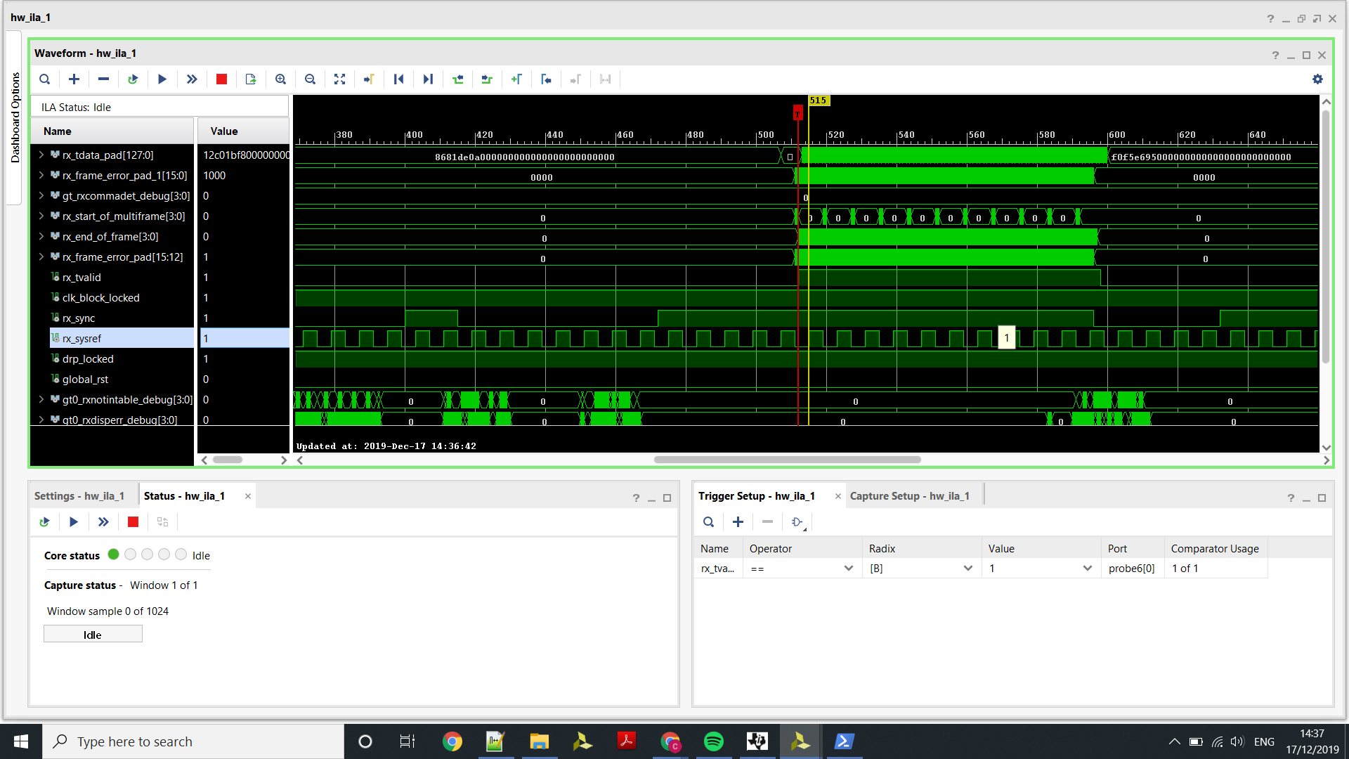

  • Hi Jim,
    So i'm understanding the protocol a lot better now and the more in understand it the less i understand why my stuff doesn't work!
    the data coming out of the PHY is wrong , and get a bunch of disparity errors. This is before any of the protocol stuff.
    i expect to see the K28.5 character of "BC" repeatably but i don't, instead i get garbage. the sync is low so its still in the CGS stage of initialisation.
    now what is interesting is if i invert the p and n pins in my FPGA device and tell the ADC jesd204b to send the K28.5 test pattern. i start getting a more repeatable pattern say "47" or "82" but its still not "BC" this i find to be very strange. sometimes i do see "BC" in the data but not reliably.
    if i hook up p/n the ways its stated in the user guide and turn the jesd204b interface on and off in adc gui , the transceiver just continues to give me garbage almost as if its not connected.
    however with pins inverted to what is stated, if i toggle the ADC's jesd204b on then i get a repeatable pattern and if i turn it off i get zeros which is more sensible.
    these are the pins i have assigned in my fpga
    set_property PACKAGE_PIN A3 [get_ports {x_rxp[3]}]
    set_property PACKAGE_PIN B1 [get_ports {x_rxp[2]}]
    set_property PACKAGE_PIN C3 [get_ports {x_rxp[1]}]
    set_property PACKAGE_PIN D1 [get_ports {x_rxp[0]}]
    set_property PACKAGE_PIN A4 [get_ports {x_rxn[3]}]
    set_property PACKAGE_PIN B2 [get_ports {x_rxn[2]}]
    set_property PACKAGE_PIN C4 [get_ports {x_rxn[1]}]
    set_property PACKAGE_PIN D2 [get_ports {x_rxn[0]}]
    this is what i believe to be correct when compared to the schematic but if i invert these it seems to look more sensible (although still not working).
    any ideas?
    here is the chip scope
    the SYSREF was turned off during this capture
    Charles
  • Charles,
    Try the following: Program the ADC to operate at the lowest sample rate. Next take a speed scope probe, and probe the serdes lanes using the capacitors on the bottom of the board near the ADC. With SYNC low, the K28.5 characters (0xBCBC) should be constantly coming out all of the lanes. This is pretty easy to observe with a scope probe when the serdes rate is low. See the attached document for what this should look like in 8b/10b mode. I have also attached a debug document as well that may help.
    Jim

  • Hi Jim
    Could you explain why the on the chipscope do i see "bcbcbc" and then on the next clock i get something like "bcbcff35" that makes no sense to me! it comes out as disparity error and "notintable" error and this is coming out of the jesd204b phy on the fpga so it before the elastic buffer which what the SYSREF is for.
    to me this points to there being an issue with serdes lines themselves, if i'm wrong i would really would like to know why i'm wrong!!! i'm getting so frustrated with this now.
    i did get this working the other week i cant for the life of me think what i did differently from what i'm doing now.
    here is another capture which shows when i occasionally get the jesd204b core to release data , although its wrong.
    the buffer delay is set to 0.

  • Hi Jim,
    i tried setting the buffer to K delay it made no difference.
    i'n not getting that far in the process what is currently happening i i get lots of random data on the line coming out the PHY.
    i then sometimes see SYNC go high but the quickly drop again as the data coming out is not "bc" all of the time like i would expect.
    my latest theory is there is something wrong with our xilinx eval board , i have another i can try will see if this fixes the issue.
    i think when the ADC and FPGA are attempting to do Code group sync i should only see "bc" on the line but im not seeing this , i see "bc" but mixed in with lots of other values i don't expect
    Charles

  • Hi Jim
    here are some captures that show it somewhat working this is closest i can get it , does these give any insight into what i'm doing wrong?
    Charles
  • Charles,
    I think you need to consult with Xilinx regarding this. I am closing this post now. If you still think you may need help from TI, please feel free to open another post.
