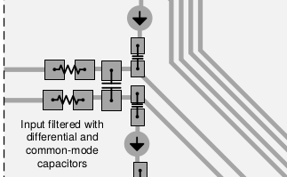

Hello. I'm working in a project with the ADS1298. My question is related to the RC filtering in each electrode input.
In the datasheet of the ADS1298 (page 99, Layout Example) you show differential and common mode filters (screenshot 1), however in the ADS1298ECG-FE User's Guide (SBAU171D, page 52) there are simple RC filters, two filters in cascade.
In the past, I implemented the datasheet scheme, with the differential and common mode filters with an aprox. 150hz cut off frequency to limit the signal at the bandwidth of interest for an ECG.
Now I'm working in a new implementation and saw the filtering used in the evaluation module, and came across with the question of why that filters have a higher cut off frequency (153 kHz with the 22.1k and 47pf, and 338 kHz with the 10k and 47pf) and, why you used that filters and not the ones in the datasheet?.
