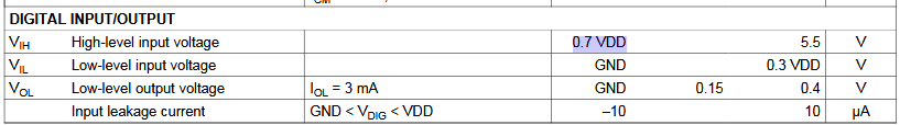

    I'd like to point out something from the datasheet. In the electrical characteristics table, you'll find the digital pin levels for the I2C:
    For an input, to guarantee the input to be registered as a high, the level is 0.7*VDD. For a 5V supply this is 3.5V, so tying the pull-ups to 3.3V, you don't guarantee communications. With this specification there's probably some margin, and I would guess that it would likely work, but it's not a certainty.
    I would check to see if the microcontroller has digital inputs that are tolerant to 5V, that way, you could tie the pull-ups to the 5V supply instead of the 3.3V supply.
    If that's not the case, you may need to use some sort of I2C voltage level translator.
