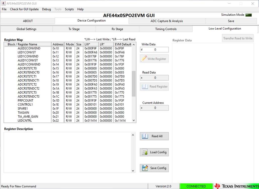

  • I have attached the screenshots of the registers.  I'm still looking for a solution.
    Andy
  • Hi Andrew,
    To get ADC_RESET signal on PD_ALM pin, you need to set "RST_CLK_ON_PD_ALM" bit. This bit is D16 of 0x23 register.
    Once you set this bit , you should get  pulses on PD_ALM pin with frequency" 4 times of PRF" (i.e. 4*500 = 2KHz).
    Similarly the signal on RDC_RDY pin will be same as PRF , so within a cycle of ADC_RDY signal there will be 4 pulses of PD_ALM pin.
    Also, the 4 pulses of PD_ALM represents the start of 4 convert instances in a particular order as LED2_CNV, AMB2_CNV, LED1_CNV and AMB1_CNV.
    Now if you use pulses on PD_ALM pin to start conversion in an external ADC, then the 4 data  will be in order LED2, AMB2, LED1 and AMB1.
    Prabin.
