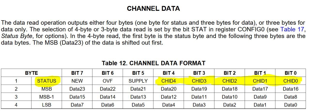

i am making a spi_master for the ads1258 to read the data in direct channel read(No command ) .
i have some questions..
1. if DRDY getting into low if i send sclk on first falling edge DRDY move high . Then how many sclk clock should i send to slave for i need to read all 29 channel in direct data read (no command). Where sclk i am giving 12.5 mhz.
2. the DRDY moves to low for every 1 channel for all 29 channels .
3.then How the DRDY will signal works
