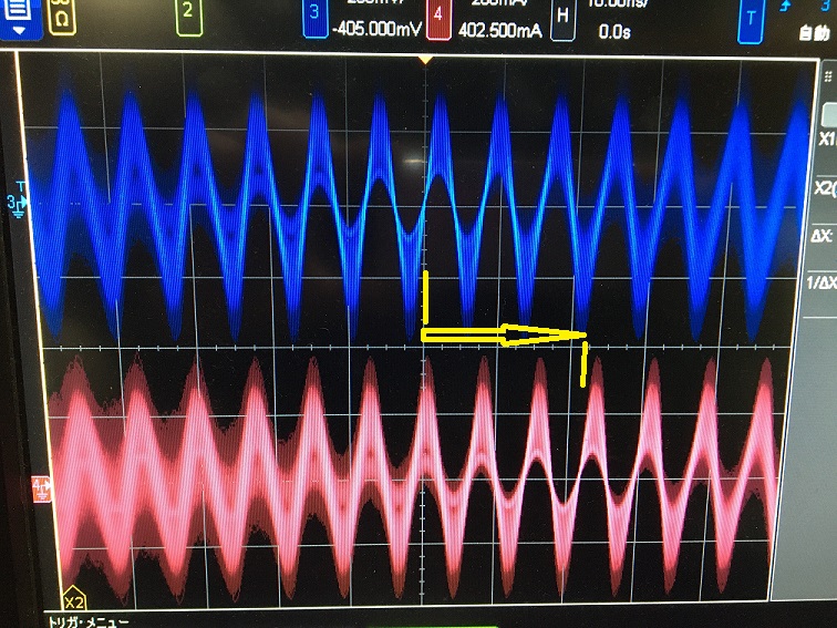

My customer is facing a strange behavior that output delay about 20us sometime.
The delay has been observed 1/10 ~ 1/100 times start-up. Their fifo sync configuration is as below.

Waveform is here
If you need other information, please let me know.

    The difference in time delay between blue curve and red curve, are they between two different DAC3482 or two different channels of 1x DAC3482? The FIFO slippage will explain the situation of 2x DAC3482. If it is between two channels of DAC3482, then it is the setup/hold time of data with respect to DATACLK that need to be adjusted.

    Data clock is 100MHz and word mode, so the system doesn't have about 20ns clock. So I don't understand reason why output shifted about 20ns. Do you have any idea why 20ns slip?
    Blue curve is reference which uses the same input and clock, red is a device slipped output.

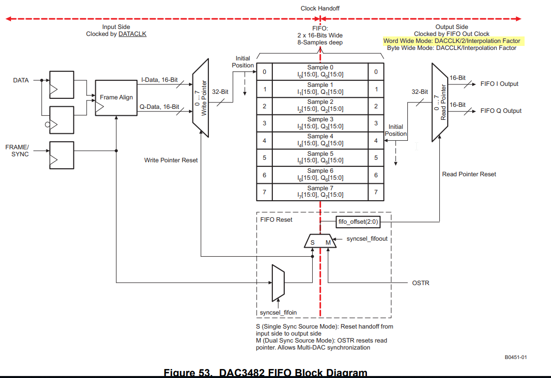

  • Hello Katsu-san,
    The FIFO slip on the sample is related to the FIFO_OUT_CLK. In word wide mode, it will be DACCLK/2/Interpolation or DATACLK/2. For 100MHz DATACLK, it will be 100MHz/2 = 50MHz
    Please see the plot with highlighted area.

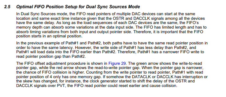

    Since you are using dual sync sources mode, the FIFO-offset need to be tuned to ensure optimized deterministic latency.
    Please advise the delay variation is when compared between two DAC? If it is one DAC, then there should not be any concern for deterministic latency. If it is two DACs, then you will need to tune the FIFO offset to ensure deterministic latency. This is discussed in section 2.5 of the app note mentioned above.
