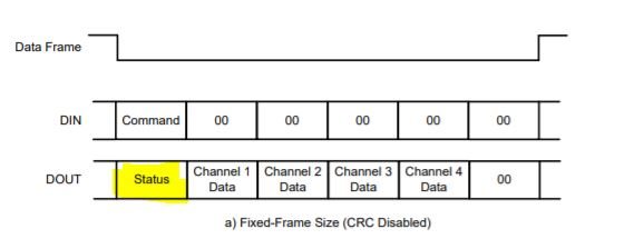

Hi Experts,
ADS131A02 outputs the flame data starting STATUS words. Can we remove this STATUS data?

Uchikoshi-san,
For any command or data read, there is always a response word reported at the beginning of the frame. For the read of the data using a NULL command, the response is the STATUS word. There is no way to remove this to only report the data.
