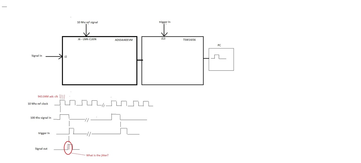

    One other question concerning the ADC board - ADS54J40EVM:
    1. Does the input transformer circuit is matched to 50 ohm source input?
    2. We want to synchronize the ADC with 10 Mhz signal source. When doing it is the signal-in, that also synchronized to the 10 Mhz ref clock
        will be synchronize to the ADC clock of 943.04 Mhz. (see attached drawing)
    3. When using the trigger in ( J13 on TSW14J56) what will be the jitter of the signal out (the sampled signal in by the ADC) between trigger in pulses)

    In question 3 I meant:
    If the signal input to the adc board (J2) and the trigger input to J13 (EXT _TRIG) on TSW15J56 are all synchronized to the 10 Mhz ref clock (J6 on adc board)
    Giving a single shot trigger on the EXT_TRIG and capture the signal input - let say that the signal input is a rectangular pulse - and on the PC GUI
    the pulse is started at clock 1000.
    Now a second trigger is given and we capture again the signal input.( It is the same signal as the first one with the same relations between the signal input the trigger and the 10 Mhz ref clock.) My question is the captured rectangular pulse will also start at clock 1000 on the PC GUI or will it has a jitter?
    Giora
  • Giora,
    If the trigger is synchronized to the 10MHz reference and an integer factor of the local multi-frame clock (LMFC), then the start should be the same for each capture.
    Jim

  • Giora,
    Not the 10MHz reference, the trigger must meet this requirement. The LMFC will already be synchronized by the 10MHz. LMFC calculation attached.
    Jim
