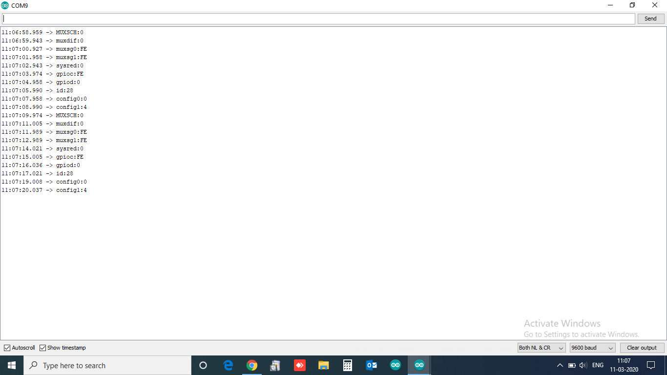

    > Found following results which are not matching for most of the registers.
    Please refer the attached image file for register status.
    Either I am not able to write data to registers correctly or read it correctly. Please share your views on this problem.
  • Hi Maharudra,
    How are you configuring your SPI peripheral?
    I would double check that your MCU's SPI peripheral is configured for SPI mode 1 (CPOL = 0 -> SCLK is low when inactive, CPHA = 0 -> data is valid on SCLK's rising edge) and that the SCLK frequency is no faster than 0.5 times the ADC's master clock (refer to tSCLK requirement on page 7 of the datasheet).
