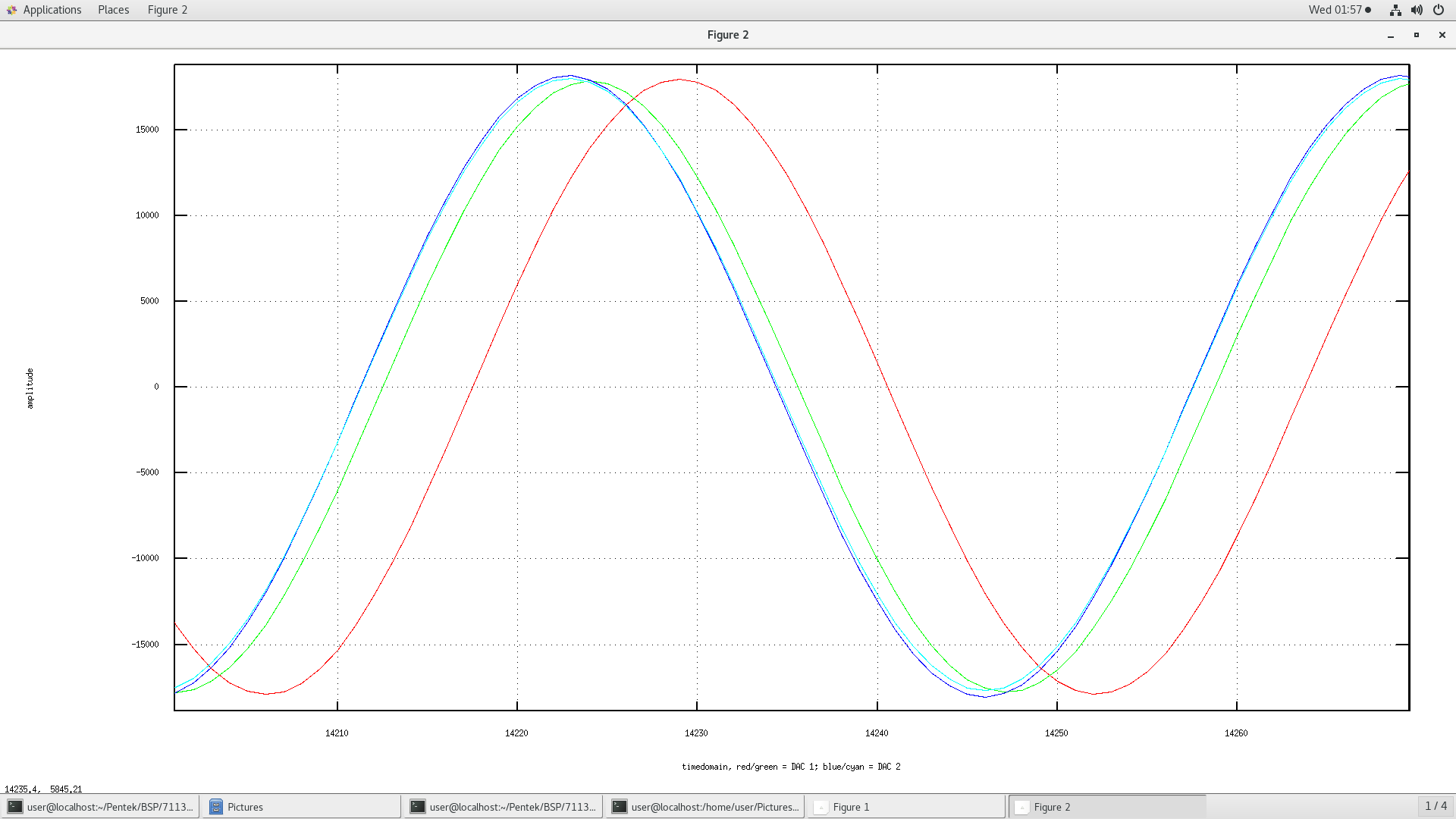

I am using the dual-sync source mode. I can basically get the two DAC output waveform "basically in sync", but still have some minor issues:
1). sometimes ch 1 and ch 2 are in sync; ch3 and ch4 are in sync. but ch1 and ch3 have 1~2 samples apart.
2). sometimes ch2,3,4 are in sync, but channel 1 are out of sync. as shown in the picture below.
I also enclosed the DAC3484 register dump before and after I set the DAC3484.
Would you enlighten me what can be wrong in my setting here? my requirement is to get all four(4) channel(from two DAC devices) output waveform phase-aligned.
Thank you.

    You may refer to attached app note for detail. Most likely you will need to re-adjust the FIFO based on empirical data. See section 2.5 particularly.
    http://www.ti.com/lit/an/slaa584/slaa584.pdf
    -Kang
  • Hello Kang,
    Thank you for your reply.
    I read through your appnote (slaa584.pdf), and it is quite helpful in understanding the dual sync mode.

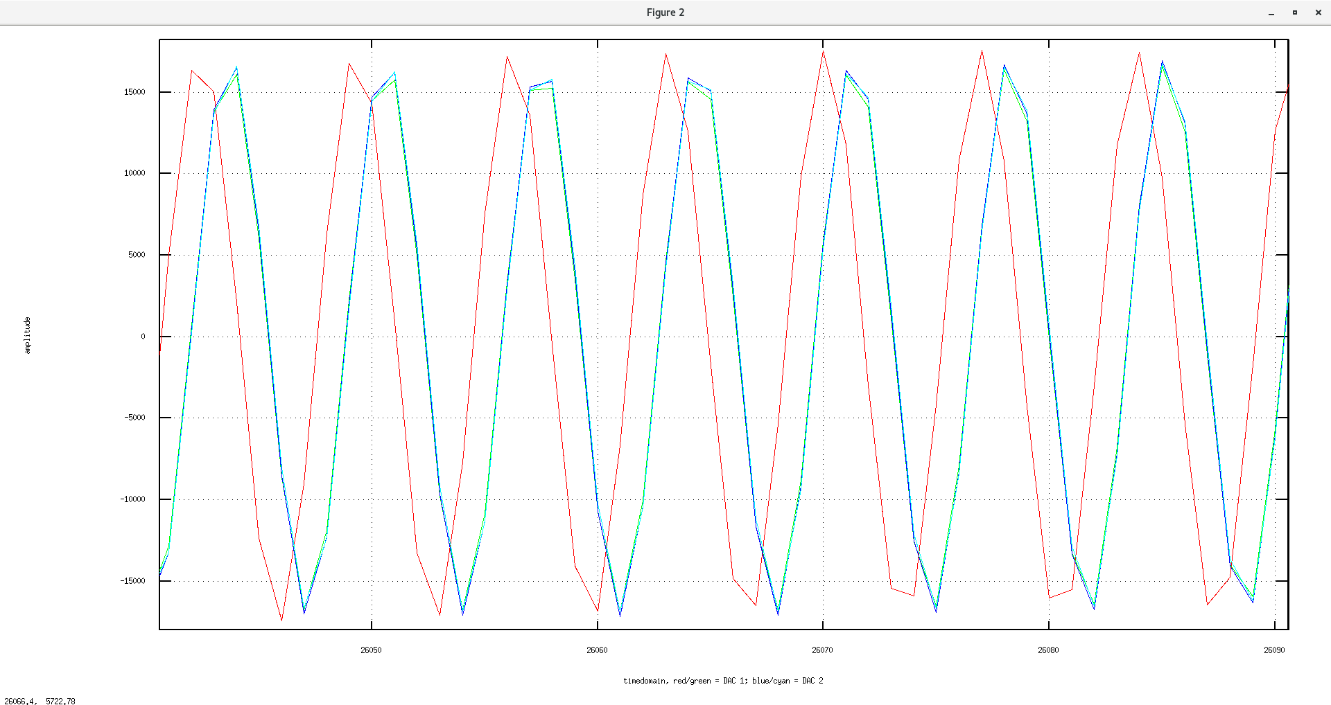

    I tried adjusted my register settings, but the issue persists. the issue now is:
    1). sometimes ch 1 and 2 are in sync; ch3 and 4 are in sync, but ch 1 and ch3 may be offset by 2 data samples.
    2). sometimes ch 1,2,3 are in sync(phase-aligned), but channel 4 are out of sync by 1~2 samples.
    3). sometimes ch 3,4 are in sync, but channel 1 and 2 are offset by up to 6 samples. (see enclosed picture)
    I also enclosed my register dump here before and after setting the DAC3484. Would you please give me any advice any setting wrong here?

  • Hi
    By design without additional care, the channels within 1x DAC3484 device will be synchronized. The fact that you are not seeing consistent output phase on even one DAC device indicates that your input pattern from the FPGA is not source synchronous. I do not think this is a DAC issue. Please double check on your FPGA, or even send out constant patterns to check the alignment on the data source.
    Please also clarify which channel is which device. I would like you to first focus on getting stable synchronized channel on the two channels of 1 device, and then another two channels of another device. You may then proceed with synchronization of two devices.
    -Kang

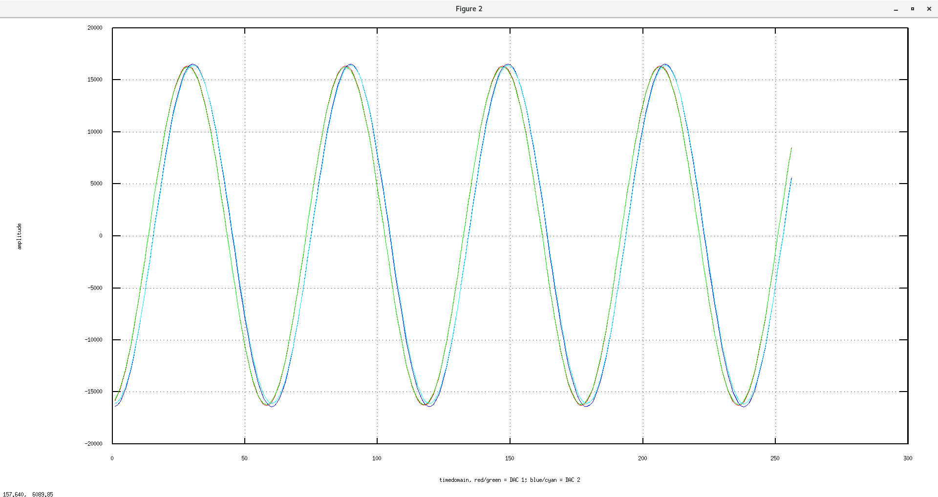

  • Hi Kang,
    Thanks for your reply.
    I should update you today after giving proper SYNC signal to each DAC device, I am able to get DAC 1 (ch1 and ch2) in sync. the waveform overlap perfect.
    DAC 2(ch3 and ch4) also overlap. (please see below plots).
    However, there is an offset of 2 samples between ch1 and ch3 most of the times; sometimes it becomes 6 samples.
    Please would you advise what can be the reasons why they jump between 2 samples and 6 samples? I will appreciate if you can advice on my questions in previous post. Thank you.
  • Hi
    guodong mei said:
    1).As per your appnote start up sequence, the data will fill into the FIFO first, then reset the Read Pointer through OSTR. after which the TX_ENABLE is set to High in order to output waveforms.
    I have two DAC chip, hence need to set the TX_ENABLE respectively to each DAC chip one by one through software. from this perspective, will it cause the DAC output waveform phase offset?
    TX_ENABLE is asynchronous to the FIFO and ISTR/FRAME/OSTR. It only enabled the DAC core. The latency of the device is completely controlled by ISTR/FRAME/SYNC/OSTR
    guodong mei said:
    (c): open Gate to write data into DAC FIFO.
    I am not sure what you mean by GATE. If you are gating input data, then you may have some problems. The assumption is that you are aligning data at the input side also with ISTR/FRAME/SYNC signal
    guodong mei said:
    3). as described in 2). my test results are most of the time the offset is 2 data samples, sometimes it can be up to 6 data samples. I am not sure if this is because the FIFO depth is 8 samples so one channel is delayed by one complete 8 samples? but how could this happen since my GATE and OSTR are given simultaneously ?
    how are you controlling the ISTR/FRAME/SYNC? You will need to control both the input FIFO pointer reset and output FIFO pointer reset to ensure deterministic latency.
    -Kang
