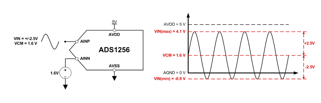

I have an ADS1256 that I want to use to measure microvolts amplitude signal ~5 uV pk-pk. According to the datasheet, with a data rate of 2000SPS and PGA = 1, the Input Referred Noise (μV, rms) with Buffer Off is 4.025 uV which according to a thread I've read is the  minimum voltage that the ADC can measure. I'm also a bit confused about the meaning of the full-scale range. When for example it says FULL-SCALE INPUT VOLTAGE VIN(1) (VREF = 2.5V) = ±78.125mV for PGA = 64 is this range from 0 to 156.25 mV or from 2.5V to 2.65625. Because my original small signal (~5uV pk-pk) was centered at 0 so I had to level shifted it so that it can be read by the ADS1256. The problem now is that the level-shifted signal isn't centered at 2.5 V or 78.125mV. The offset varies in terms of the input voltage. For a +/-2.5 V pk-pk signal, the level-shifted signal is centered at 1.6 V.

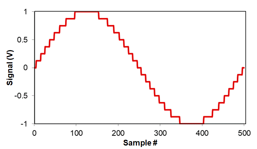

    You are correct, the noise reported in the ADC datasheet (you are referring to Table 4) is the minimum ADC code resolution. If the ADC noise was 4 μVRMS and you applied a 0.4μV signal, the ADC could certainly read this input but wouldn't necessarily be able to distinguish it from a 0.8μV signal for example. Or, if you were trying to measure a 16μV signal and a 16.1μV signal, the ADC would not have enough resolution to determine that these signals were different, so they would both be grouped into the same code bin. You can reference our Precision Labs training for more information on this topic, specifically modules 4.2-4.4

    In your example, the full scale range given VREF = 2.5 and PGA = 64 is ±2*2.5 V / 64 = ±78.125mV as you noted. This sets limits on the VIN range you can apply to the ADC, where VIN = AINP - AINN. If AINP = 2.5V, then AINN must be somewhere in the range of 2.5V - 0.078125V and 2.5V + 0.078125V. If your VREF voltage and PGA gain were different, the FSR would be different as well. But the FSR is always determined by this equation.
    If you are using AVDD = 5V with buffer = OFF, the absolute value of your input signals must be > -0.1V and <5.1V. That means you could apply 0V to AINP and 1V to AINN such that VIN = -1V. But you could not apply -1V to AINP (or AINN) and 0V to AINN, since the ADS1256 cannot accept voltages below AGND
    Now, since VCM is the same as the absolute input range on the ADS1256, that means your signal VCM can be anywhere in this range as long as the other conditions are met (FSR, AIN range, etc). Taking your question about ±78.125mV - it is possible to have inputs as extreme as AINP = 0V and AINN = -0.078125V all the way up to AINP = 5V and AINN = 5.078125 V, since there is some small headroom beyond the supplies with buffer = OFF. However, any variation in supply/input/VREF voltage might shift these values outside of the ADC's datasheet specs, and is not recommended. This is simply to show what is possible given the wide VCM range on the ADS1256. If you had a ±2.5V signal centered at = 1.6V, this yields absolute input voltages of 4.1V (max) and -0.9V (min). This is not allowable as you can now see.

    The first image below is how I would expect your ADC connections and signals to look like given the +/-2.5V signal centered at 1.6V. If I made any incorrect assumptions, please let me know. Your VCM signal is with respect to AGND, so this is 1.6V above AGND as shown in the plot on the right. As the signal swings to -2.5V, you would apply -0.9V to the ADC input, which is not allowed.

    The second image below represents a digitized sinewave. The ADC noise (resolution) represents the width (not height) of each "stair". So it effectively determines into how many pieces (codes) you can break the input signal. As you can imagine, a lower resolution ADC would have much wider "stairs", and the resulting digitized signal would not look much like a sinewave at all. Again, please refer to the Precision Labs modules for more info on this topic.
