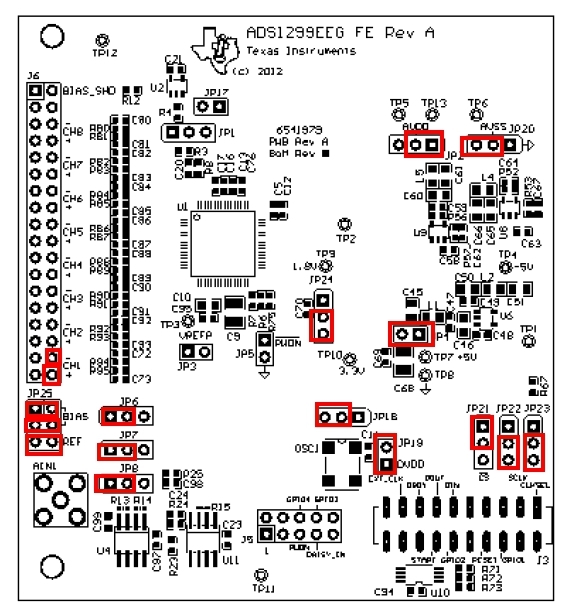

    The following picture shows the jumper settings of ads1299
    Image source: modified from TI ads1299 USER GUIDE
    I would connect the signal generator positive lead to one side of a resistor (anything small is fine, 1k), with the negative signal generator lead and AGND connected to the other side of the resistor. Then, connect VINP to the side of the resistor with the positive lead, and VINN to the side of the resistor with the negative lead and AGND.

    Indeed there seems to be a problem here. I see that you have the SRB1 switch closed. This connects the SRB1 pin to all negative input channels. More than likely, SRB1 is floating, hence the measurement issues you are seeing. Try writing 0x00 to MISC1 and see if that helps.
