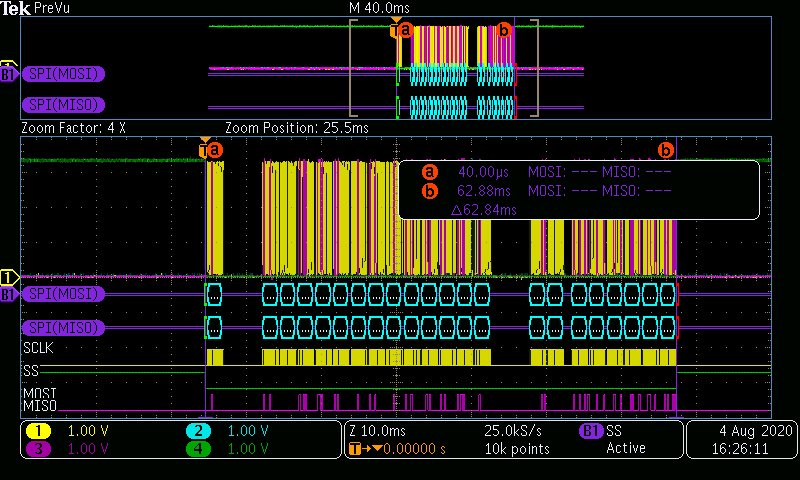

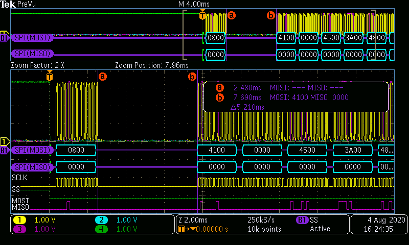

  • Hi Bob B,

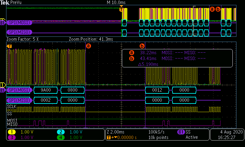

    As per your suggestion we observe SCLK and DIN on oscilloscope and below is image of that. we observe spike on SCLK and DIN. We also observe spike on DIN when nothing is transferred to ADS114S08.
    with this i want to add that first we are sending 8-bit  data for configuration of ADS114S08 that does not work and after that we changed it to 16-bit  data for configuration of ADS114S08 which works fine. So we want clarify that is there any difference if we configure ADS114S08 with 8-bit or 16-bit data. Because in datasheet they clarify it.
    Thanks and best regards,
    Jehan Patel
  • Hi Jehan,
    It appears that you are picking up significant noise on the communication wiring.  Noise on SCLK will be very problematic as this will cause an extra clock causing an issue with decoding of the command within the ADS114S08.
    The communication is byte oriented for the ADS114S08.  You can send multiples of a byte (such as 16 bits) without issue, but it is unclear as to what you mean by sending 8 bit data for communication that does not work.  Can you send me scope shots of each type of communication so that I can compare to see what may be different?  Unless you are now using CS on the device instead of holding it low.  If you attempt to use the SS pin on the SPI peripheral this will be an issue as the communication must hold CS low on the ADS114S08 for the entire communication transaction.  The SS pin would toggle in 8-bit mode every byte which would then cancel the communication.  It is better to control the CS pin with a GPIO instead of the peripheral for cases where more than 2 bytes are sent such as when using the RDATA command.
    Bob B

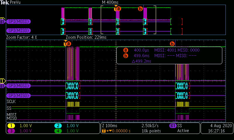

  • Hi Bob B,
    1) After Implementing all your suggestions we reading analog signal(1mV) from channel 0 and 1 by setting gain of 16 and Data rate of  4000 SPS (0x0E in Register 4).we are getting desired reading through RDATA (0x12) command but after sometime result goes to zero and again it goes to our desired reading. during this REFOUT is contant 2.4975V. So what is cause for this zero reading...
    2) after that we set gain of 32 and Data rate of 20 SPS  for that we getting zero reading for same analog signal (1mV) .
    3) sometime after writing into registers and read them back for verification we getting zero value for all configured registers.
    Jehan Patel

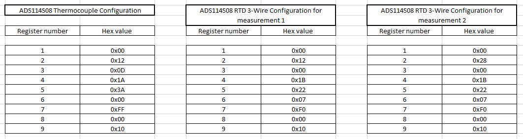

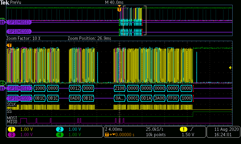

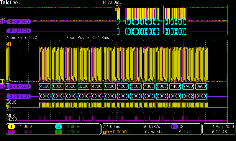

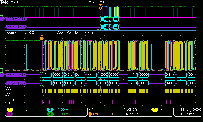

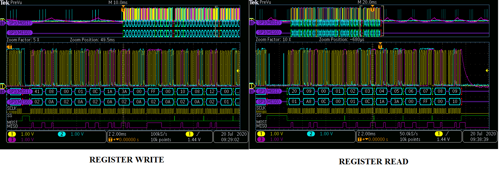

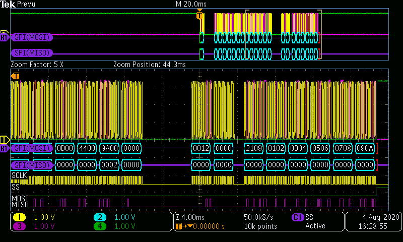

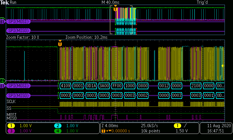

  • Hi Bob B,
    thanks for your quick reply and all suggestions.

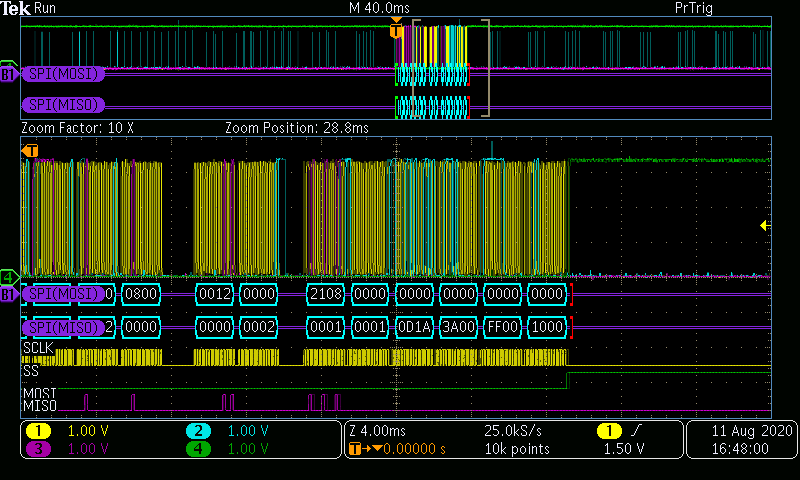

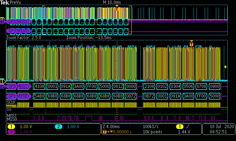

    1)  Here is image of configuration of ADS114S08 via 8-bit data and 16-bit data. first image is for 8-bit and second for 16-bit data transmission. as there any difference  if we use 8-bit or 16-bit.
    Here is link (http://ww1.microchip.com/downloads/en/DeviceDoc/70005185a.pdf) for SPI configuration we have used. Go to page-8 SPI Control register 1, in that MODE16 bit 1 or 0 create problem or not. We have used CKP & CKE = 0.
    2) During reading of analog signal from sensor, device earth where sensor mounted create problem or not for measurement.
    Jehan Patel
  • Hi Jehan,
    The problem with the byte length communication is where CS goes high.  If CS goes high in the middle of a communication then the command will cancel.  Also, you could potentially have the same kind of issue with 16-bit communication, but it so happens that CS is changing on an appropriate boundary.  Here is what is incorrect with the 8-bit communication:
    Note that I have placed X where CS should not toggle and be held low.  I also added a | where it would be the correct place to toggle CS.  If you are manually controlling the action of CS then you should make sure that it toggles at the correct time.
    Regarding '2', it is quite possible that you could see noise from a ground loop if the sensor earth ground also connects to one of the ADC inputs.
    Bob B

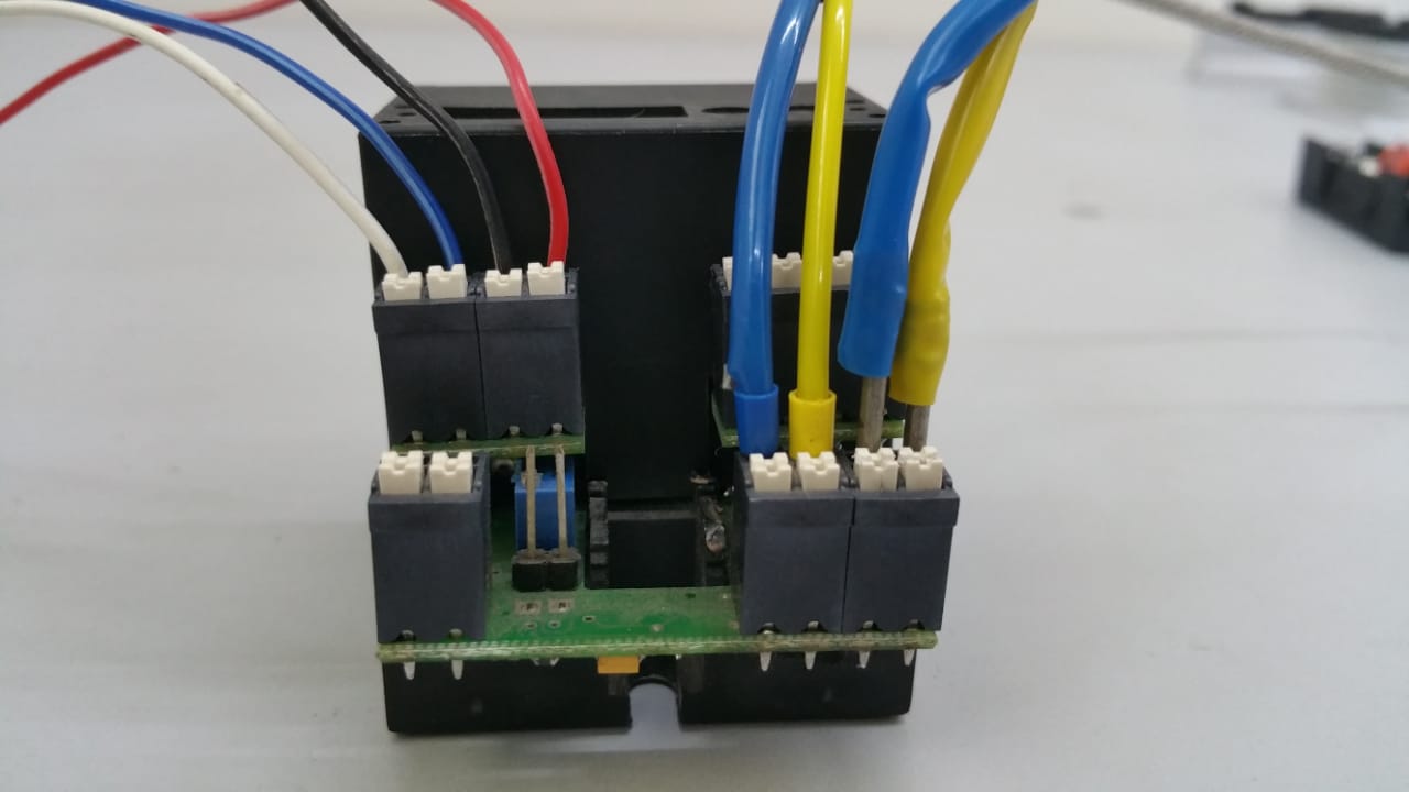

    Is it possible for you to send a few pictures of your setup so I can verify other potential issues with your setup?

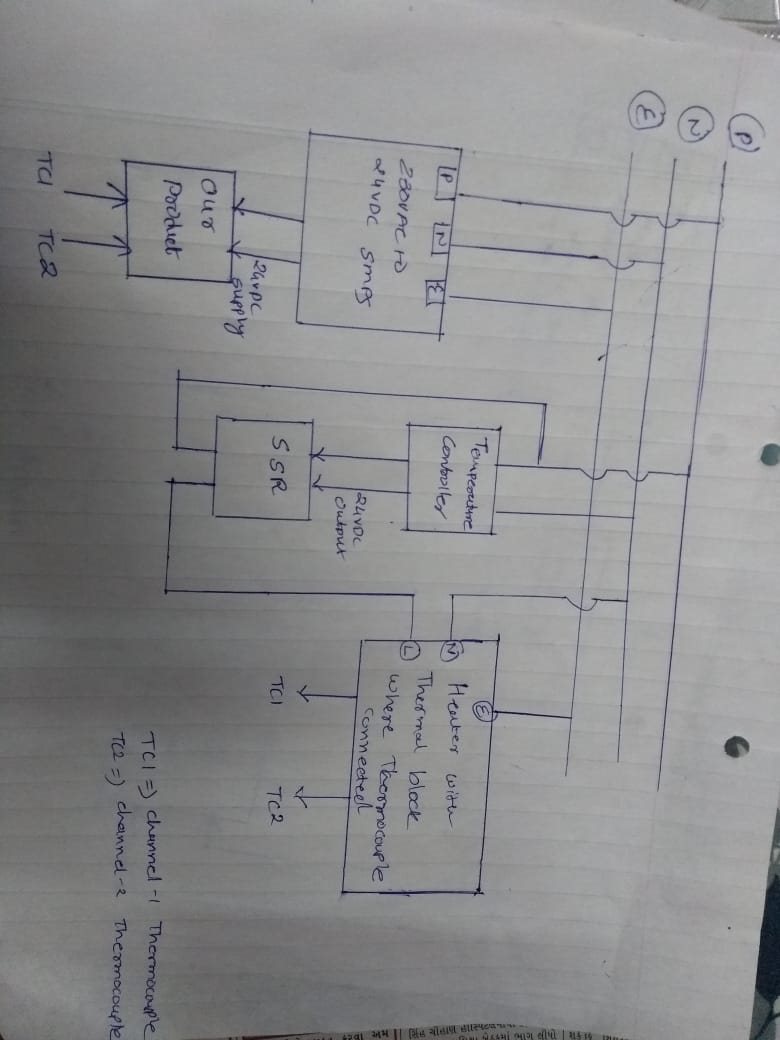

    Regarding missing capacitor concept, we have connected 10uF capacitor where datasheet suggested value for capacitor is1uF to 47uF.
    Please find attached image of thermocouple setup and earth connection give to system.
    We already checked all connectivity for earth connection it is found to be ok.
    Redarding 3.3VDC and GND supply, We are using isolated regulated 24VDC to 3.3VDC supply so it is not relevant to earth connection any how.
    so all connection are perfect. All voltage value are also ok.

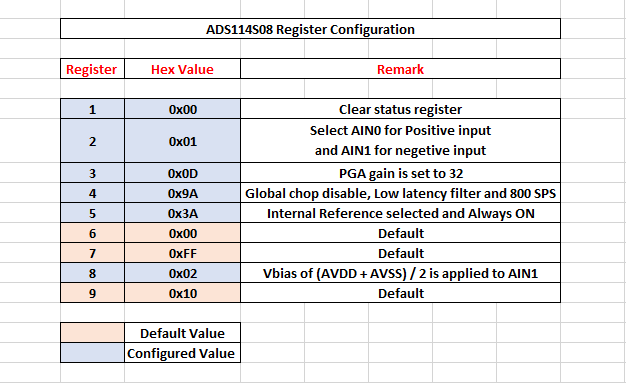

    • All register settings being used

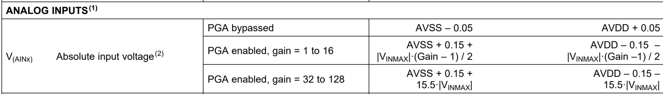

    As I explained before, if you are using the PGA then the input must be at least within the input range of the PGA.  If the earth ground places the TC connection at the same point as AGND, then you will be outside of the input range of the ADS114S08 with the PGA enabled.
    If you have a long wire connection between the TC and the earth ground, then this wire will be highly inductive and even though from a DC perspective may seem to be stable, the wire itself is highly inductive and susceptible to AC noise pickup the same as an antenna.

    1)      Shielded cable connected to the thermal block is Grounded J Type Thermocouple
    2)      Connected clip 2nd connection is connected to earth.
    3)      Wire connected to center of the thermal block is another Grounded J type Thermocouple which is connected to control system. So it not relevant to our measurement system anyhow.
    From your query please find other details required to you is as per below.
    1)      “As to how the inputs are connected from the TC to the ADC inputs (pictures and explanations would help here as well)”
    2)      “A detailed schematic with what you are using for antialiasing filters at the inputs”
    3)      “Information as to how you are setting the common-mode for the TC”
    -          Sorry but did not get your point. Please explain in detail
    4)      “All register settings being used”
    -          We want to measure thermocouple data for 2 different channels (AIN0-AIN1) and (AIN2-AIN3). Please find attached image Config.JPEG. We have implemented this sequence in SPI code in MCU. And it showing ok on oscilloscope. You can find previously attached images for more details. And as you know CS pin is permanently low so there is no any requirement of CS pin waveform.
    5)      “Raw data (hex or decimal but hex preferred) but not converted to a voltage value for at least 128 to 256 continuous and contiguous (every completed conversion sample with no conversions being skipped) data conversions”
    -          Please find attached excel for more information

    7)      “As I explained before, if you are using the PGA then the input must be at least within the input range of the PGA. If the earth ground places the TC connection at the same point as AGND, then you will be outside of the input range of the ADS114S08 with the PGA enabled.”
    -          As we know J type thermocouple maximum voltage range is 69 mV. For PGA enable and gain value 32 this range is cover in ADS114S08. It is not out of the range value. Also we have measured thermocouple voltage before connect to PCB and it is as per the current temperature of thermal block.

    • How are you determining when to read the conversion results? (For example, are you monitoring DOUT/DRDY, using a timer, etc. And if you are monitoring DOUT/DRDY are you polling the result or using an interrupt driven system to read the result?)
    • Do you read the data direct from the ADS114S08?  Or are you using the RDATA command?
    • Do you have access to a logic analyzer to monitor the signals MISO, MOSI, SCLK during the capturing of data? This would be important for me to see the actual timing of data collection and to determine why and when the data is changing.
    How are you making the measurements?   Are you using a method similar to shown below?
    1. Configuring for measurement 1
    2. Waiting for the result and reading it
    3. Changing the configuration to measurement 2
    4. Waiting for the result and reading it
    5. Repeat back to 1
    • When you change the from measurement 1 to measurement 2, are you just writing the change of the input mux, or are you writing the whole configuration again? (You only need to write the mux input change, and in fact if there is an issue with communication the PGA gain setting may be changing inadvertently where the gain of 32 may be changing to a gain of 2 or 16 which would result in a varying output code. )
    Let's discuss the input range as it relates to point 3 above.  The ADS114S08 has a limited input range as given in the Recommended Operating Conditions in section 7.3.  This is specified relative to AVDD/AVSS and PGA gain.  For a gain of 32 it appears as follows:
    Note that the TC is a floating voltage and relative to the ADC input could float to any value including outside of the analog input range.  If the TC becomes grounded relative to AVSS, note that this is outside of the input range.  There are a couple of ways to position the input within the correct range.  One is to use pull-up and pull-down resistors at the TC input to force the input to be approximately (AVDD-AVSS)/2 which is well within the input range.  Another method would be to use VBIAS which you would turn on for the AINN input to set the floating input voltage at the VBIAS voltage.  These settings are configured in register 8h.  Here you could set the VBIAS configuration to be connected to AIN1 and AIN3.

    common mode input range -- i think we have set PGA and data rate value in thermocouple input range so it is not useful to us.
    as per datasheet page no.6, for PGA=32 and VINMAX = 70 mV minimum V(AINX) is 1.235VDC and maximum V(AINX) is 2.065VDC.

    So if you hold CS low permanently there is the possibility of data corruption due to spurious SCLKs. If this should happen, the data could become corrupted. To understand your communication further could you explain the following or send code snippets of the communication:"
    In communication waveform CS pin is not used because it is permanently ground as you can see in RC_network.JPG image.
    Our Communication is working ok. Our code sequence in MCU is fix as per below lines
    • Power on MCU
    • Configure SPI in mode with 16 bit communication mode
    • RESET ADS114S08 using Commands
    • Configure ADS114S08 for Internal CJC Measurement
    • START ADC Conversion using START Command
    • Delay of 1 mSec
    • Read CJC data using RDATA command
    • RESET ADS114S08 using commands
    • Configure ADS114S08 for Burn out Detection for channel 1
    • Delay of 2 mSec
    • Check Burn out detection using RDATA command
    • Configure ADS114S08 for channel 1 measurement
    • Delay of 10 mSec
    • Read Channel 1 measurement using RDATA command
    • Configure ADS114S08 for Burn out Detection for channel 2
    • Delay of 2 mSec
    • Configure ADS114S08 for channel 2 measurement
    • Delay of 10 mSec
    • Read Channel 2 measurement using RDATA command
    for above whole sequence everything working ok for ungrounded thermocouple. but when we are connecting grounded thermocouple we are getting varying channel measurement data as per last comment excel data.
    which indicated there are no any communication error. So please give us proper suggestions.

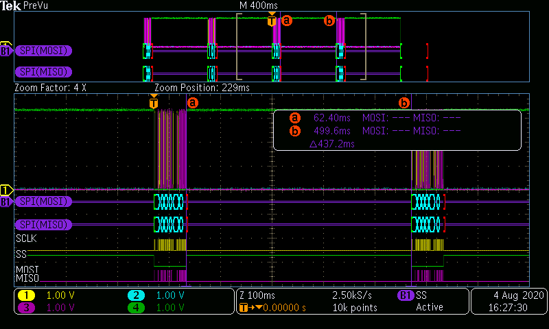

    As you suggested we tried with only one measurement first and with this we also removed reset command.
    so after that our code sequence in MCU is fix as per below lines
    • Power on MCU
    • Delay of 1 mSec
    • Configure ADS114S08 for Channel 1 (AIN0+ & AIN1-) Measurement
    • Delay of 3 mSec
    • Read Channel 1 data using RDATA command
    This sequence is implemented in 500ms timer ISR.
    we observe that variation in channel 1 input voltage value from 6.048 to 6.921 mV where the thermal block is stable at 150˚C.
    Second as per your suggestion we removed pull-up/pull-down from measurement channel 1 and used internal V bias voltage of (AVDD + AVSS) / 2.
    Note that we applied V bias voltage on AIN1- as you mention in older comments.
    but when we used internal V bias of ADS114S08 we got random data. And after some time all data reset to 0. When this situation occurs we measured voltage between REFOUT and REFCOM and it found to be zero. please explain this condition in brief
    Whenever we apply earth connection to thermocouple sheath at that time all communication reset to zero and measurement voltage between REFOUT and REFCOM is zero.

    Let me introduce you to our isolated power supply system.
    We have 230VAC to 24VDC transformer based isolated SMPS supply (external connection).
    In our product we are giving 24VDC input voltage where we are using 24VDC to 5VDC Isolated DC-DC converter.
    Most of the control circuits are working on 3.3VDC so we used LDO for 5VDC to 3.3VDC conversion.
    Converted 3.3VDC is given to MCU and ADS114S08.
    Please find attached image on WHOLE SYSTEM.JPG where you can find at which point earth connections are given or not.
    I can say that in our product no earth connection is given and all supplies are isolated from earth so if thermocouple body is connected to earth or not should not create any problem in results.
    correct me if I am wrong here.

    Continuing our conversation, what we have tried is if we use RESET command than data from ADS for that particular instance and there on remains ok but when we change channel or read CJC than again data is zero from IC. Than we have manually reset hardware PIN (RESET) to get data
    As per mentioned in ADS114S08 datasheet, to use RESET command we must tie RESET pin to IOVDD, after connecting RESET to IOVDD ADS114S08 remains in RESET.
    Here we are configuring ADS114S08 using WREG command and after that we reading back those register for verification but we are getting zero value in all register.
    We check this with Logic analyser our WREG and RREG command is working fine that you can verify from attachment files (MISO and MOSI).
    We have kept 1 M resistor value. You can see in excel sheet that it is within PGA Range.
    As you have suggested PDF "A Basic Guide to Thermocouple Measurements" we have gone through it.
    - In chapter-2 (Thermocouple Measurement Circuits), we found one useful circuit regarding our requirement that is on Page-21 titled "2.4 Thermocouple Measurement With VBIAS For Sensor Biasing and BOCS"
    With this we also followed steps as per mentioned in 2.4.5 Generic Register settings, that you can verify from our attached MISO and MOSI image.
    After doing all this we are getting zero value for all configured register.
    Our program flow is as follow:
    1) Turn ON MCU power supply
    2) Configure SPI in mode-1 with 16 bit communication mode
    3) Due to Power ON RESET occurrence we are sending the START command and give 5 ms delay
    4) After that we configure ADS114S08 (please check waveform)
    5) Conversion delay of 5ms
    6) Sending RDATA command for data reading
    7) Wait for 1ms
    8) Read back all register for verification
    This Step 1 to 8 are implemented in 500ms timer ISR.
    Also attached some more image for your clarification.
    Where you can find different delay times between consecutive evens with reference to voltage levels.
    We can change hardware and software settings as per your suggestion. Also we can arrange video call for more clarity on the said subject.

    Here Voltage measurement of TC+(AINO) to AVSS and TC-(AIN1) to AVSS when we connected earth to thermal block,
    TC+(AIN0) to AVSS = -0.51 mV
    TC-(AIN1) to AVSS = -6.94 mV
    TC+ to TC- = 6.43 mV
    Here Voltage measurement of TC+(AINO) to AVSS and TC-(AIN1) to AVSS when we did not connect earth to thermal block,
    TC+(AIN0) to AVSS = 0.8204 V
    TC-(AIN1) to AVSS =0.8140 V
    TC+ to TC- = 6.46 V
    As you can see we are getting data for ungrounded thermocouple at any time even if we are sending commands after RDATA command instead of NOP commands.
    Can you just give us brief details for your comment to use NOP instead of commmands after RDATA command? Because for ungrounded thermocouples those instructions are working ok and for grounded thermocouple we are getting issue.
    We still did not getting proper reason why the ADS114S08 is not giving proper result for all types of thermocouple even if we made all connections as per datasheet suggestions.
    If any changes required at hardware side than please inform us for same.

  • Hi Jehan,
    I think that you misunderstood what I was saying about commands.  First I was not talking about the RDATA command, but rather the RREG command.  You should not send additional commands until the first command sent has completed the transaction.  In my previous post I showed you that the RREG command requested was to send 10 bytes of register data starting at register 1.  Instead of sending NOPs while reading the register data, new commands were issued to inadvertently disrupt the register read.  In fact two commands were sent to reset the ADS114S08.  This probably broke the communication at that point so no new communication was possible until CS went high or a pin RESET triggered a reset to the device.  You need to be very careful when sending commands to the ADS114S08.  This has nothing to do with grounding or ungrounding the TC.
    The device settings being used is PGA enabled using a gain of 32.  Many posts back I told you that I suspected that the grounding of the TC was affecting the input voltage relative to AVSS (AGND) and placing the input outside of the measurement range.  With the PGA enabled using a gain of 32 the input voltage must be between  (AVSS + 0.15 + 15.5|Vinmax|) and (AVDD - 0.15 - 15.5|Vinmax|).  We do not need to worry about the upper limit, however the lower limit is well outside the input range.   The following shows my original concern regarding the measurements:
    "Here Voltage measurement of TC+(AINO) to AVSS and TC-(AIN1) to AVSS when we connected earth to thermal block,
    TC+(AIN0) to AVSS = -0.51 mV [Bob]  If we take Vinmax to be the TC voltage of 6.44mV, then the TC inputs must be above 0 + 0.15 + 15.5|.00644| = 250mV so you are outside of the measurement range of the PGA.
    TC+(AIN0) to AVSS = 0.8204 V [Bob] These voltages are above 250mV and you should be able to measure these inputs.
    TC+ to TC- = 6.46 V"
    I would check and see if you can measure the earth grounded inputs with the PGA disabled at a gain of 1.  Based on the data you just provided, the input is being shorted to AGND = earth ground.  This can be converted, but you cannot enable the PGA and use gain unless you use bipolar supplies to set AVSS below earth ground.
    Bob B

    Sorry we did not mentioned how we are connecting RTD 3-Wire and Thermocouple to ADS114S08 analog inputs. At a time there is only one Temperature sensor is connected either RTD 3-Wire or Thermocouple.
    For RTD 3-wire, AINO for 1mA excitation current for RTD 3-wire, A wire is connected to AIN1, B wire is connected to AIN2 and b wire is connected to AIN8. Reference Network is connected at AIN8. This connection is for RTD 3-wire with low side reference.
    For Thermocouple, TC+ is connected to AIN1 and TC- is connected to AIN2.
    Please confirm our given configuration sets are ok or not?

  • Hi Jehan,
    For the RTD measurement there is a complete path where the RTD input is correctly biased to the PGA input range.  For the TC there is considerable gain being used which restricts the input range even further.  If you connect the TC to AIN1 and AIN2, then there must be some method used to bias the voltage to the input range of the PGA.  You cannot leave the TC float as the TC can float outside of the PGA input range.  You can either use pull-up and pull-down resistors or you can use VBIAS. Pull-up and pull-down resistors would probably cause an issue with the RTD measurement unless you use jumpers or switches to disconnect the resistors from the circuit when not using a TC.
    Bob B
