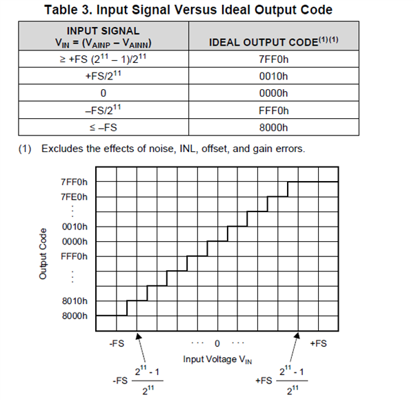

    The ADC output is 12 bits and the conversion register is 16 bits wide. The last four bits are zeros and you would use the 12 most significant bits as the data conversion. The data is also put into two's complement notation so that negative values are represented.
    This is how I would calculate values. If the value is greater than 2^11 or 7FF, then the value is negative and I would start by subtracting 0x1000 from the 12 bit number. Then I would multiply by the positive full scale range and then divide this by 2^11.
    In your example of 0xF48, this is number is -184
    So the conversion value is -184*2.048/2^11 = -0.184V

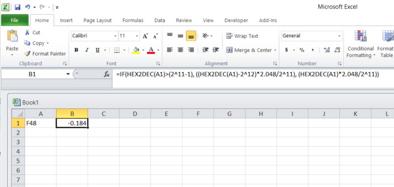

    You can do this in excel:
    Put this into B2:
    =IF(HEX2DEC(A1)>(2^11-1), ((HEX2DEC(A1)-2^12)*2.048/2^11), (HEX2DEC(A1)*2.048/2^11))
    Then put F48 into A1. You should be able to make all the conversions you need by changing the contents of A1.
