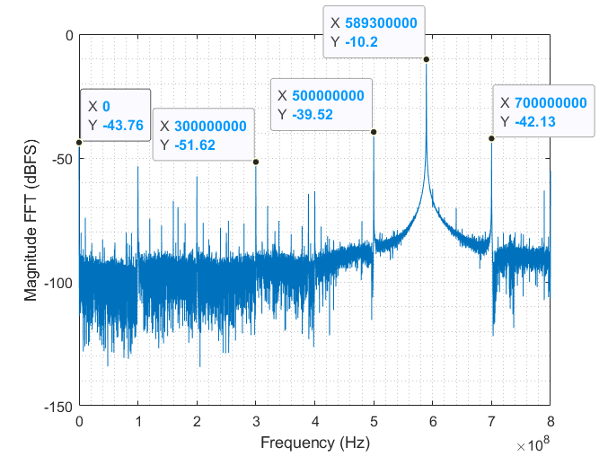

  • Hi Neeraj,
    1. the signal input to ADC1 is around 0V from signal generator.
    2. please see attached FFT as example.
    3. is JMODE2, K = 4 at 1600MHz sampling clock (device clock).

  • Hi New2day,
    1. Your ADC clock signal and Input signal should be coherent with each and frequency locked with each other or you can use windowing and your spectrum will look as expected.
    2. From the figure of the FFT your capture looks fine. You don't have to turn off the periodic sysref to the ADC. BTW : the ADC will still capture without the sysref.
    Neeraj

  • Hi new2day,
    1. Yes you will need to sync the signal generator with clock source and then choose a input frequency which is coherent.

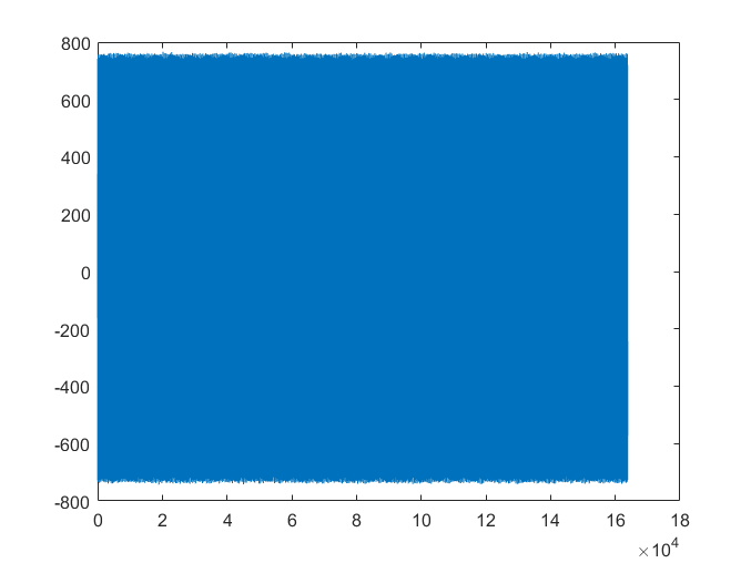

    Can you send a time domain plot of the signal and also send the FFT of the signal without the analog signal applied to it. that will show me how the noise floor looks like.
    Neeraj

    4. Please see attached time domain (ADC1) and noise floor on ADC2.
    Thank you.
  • Hi new2day.
    You don't have to use coherent frequency. I suggested that you use coherent frequency because you were seeing the skirt around your fundamental frequency as I mentioned before you are seeing the skirt because your input signal and clock signal or reference signal to PLL which generates the clock signal is not coherent. There are two way you can get rid of the skirt
    1. Use coherent frequency: again ref clock and Ain should be frequency lock with each other and you will need input a frequency which is bin centered which can be calculated based on following formula.
    Fs – the sampling frequency of the ADC.
    N – the number of points in the FFT. N must be a number that can be represented with a power of 2, such as 1,024, 2,048 or 4,096.
    Fin – the analog input frequency.
    RBW = Fs/N; bin number = Fin/RBW; Coherent Fin = round(bin number) X RBW.
    2.  Second method is use windowing: if you use windowing you don't need to enter coherent frequency. Your spectrum will look fine.
    Yes coherent frequency can be any frequency.
    The FFT looks good. If you are seeing higher than usual harmonics please make sure you are filtering the Analog input signal with a bandpass filter before passing it to ADC.  Calibrating the ADC might help with as well,
    Neeraj
  • Hi Neeraj,
    As you mentioned, we went through the MATLAB code again and found a error.
    The FFT plots look much better and no more wide skirt etc. There is Fs/8 spur at ~ - 53dBc ~-58dBc depending on the input signal level.
    I think we need to tune some register settings.
    Any suggestions? Thank you.
