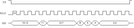

  • Let me try attaching the image again.

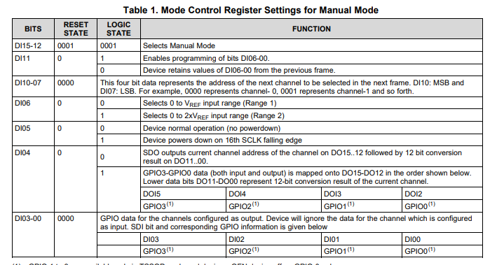

    In manual mode, the user tells the device what channel to sample next, by building a 2 byte command based on the content of table 1 in the datasheet, also shown below.
    Now, let's say we want to use manual mode, and sample channel 3, using the full scale range of 2*VREF
    Based on the table and the timing diagram further below, we can create the 2 byte command to do this
    The binary command would be:
                              0001                 1                 0011                     1      0        0                  0000
    Remember that this device has a three frame delay, thus two more frames (consisting of 16 SCLK) are needed to get the output data for channel 3. The SDI content of these frames can be all 0's, in this case the device will continue to sample channel 3.
    I suggest using a known DC input to compare the output data to the expected data.  Note that the output data will be made up for the four first bits display channel address, in this case channel 3 (0011b) followed by th 12 bit conversion data

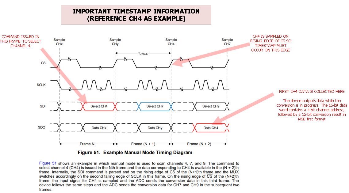

    2) below is a markup of the datasheet timing diagram showing an example of the 2 frame delay and the "exact moment" we should timestamp the capture by the ADC of the sample which as i understand is on the rising edge of the CS in the following frame. can you please look at the image and confirm if this is correct?

    SDI changes state on the falling edge of SCLK, and SDO data should be read on the rising edge of SCLK. I would also suggest having SCLK low at CS falling edge. CPHA = 0, CPOL=0
    2. The input value converted is the voltage at the FALLING edge of CS. Since i cannot see the image, I am not sure if this was a type-o or a misunderstanding of the datasheet. you should timestamp it with the falling edge of CS. This would then correspond with the output two frames later.

  • Tom,
    I see the image.
    the information you extrapolated from the image is correct.
    As for when to time stamp, this is up to you.
    During the rising edge of CS the  input is being samples, the acquisition phase has begun and is ongoing during this time. the falling edge of CS is when the acquisition phase end, the input measured at this point (settled or not, one way to think of it) is what gets converted.

  • Hi Cynthia, i would consider my timestamp to be at the point where acquisition ends and conversion begins.
    could you please mark on the timing diagram where this is?
    from your explanation, it sounds like that would be on the other side (falling edge) of the CS that i marked as being the rising edge. but that doesnt seem right since conversion takes 16 clks which puts you at the end of frame N+2 before data is ready.
    if i understand for this diagram (fig 51), the mux channel isnt selected until 2nd clk of frame N+1. that suggests acquisition time and conversion time all have to occur in frame N+1 between the 2nd clk and end of frame N+1 for data to be clocked out in frame N+2. is it possible data for manual mode isnt actually clocked out until frame N+3?
  • This would be at the falling of CS.
    The datasheet, in the excerpt you pointed out is simplifying the process to explain the modes of the device. The timing diagram, figure 1, has a detailed timing diagram and section 8.1 details out the conversion cycle of the device.
    The conversion data is outputted as it is being done, which is why it can be at the falling edge.
    Frame N: sdi data is analyzed
    Frame N+1: sdi data is executed, meaning MUX channel is changed to desired input from frame n
    Frame N+2: conversion data is converted and output, from channel desired in Frame N. to refer to the timing diagram, say Frame N=1 is Frame +2 in this example. the t aqc starts in the previous frame, and ends at CS of the beginning frame where the conversion data will computed and outputted.
