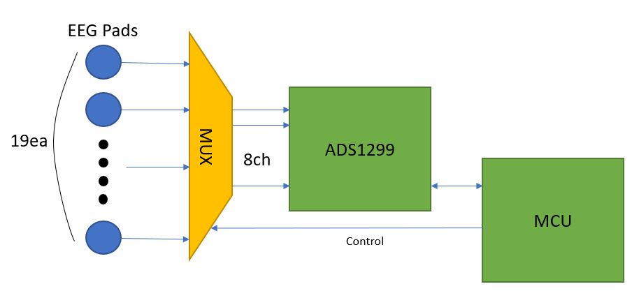

    2. It is a portable application. Therefore, the PCB size is limited. i want to use only ADC 1point by using Mux(2~3ea) like the block below.
    Do you have a mux to recommend?

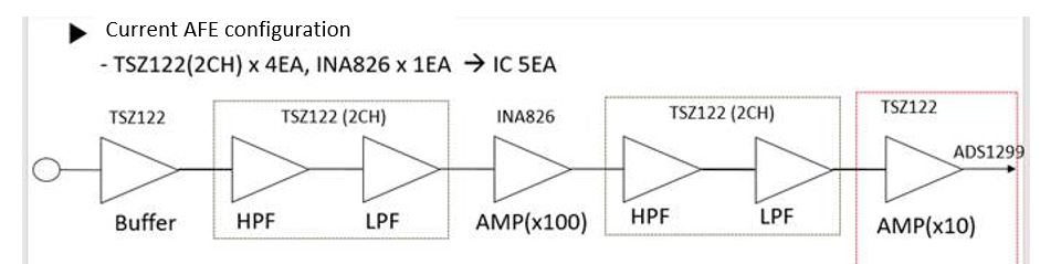

    3. Currently, AEF is designed as the following block. Please give me an idea to reduce the socket.
