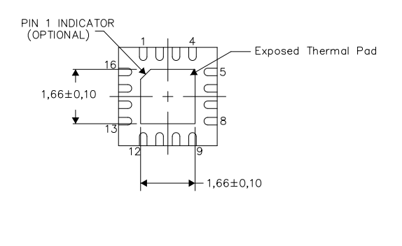

3. What's the dimension for the thermal pad? It's not in datasheet.

    3. thanks for pointing that out, I will bring this up. The package information is available in the catalog version of the device ADS7038 datasheet
